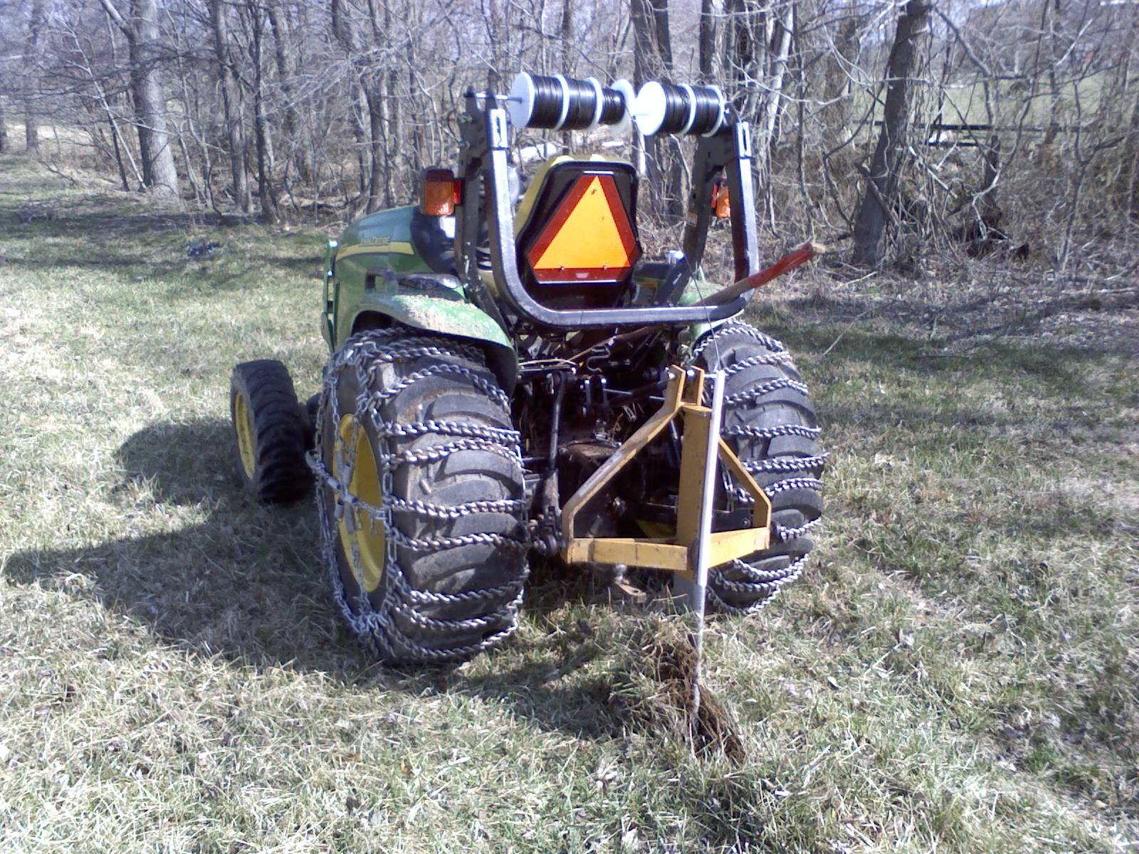

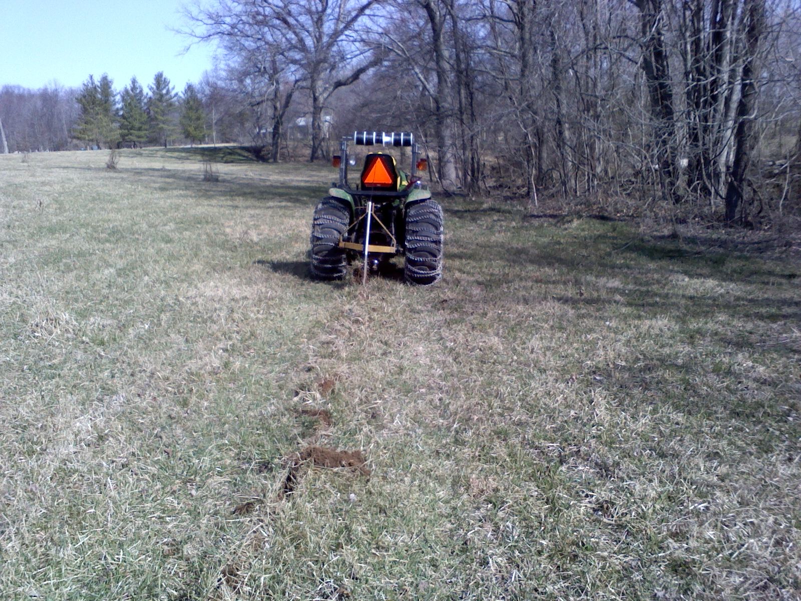

Finally had a nice weekend to get the invisible dog fence in the ground and installed 3200' of wire around 10 acres.
My home made cable installer worked great consisting of a JD 3520, a subsoiler, piece of 1/2 pvc with a 90 degree elbow and some duct tape. Only places I had issues were close to trees when I was getting into the roots which messed up the turf or they were just too big to pull through and had to manually bury wire in few spots.

Good setup.
I would have made at least one initial pass to find the roots (and rocks in my case) before making the final pass with the wire.

Sounds interesting! Could you post a closer picture of your design?

I did something similar to pull sprinkle lines. I welded a chain to it with a steel 1" female cap. Then you can buy the steel 1" to various flex line sizes to connect the pipe with clamps. I also welded a steel pipe to it and hung 45lb plates on it for down force. You can add what you need for your soil type and if will still lift up if you hit a rock. Worked great.

All of these ideas are great, but it would be nice to see pictures of your digger with the lay down attachment.

I made a plow for my 2210 and installed my dog fence. Basically a light weight subsoiler with a feed tube. Built from scrap I had laying around.
