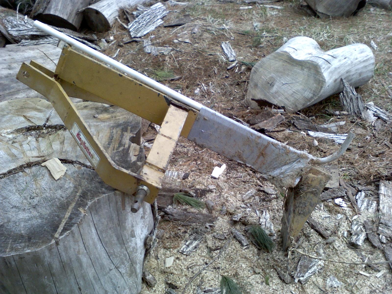

Here is a close up of my installer.
I used duct tape to attach a 1/2 pvc and 90 curved elbow to the back of my old king kutter subsoiler. When I started I had a flag attached at about the 6" deep mark. I visually used the flag to get a good depth and then set the adjustable tab on my three point control and was good to go. It was in need of a little duct tape repair by the time I was done, but it got the job done.
Very nice, I have a guest house out back and I would like to run cable and internet down there eventually. This seems like the perfect solution, a subsoiler is about $150 at TSC, and I can probably improve on your design by using Gorilla tape instead of duct tape.
