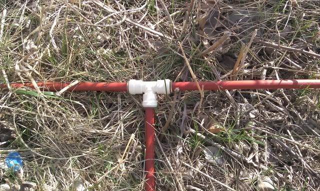

I made a plow for my 2210 and installed my dog fence. Basically a light weight subsoiler with a feed tube. Built from scrap I had laying around.

We finished installing just under 2000 feet of wire using the innotek 4100 system about 3 weeks ago. We buried the wire where it was crossed the yard, driveway, etc. Everything that was inside the tree line was left above ground. I ran the entire perimeter inside 1/2" pex waterline. Cost me an extra $400 but the wire is protected and waterproofed so it should last a lifetime. No worries about broken wires.

I would have gone with the invisible fence brand but figured 2000 feet of install would be too much. Everything including the extra cost of the pex tubing cost me about $700. Took some work on my part to install myself and train the dogs but was worth the savings. FYI - Innotek (petsafe) and invisible fence brand are owned by the same company, Radio Systems Inc.
