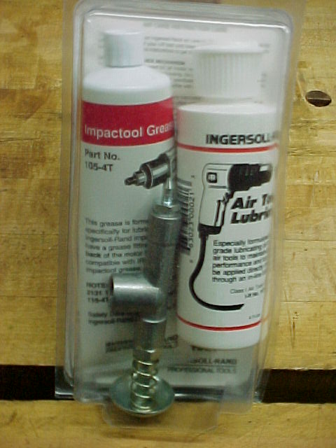

I did finally find the kind of grease gun I used all the time for that purpose; not a very good picture but better than nothing at this site. You just stick that needle nose into that dimple then press the plunger with your thumb.

snapper,
IR calls this their "Impact Wrench Air Care Kit", part no. 105-LBK1.
My wrench was an eBay purchase from an individual. It was new, but no documentation (a door prize won by a guy who couldn't use it). I called IR customer service. They were very nice. I explained the situation. They sent a warranty card, owners manual and the wrench care kit....free! I expect any IR vendor could also order one for you.
OkieG
P.S.-I just looked at Bird's link and see that kit is similar to the one I have pictured. As Bird's link suggests, 115-LBK1 is for the 2131 series of air wrench. The 105- part no. above would work with your tool.
OkieG

Thanks for pointing that out, OkieG. I just wasn't paying attention since I was only looking for some picture of the type of grease gun I used. What is shown in the picture is exactly what I used, but what is not shown is the little cannister it's attached to. And if anyone doesn't already know it, the little grease fitting on the IR2131 and IR2112 (I've never seen an IR2141 yet) is on the side of the front housing instead of the rear. The rotors in those models are not hollow; no grease goes to the bearings because they're sealed bearings. And Ingersoll-Rand uses a different colored grease in them than they put in the other models (don't ask me why 'cause I don't know what the difference is).
