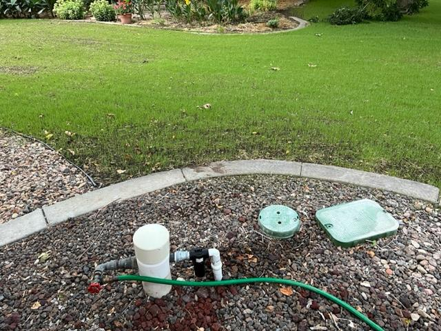

Every situation is different but I've done the above with a submersible pump with a timer on the relay and no pressure tank or pump house for almost fifty years now. This in Kansas where it can get down to minus 20F. Finally added a wifi controller last year along with six solenoid valves for zoned lawn irrigation but still no pressure tank. Can attach a hose to bibs at a couple locations and still run manually with the timer.

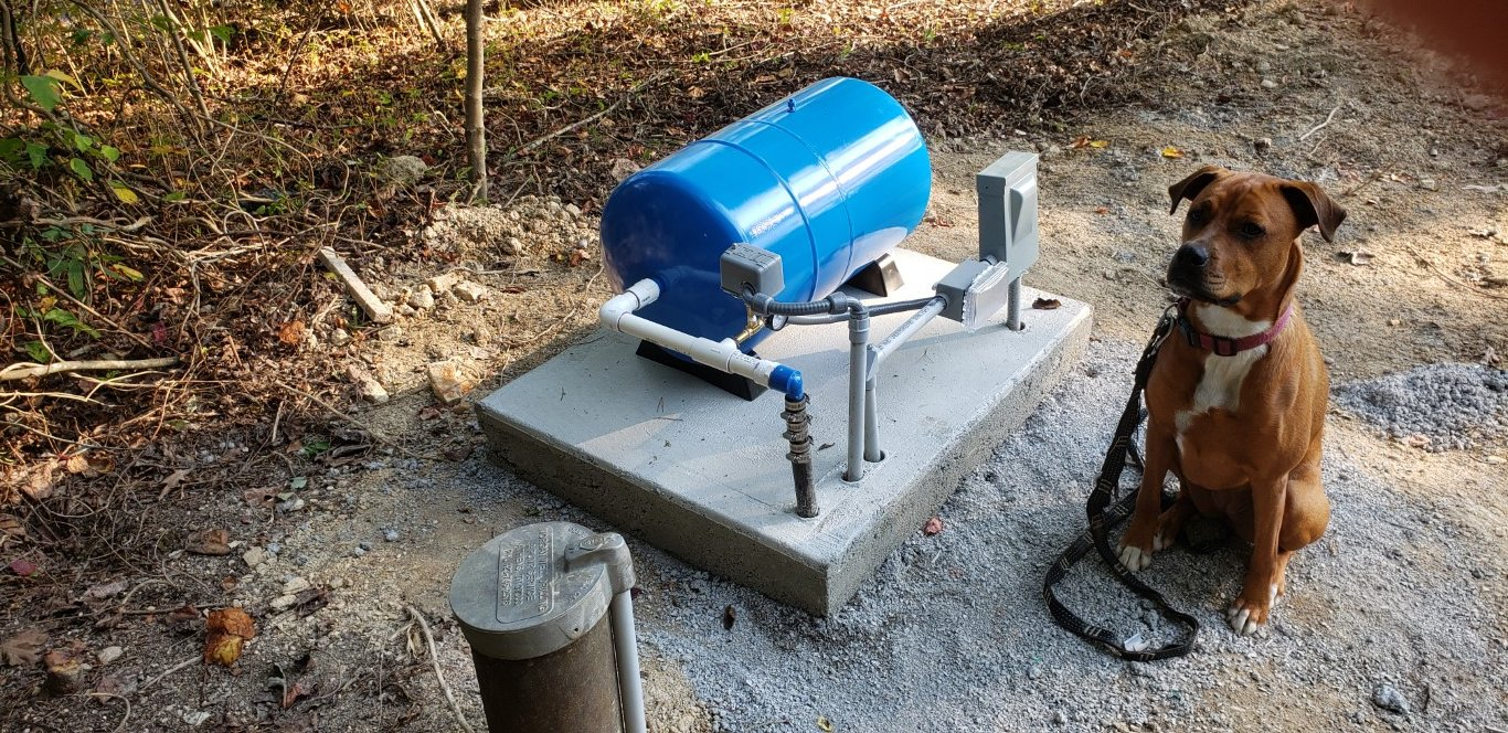

Update: Got everything done but an insulated house of some kind. I went with a horizontal tank as it makes the house smaller. The service disconnect is a bit redundant as the power pole is 25 ft away and in sight. But, I needed a J-box anyway to split out the 120V utility circuit. The utility circuit continues on as #12 UF 175 ft to the edge of my pond for a future aerator. I made all connections go through the slab so the insulated building could just lift off without any encumbrances.
