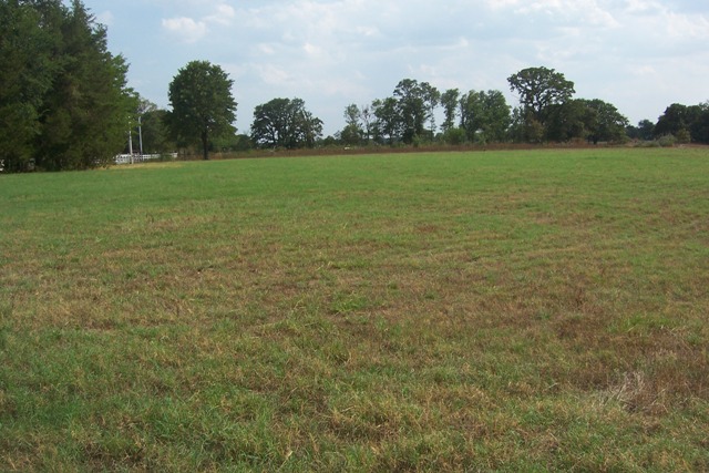

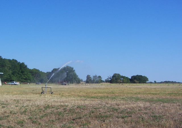

#25
Here's a couple of pictures ... before and after a little water. Next is fertilizer and Grayzon.
Are you considering getting a soil test before you fertilize? This will ensure that you put on what's needed. You also want to make sure that you have adequate water so that the plants can use that fertilizer. If you have sandy soils, you have to really be careful with water application because you can leach the fertizer through the root zone and into the aquifier. That's not good for the grasss or the aquifier!
For herbicide to work properly, you'll need to make sure the plants are actively growing. Since your're in a pretty droughty situation, it might be more effective to use the herbicide in the Spring.

#30
I do have the soil sample and have the same concerns that you share. Have you used any liquid fertilizer?
There are areas that have shot up some weeds, I quess from the water. I'm considering spot spraying ...I hate a weed.
The only good weed is a dead weed! You can never truly get rid of them in any cost effective mann er once you have them but you can manage them. We get most of ours from the irrigation water and as a consequence my wife can't use that water for her organic garden. It also prevents us from being organic so we have to market our beef as "Narural Beef".
I haven't used liquid fertilizer but the folks around here that use pivots utilize it in the pivot water. They use a plastic tank to hold the fertilizer and there is a metering pump that injects it into the the water at a prescribed rate.
