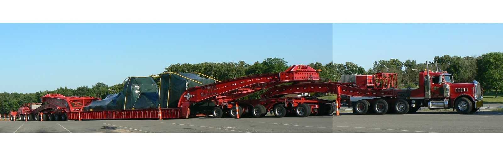

I saw a truck and trailer rig at a rest stop this past weekend that I'm sure everyone would agree was large enough to haul a BX, or any other tractor that's ever been made.:D
It can carry 430,000 lbs and a load 22' wide.:eek: More information here if anyone is interested.
That is just what LB is looking for!!!:D
Would I need a CDL for that if I was just towing my ATV?

Holy friggen' cow! To think, there is one guy at the front of that drinking a coffee and eating a doughnut.
Hope he's not on the cell phone also.
On my way home from work 2 or 3 weeks ago, I saw a truck just like that one sitting overnight at the weight station. The load even looked to be the same. Wonder if they are transporting something across country and it took that long to make it from Ohio to Missouring?
I looked for one of those at the local retail centers to haul my Ford 1100 but they are hard to find. Must be a mid-western thing!!! I even went ahead and got my CDL so I would be ready to go across town to my other lot when it needs mowing once or twice a month. I especially liked the idea of having eight tires on one axle in case I blew a tire hauling my 1200 pound load.
