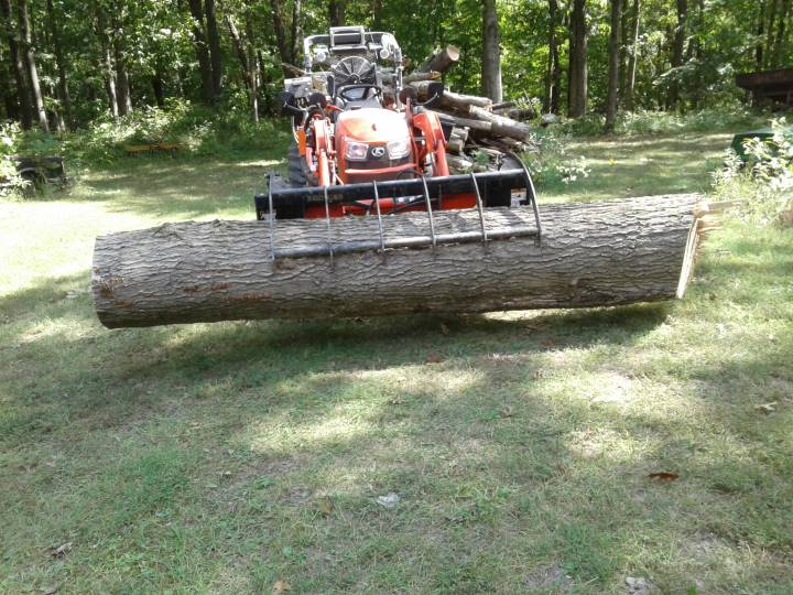

My Kubota BX23S uses a grapple just fine.
it's one of my favourite implements

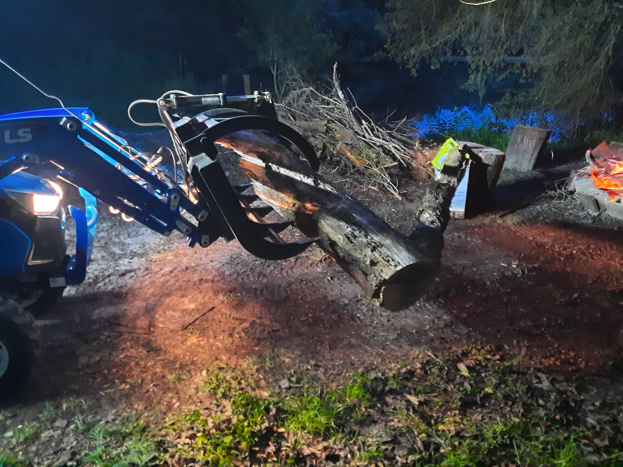

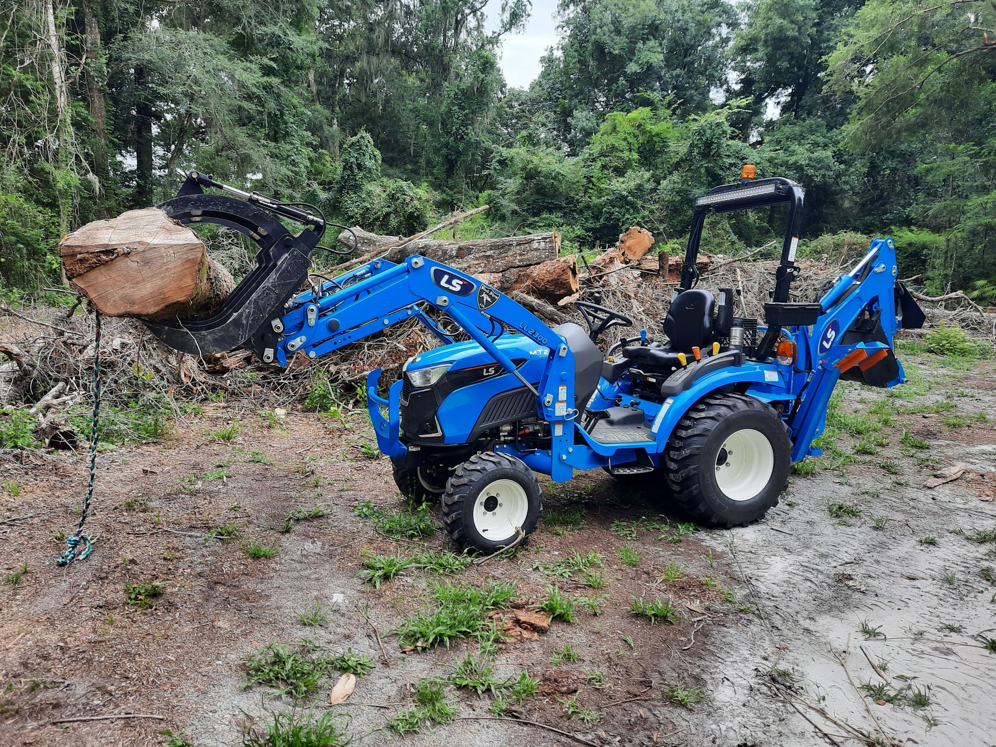

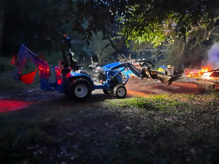

I use my grapple on my LS all the time! I have moved tons and tons of wood & more with it. It help with stumps and so much more.
   / Is a 25 HP tractor too small for a grapple. #16
Grapple, bucket, tree puller, , , , , forks - currently this is the order of preference here. Like above, the grapple has been a game changer regarding moving tons and tons of wood. It's rare that I handle it by hand anymore other than splitting and stacking. People love their forks, but I really struggle to find a use for them that is functional other than pallets. The first time I lifted a log with them, and it tipped up and nearly fell onto the tractor, off they went and the grapple back on. CTA makes a light weight unit that is bullet proof. If you don't have a proper setup though at the moment, keep in mind the potential for later. Save your money for the future tractor - appropriate grapple - 3rd function valve. I made do for many many years. There are ways to move logs and the rest that don't involve hydraulics, but once you've got it, you won't go back.
