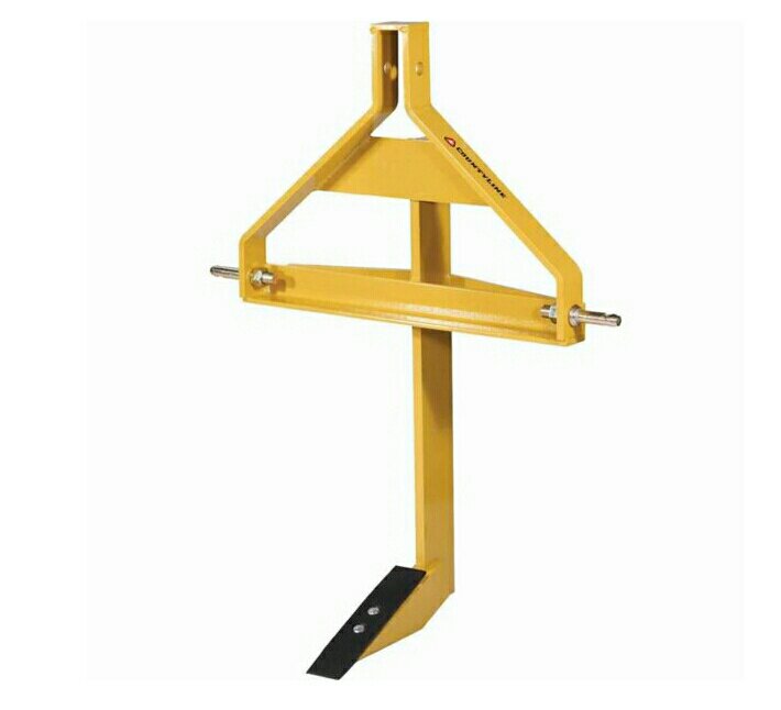

We had cable installed here a few years ago and the installer used a machine similar to a Ventrac with a subsoiler and with a elbowed tube as others have described. He drove slowly as his assistant fed the cable into the tube. He buried the cable about 16" deep. No worries about any tilling or landscaping ever affecting it. I since tilled up and replanted my lawn s I am grateful that it was that deep. I think something like this 3 Point Subsoiler-Subsoiler Attachment | Agri Supply #7341 But you should be able to make your own cable burying gizmo.

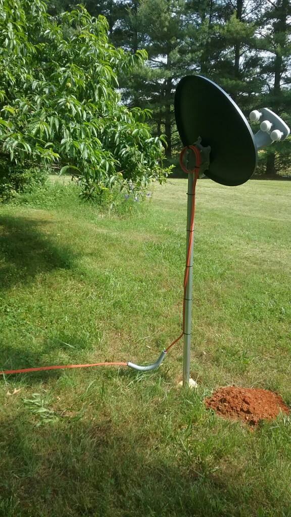

I'm not sure what a 20 inch diameter straight cutter is. Tractor supply has a sub soiler like this. Maybe with bottom plate off it wouldn't make a mess in front yard.
It's for dish antenna. It was on one chimney but oak tree getting so big blocking signal.
They were going to install in middle of yard!
First choice was other chimney which they don't do any more (?). Second was on my power pole which they don't do, so third was 60" away from pole, so I can mow around it, and it's not too visible.

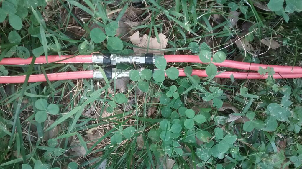

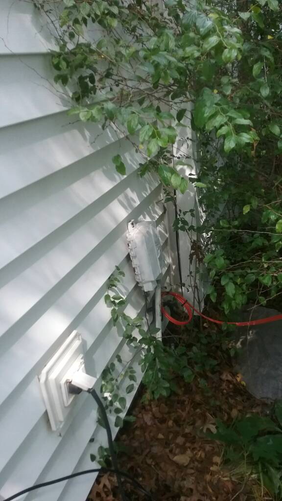

I don't like how they spliced cable...but that's me (I'd use heat shrink tubing that has silicon in it over splices). 20200609_161326.jpg20200609_161648.jpg20200609_161717.jpg20200609_161729.jpg

If you allow the subsoiler to go deeper, the plate wont make any difference. The shank will be the only thing cutting your lawn. Here is a video you might want to watch. YouTube He runs wire out to his well pump.

I don't like how they spliced cable...but that's me (I'd use heat shrink tubing that has silicon in it over splices).View attachment 659091
Get some self vulcanizing tape and wrap it up, trust me, if you clean it really well, wrap it tight, you will never have an issue with moisture or corrosion.
