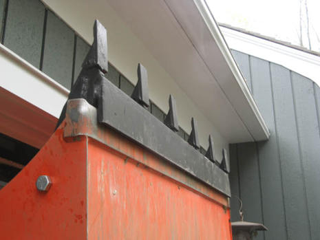

I bought the W.R. Long flat tooth bar. This design allows back grading.
Deano
Yes that design would work, maybe I'll modify mine to that configuration by adding a bottom flat plate. (mine is home made).
AS someone else mentioned, backgrading with the heel also works but that wears down the bottom of the bucket which is not hardened as the cutting edge is.
Hence my comment of adding an angle or some other wear element to the heel of my bucket.
My soil is heavily rock imbedded and as well I often backgrade my gravel drives.
