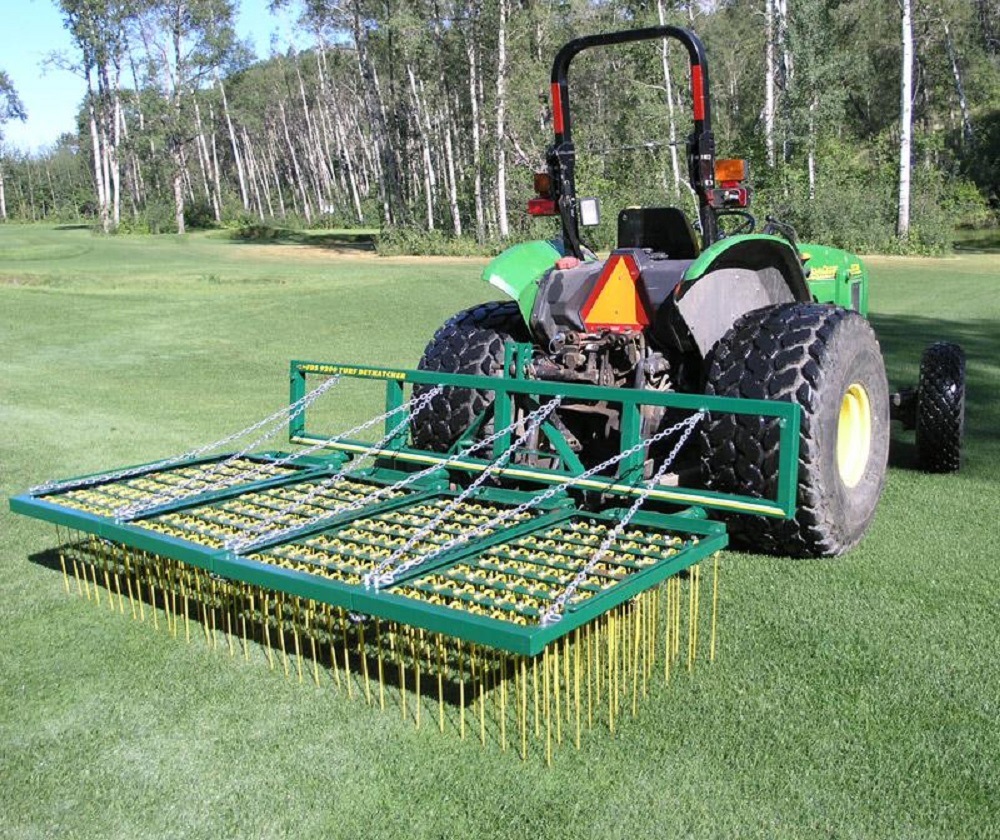

I'm going to build something for commercial use to "dethatch" and tear the ground a bit for better seed to soil contact for grass seeding. This would be patches of existing grass under trees where I'm not comfortable with more aggressive equipment that might damage tree roots. I need stronger and more durable tines than baler tines and will use tedder tines or maybe even the 3/8" tines used on some harrows and such. The implement will be roughly 8' wide to cover my tracks so one tine every inch in the plan. It will work and I've made and seen similar ideas in the past.
Here's an extreme example and what I have in mind but only three bars and less tines.

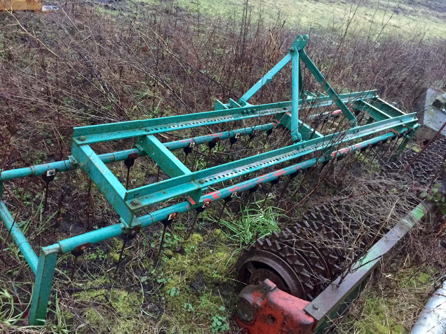

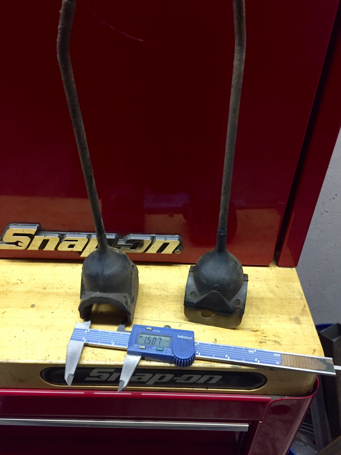

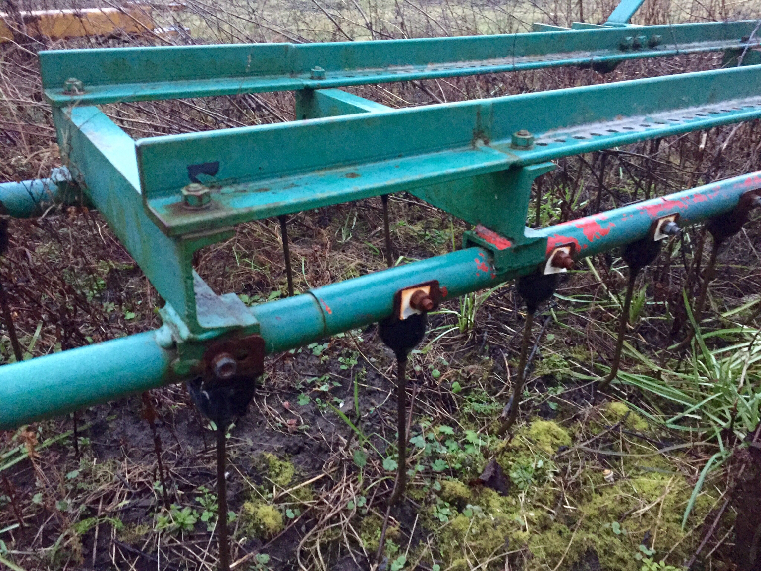

sixdogs, now that you've posted a pic of what you intend to do.....
I just went out to take a few pics of MY dethatcher I made over 20 years ago. (Haven't even had my second coffee yet so I didn't feel like diggin' it out of the weeds)
You're welcome to it if you're up to a REAL road trip. :D

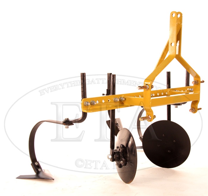

Have you thought about calling up Everything Attachments? It looks like there's a piece on this bedder that could work for you (not sure if it's long enough). They may just sell you the piece of steel you need (as a spare part).

The EA piece is an example of why I think punched angle iron in 3/8" or 1/4" is commercially available. They aren't going to take the time to punch those holes nor do they likely have the inclination to bother. If not available, they might choose a different path of manufacture. I can punch or drill them cheaper than mail ordering others. Cheapest and best would be if someone made it that way. I'm planning on having the holes punched.

What about using a Land Pride Spike Tooth Harrow? Spike Tooth Harrow will give you considerable 'reach' under trees.
LP STH15has one spike for every 1-3/4" of coverage. Note: 10 settings for tine angles.
STH15 Series Spike Tooth Harrows | Land Pride
Of a common Landscape Rake? Landscape Rake will have more ground contact, however you could remove every-other rake tooth.
Or consider a suspended Chain Harrow. The one I assembled has 1/2" chain. For commercial use I would use 3/8" or 1/2" chain. Suspended, you could scuff under trees.
