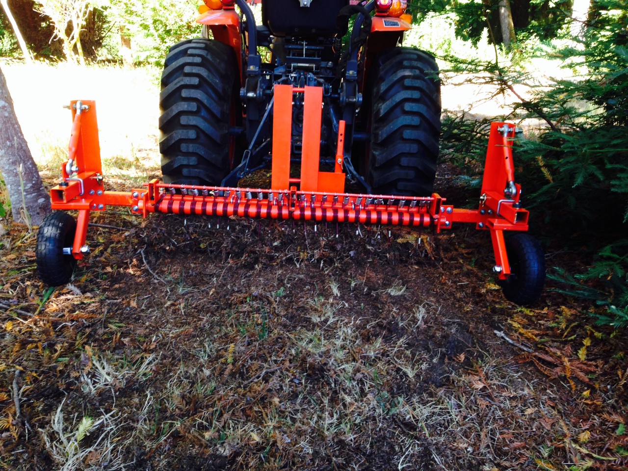

Vibrating tines work because I have seen it. I don't wan to make federal case out of making one but if I can stumble aross some parts and the right tines, I'm going to make one. The storebought one I showed a photo of earlier is almost $5,000 and that is not cost effective for what I want to do with it.

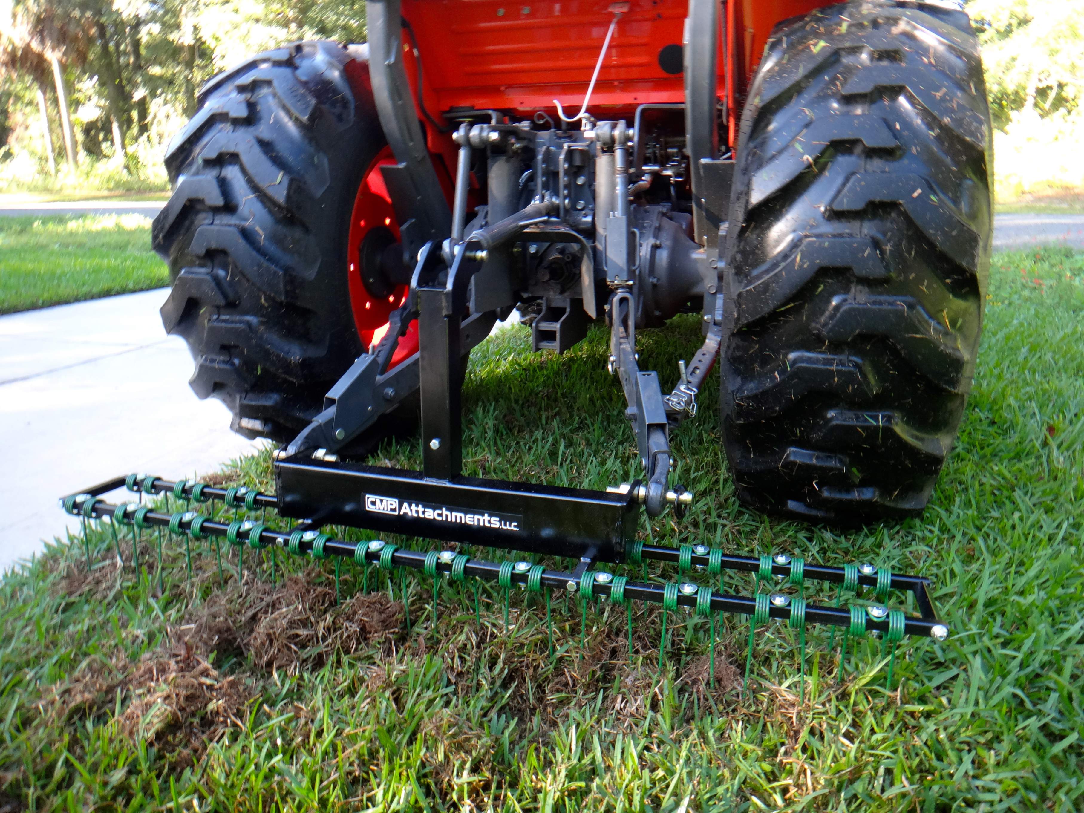

The dethatcher/rake that I made is lighter and smaller than what sixdogs needs. It is designed for my fragile and somewhat clumpy and uneven grass. I needed an implement to rake and dethatch effectively, while not tearing up the grass. It uses hay teeth anchored by springs for a two stage action. It works fine for my purposes, although I also considered using the stronger, longer tines that big barn used. Commercially available rakes are too stiff.

Wow. Very nice job on the rake!!! :)

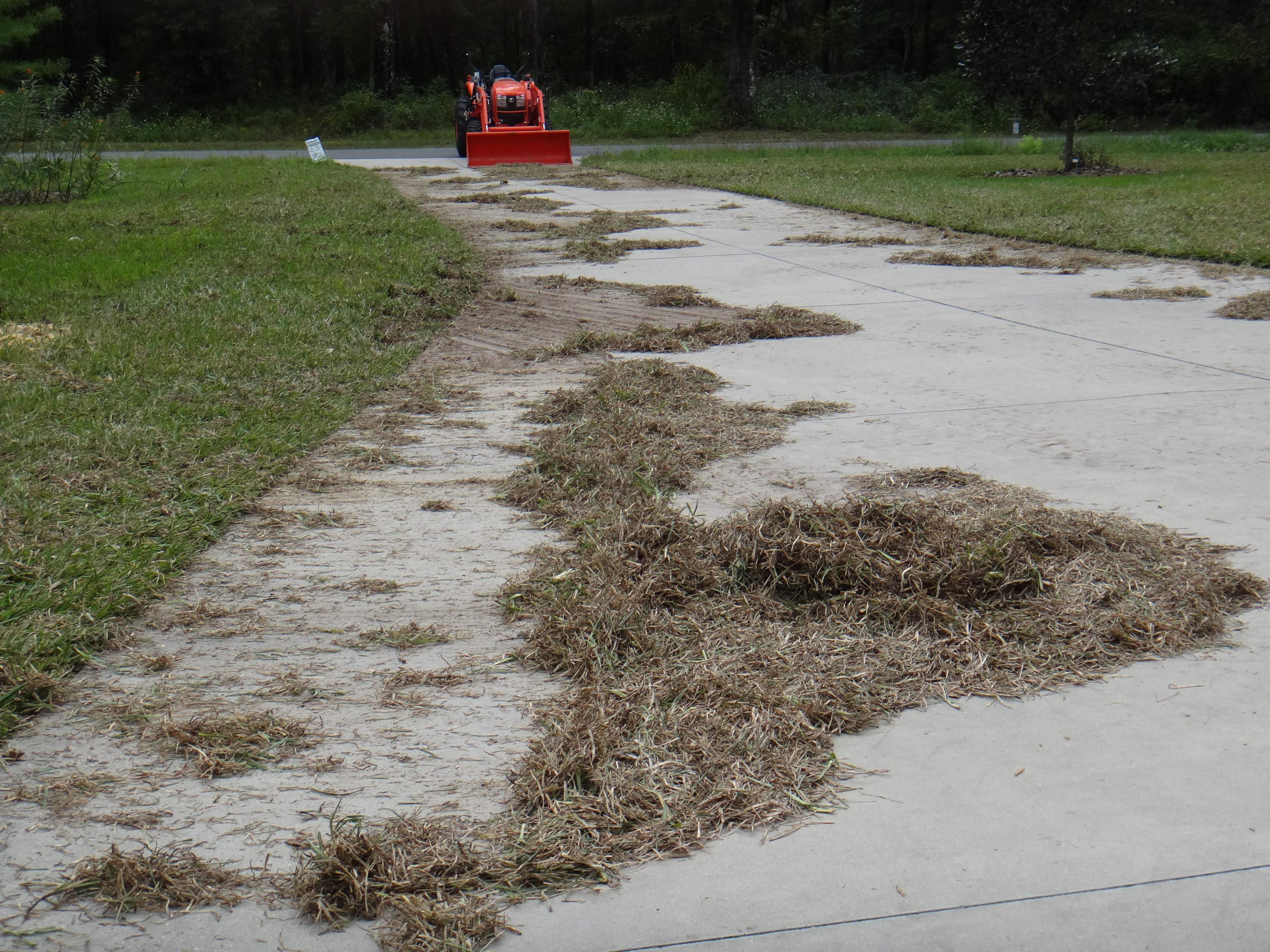

Jeff9366. Good ideas and actually ones I have already planned to steal for other projects...:ashamed: It's neat with the use of square tubing and it solves the problem of drilling in round tubing. While that has hay tines, I need to use tedder tines that are 1/4" or 5/16" thick since I'll be using it very aggressively and it will get hung up on roots and wires and anything I run over. This will allow me to more aggressively rip the ground/thatch/etc in the fall so I can get grass started in places I cannot till or cultivate.
EDIT--Years back I did a thread with pics about using a chain harrow to dethatch a couple acres. I had two heaping pick up beds of grass when I was done and a towering inferno when I burned the pile. Dethatching really improves things.
Here is that thread with the pile of thatch.
http://www.tractorbynet.com/forums/projects/200167-de-thatched-my-lawn-good.html

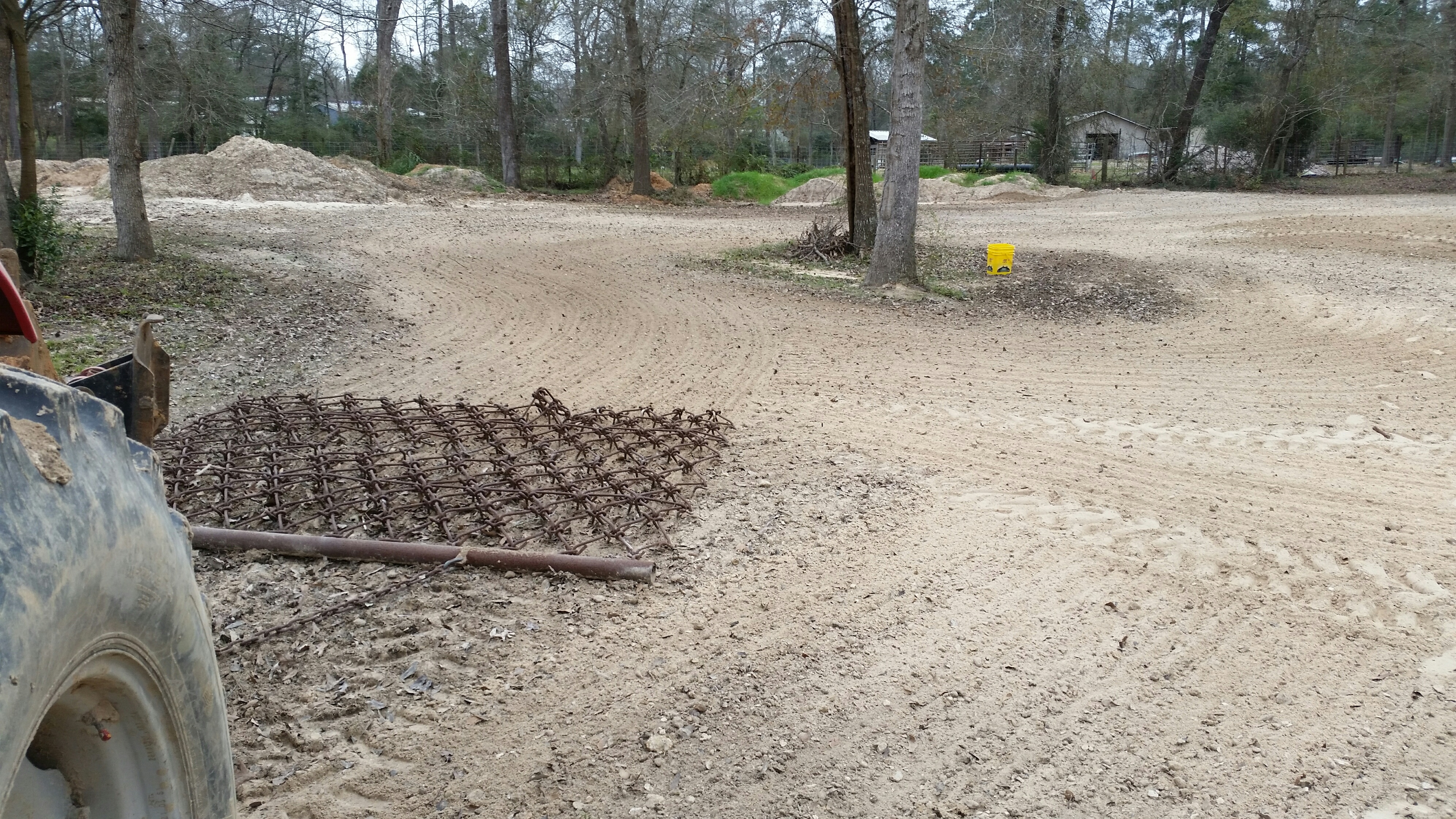

Yep, those drag harrows are awesome. I just drug and planted rye grass seed on the dam and backside today.2-4-17 Drag Harrow Results.jpg2-4-17 Backside Of Dam Drag Harrowed.jpg
