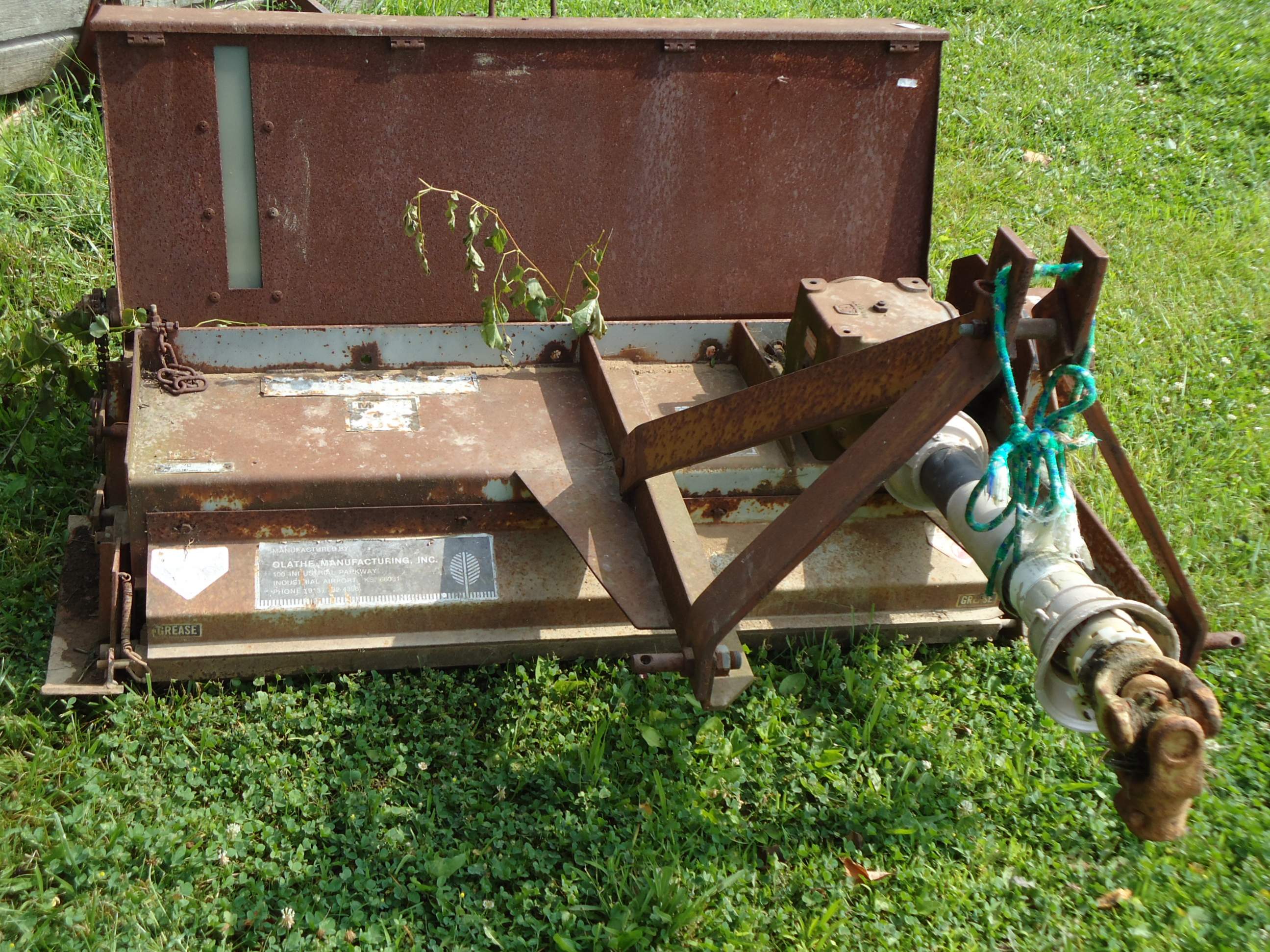

Just thought I'd throw that out there. I had one of the Woods Pulverizer/Seeders, about 15 years ago. It was 15 years old, but brand new. Got it from the Ohio Turnpike Commission. They'd bought it new to do some seeding along the Turnpike. It was one of 4 they had, and never used. Got it reseed the horse pasture, and hay field. The horses had the pasture barbered down pretty good, so figured I'd try it first. I wasn't impressed with the job it did, so never bothered to do the hayfield. They may do well on seeding a new lawn, I don't know.
Later that summer I found this Olathe slit seeder on CL for $100. It's not pretty, but, works great. Even with new drive chain, and a couple bearings, still have less than $150 in it. Great for in the pasture where the horses have it compacted, even better in the hay field. I never really noticed it not seeding in areas with some dips. First time I used it pictured here, I sowed Timothy, and had a great stand. Probably wouldn't notice it, like on a lawn though. None the less, I would choose this over the Woods anytime. I hope that one works out for you.

DJ54..good comments. On the Woods pulverizer seeder, did you have the one with the spiked angled gangs in front , then a second straight spiked roller and then a packer? What happened if you angled the gangs in sharply and did it allow greater scuffing of the ground? I'm beginning to have doubts on the Woods tool for my use.
Maybe I should consider the one with the discs up front, then a spiked roller and then the packer wheels.
Any more pics of that Olathe seeder?

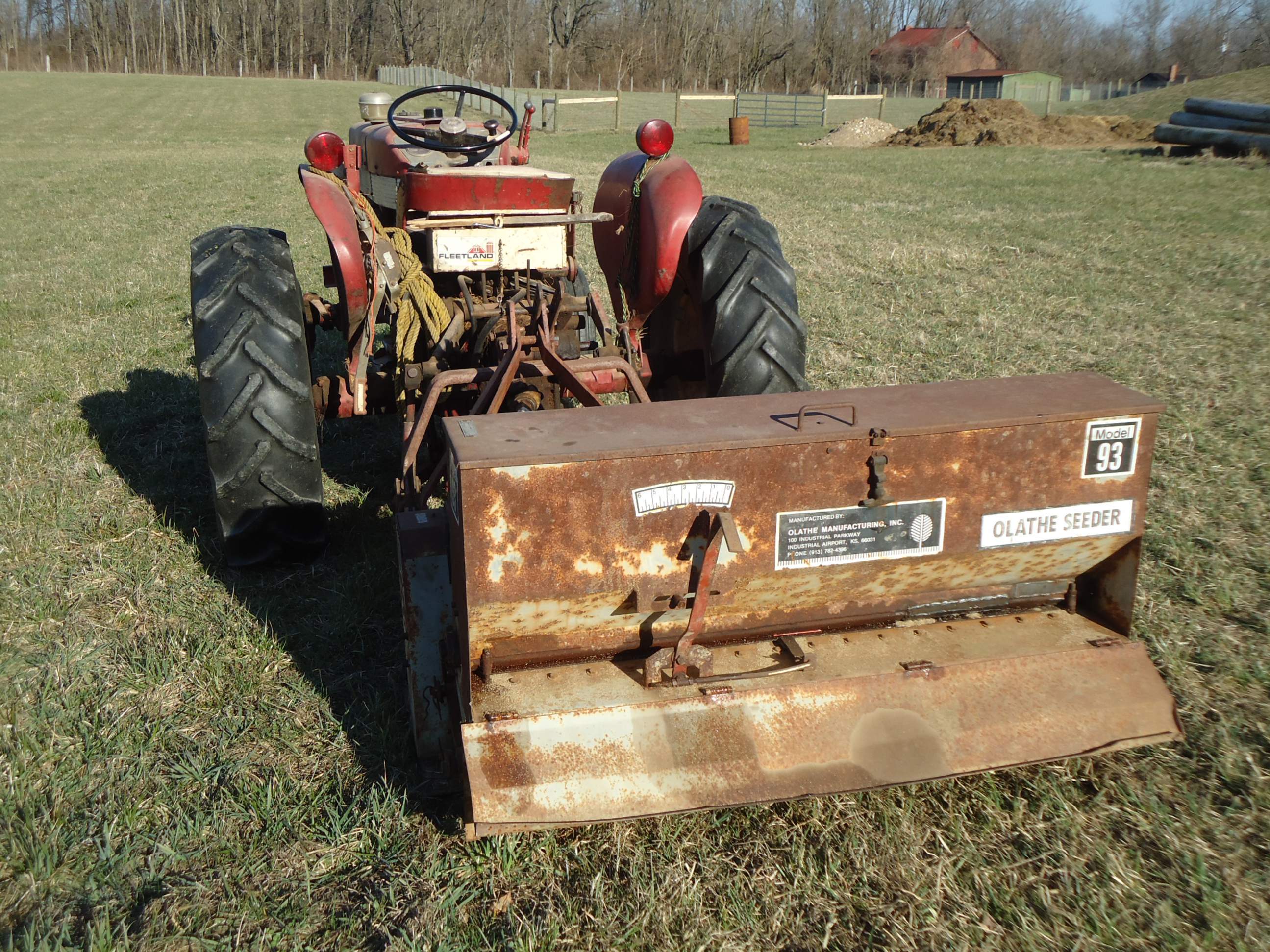

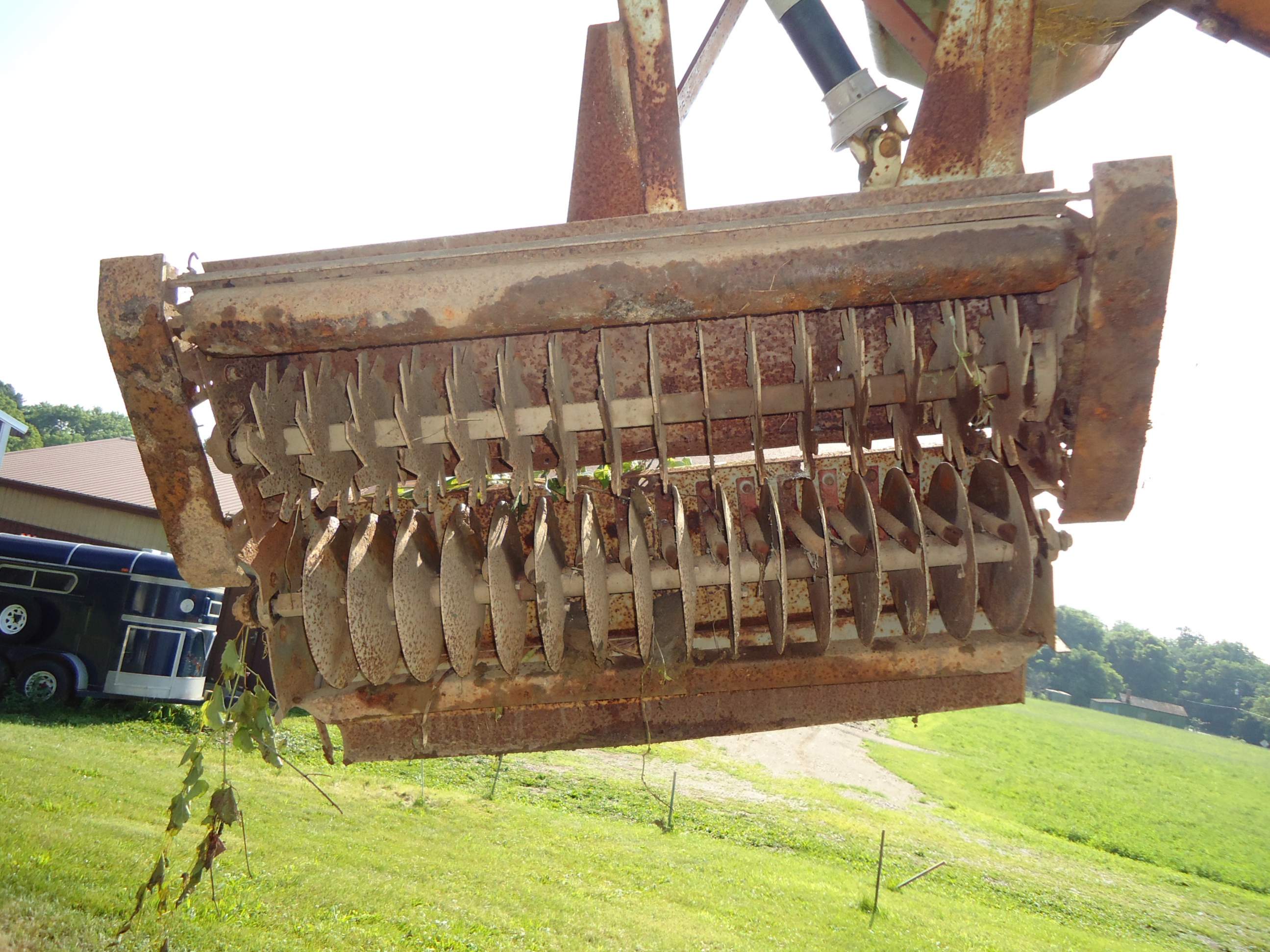

Found a couple more pics of my seeder, saved in my files here. As you can see, the underneath is in pretty decent shape, as far as the slitting knives, drop tubes, and cover disc's. It originally belonged to Pickerington High School. They used it to reseed their football field, until they went with astro turf. The guy I bought it from ,bought it at the school surplus auction, to seed the lawn, for his new house he had built. He never used it in the few years he had it, and it needed to find a new home. The seed box did have a couple holes in it from leaving seed in it, so welded a patch of sheet metal on, to close those spots. The upper part of the box inside, still looks near new, with the seeding rate chart still near new under the lid. It just sat out in the weather for the time they had it. It's in the barn now, and unless there is a catastrophic disaster with it, should last me, the rest of my life.

I had a slit seeder I sold but one with tines like your has would have worked better. Those straight tines are very aggressive at ripping up thatch while mine had the swept back blade that just makes a nice and clean slice in the ground. My use for this would be commercial use and it has to be user friendly and after all the posts am not sure if my original plans will work. Since I see various equipment come up at auction often, maybe I'll just settle back and see what fate brings over the next months or whatever. A golf course going under or school going to astroturf might be the ticket.
You have a desirable slit seeder and should never sell it. For the little use you will give it, it will do an excellent job and will last forever. Thank for the post and info.
EDIT--I might consider using just a small disc harrow with notched blades and then following up with my seeder. I can see where the grass could wind up in the tines. A disc harrow would be fast, clean and trailer well. Still thinking.
