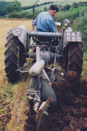

What about one of these? I saw one the other day at an auction but didn't see how much it went for. Kind of half way between a disc and a plough.
Anybody use one? One of the guys there said it would likely be good for cutting through willow roots at his place.
