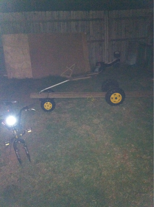

Depends on how heavy the vehicle is, how fast you want it to accelerate (go cart) or how much work you want it to do in a given amount of time (tractor).
6.5 HP is generally plenty for a go cart, but a little light for a tractor.
   / Is it possible to biuld a vehichle out of wood #33
yep.. even a bf avery.. has more. My allis g and a ih cub are around 9-11.. they get a good amount of work done. 6.5 might do it.. albiet slow. I think I would at least go with 10-12hp on a gas lawnmower engine though.. that's just me though. heck.. a chainsaw and power steering pump and some patience would likely do something too.. :)
in any event. i want to see pics.. :)
soundguy
#34
It's a start
