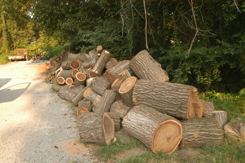

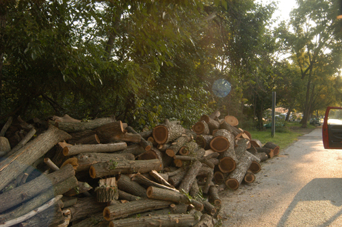

Hi folks and thanks for all the input here. Sorry for the cross thread but I am in a spot with the two neighbors. One owns the shed the other the tree. I am there for the wood and help. I thought the safety thread was where it should be, but I thought some 4110 jd owners could pip in on that thread too. I think after reading the posts here and on the other thread I will stick to standing on the side lines and picking up the wood. I think I can now speak with more authority and tell them I am not comfortable hooking up my tractor to the tree while they cut it and I pull. I think I will say I am concerned about the shed and my well-being. The owner does not want us to move the shed but wants the tree down. Looks like it will come down to taking chunks off one at a time and maybe getting the branches off above the shed and then try to tackle the trunk. Or try to talk the owner of the shed to move it because it would be much safer. I think I can use the idea that he had said it was not setting level and maybe if we move it we could fix that before moving it back.
Plus this might even make a better statement, at lunch today i took a spike and drove it into the tree it is hollow the other trees had black ants in them and were hollow, I am thinking all the more reason to be worried.
I have attached another picture of the wood I have received from the owner of the trees (2) walnuts (2) mulberries, one elm. So this is why I want to be helpful but safe.
Thanks.
Roger
