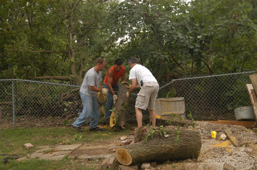

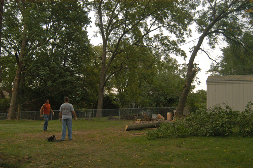

Well the tree is down, not a perfect picture but every one walked away. I stood back a pulled on a rope while we trimmed off one large limb we could reach while standing on the roof of the shed. Then the property owner cut a notch on the left of the tree and the other neighbor pulled with his truck to the left and the other guy cut on the back side. This made me worry for if the tree tried to kick back or roll he had no where to run. The shed in back and wood on the ground to his left and I felt the tree would roll to his right and a fence. But as luck had it this day the tree did go the opposite direction but also rolled to the back side (see picture) took out the fence of the other neighbor. All in all could have been worse.
Thanks folks.
Roger
