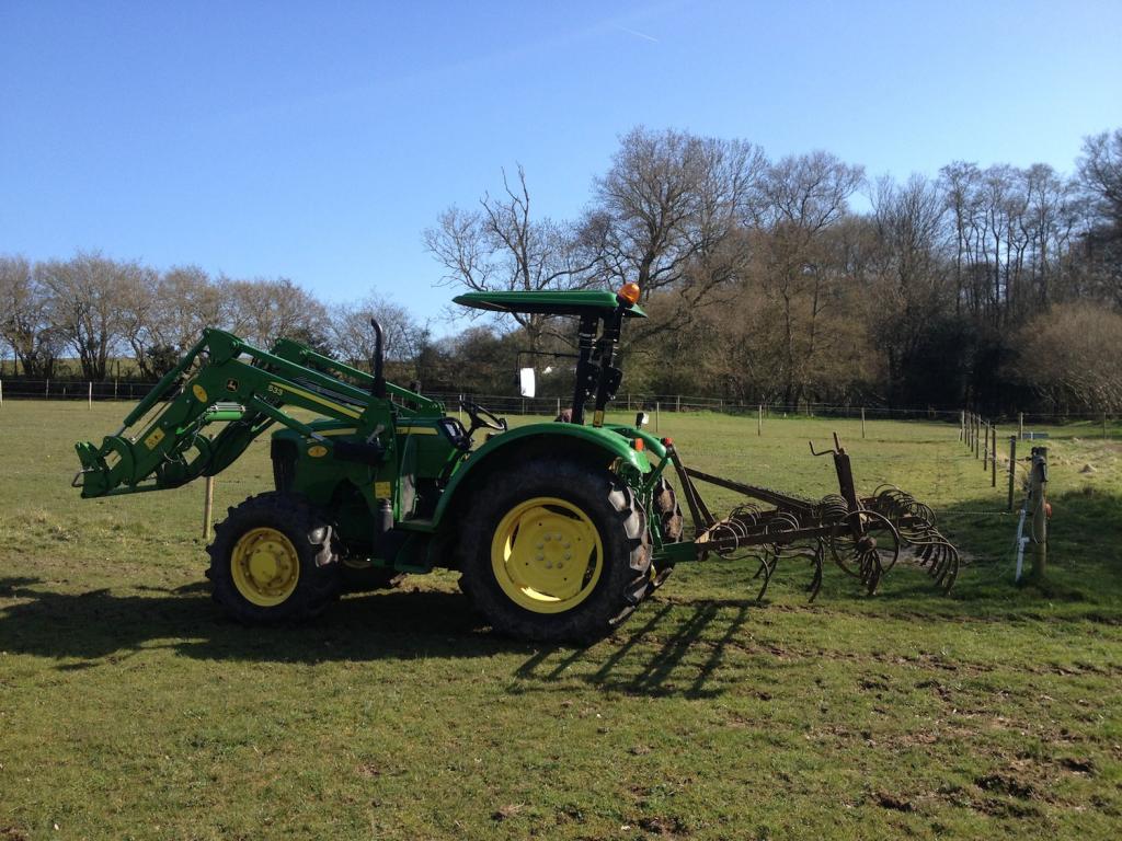

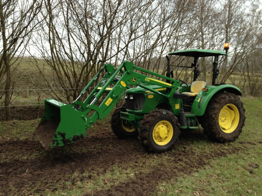

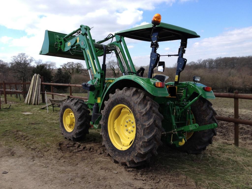

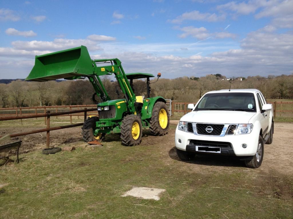

Very nice pictures! Thanks for posting. You have a good looking farm.
Is your loader a 553 with the self-leveling feature? I don't believe I've ever seen that model before. The rear fenders on your e are shaped differently than the North American model, too. You've got some pretty wide front tires there as well. Were they an optional add-on?
It's not very often that other farmers, ranchers and tractor owner's from other parts of the world post photos on TBN. So, it's always a treat to see other places around the planet!
AKfish
   / Is mowing a pasture supposed to be this hard? #60
AKfish
Thanks :) A lot of hard work has gone into it in the last couple of years and it's starting to come together.
The tractor is "Euro spec" so it's a bit different to what you're used to. The front load is a 533 with self levelling and they replaced the standard joystick with the fancier and more ergonomic version. The front tyres were standard. I am pretty sure that they are 320/85 R20 (12.4 R20), but I'll double check tomorrow.

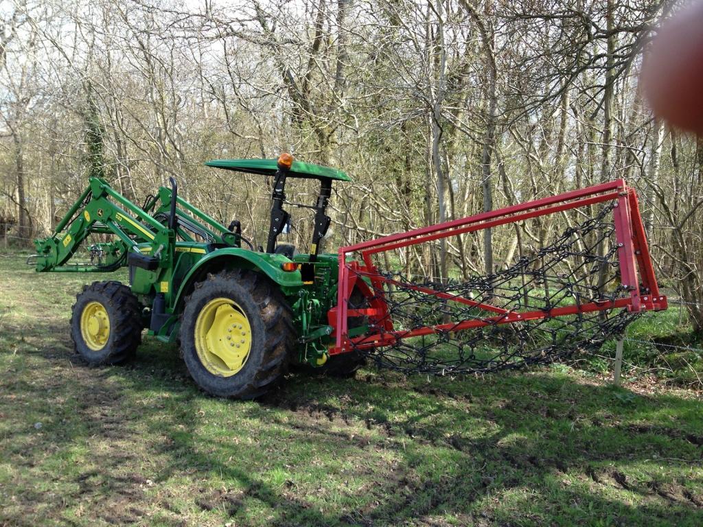

Here are some more pictures
One thing that I forgot to change when I ordered was the standard lift arms with the ball type attachments. They are a pain so I have ordered the telescopic versions. They should be here next week. You can see the pick up hitch which was also an option. It's the best thing ever if you're hooking up trailers or trailed implements.
