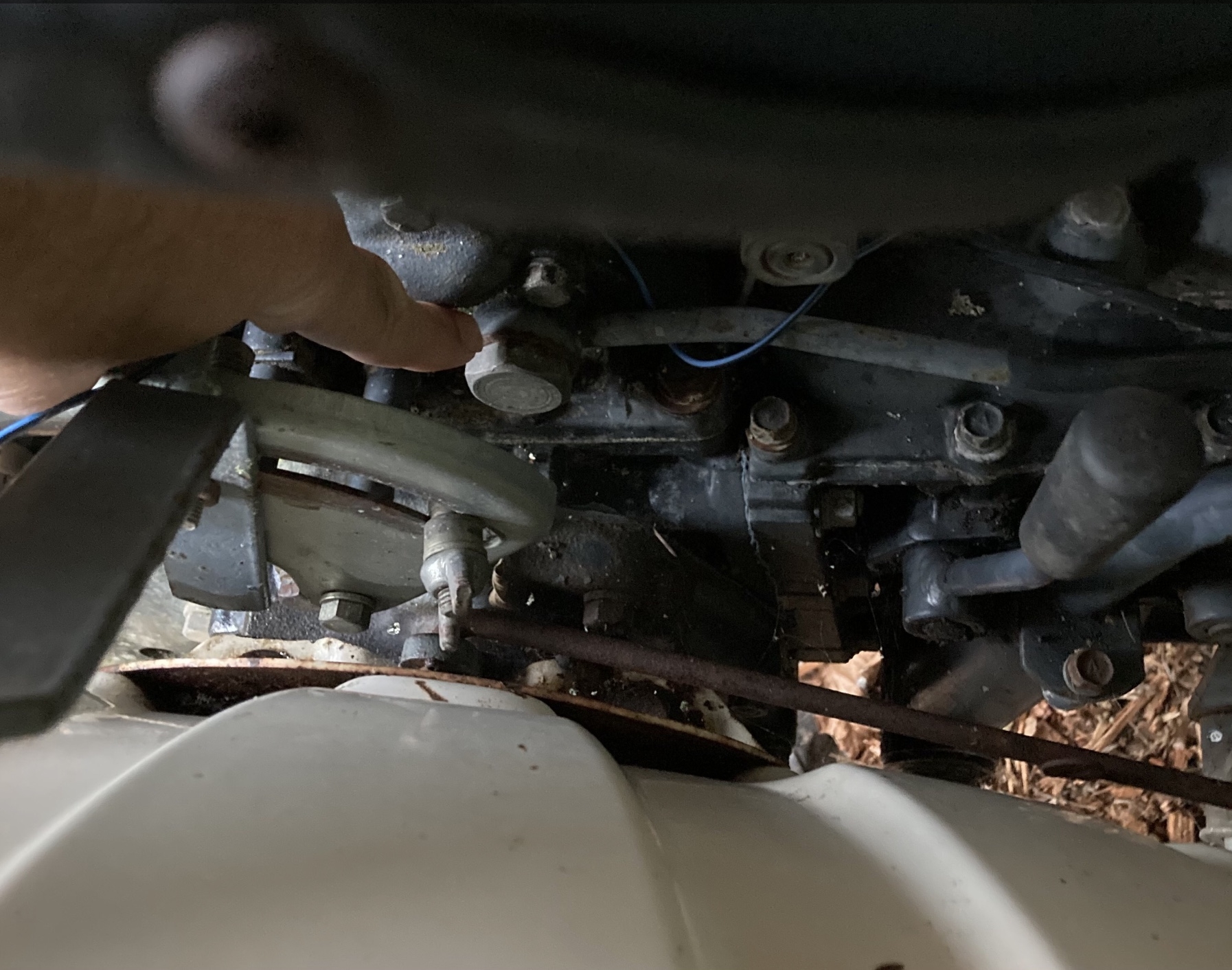

I have not changed mine, but isn't this it? If so, it is fairly high up and I would think not much fluid would need to be drained. My tractor is a Bolens G154 (Iseki TX2140) if there is a difference.
   / Is my hydraulic pump dead? (Tx1300F) #16
Thats not it, thats the high pressure side, suppling your 3 point linkage, check out the end of the larger diameter pipe, approx 20-25mm OD, below the leaver for either high and low or 4 wheel drive in your photo attached forwards and down.

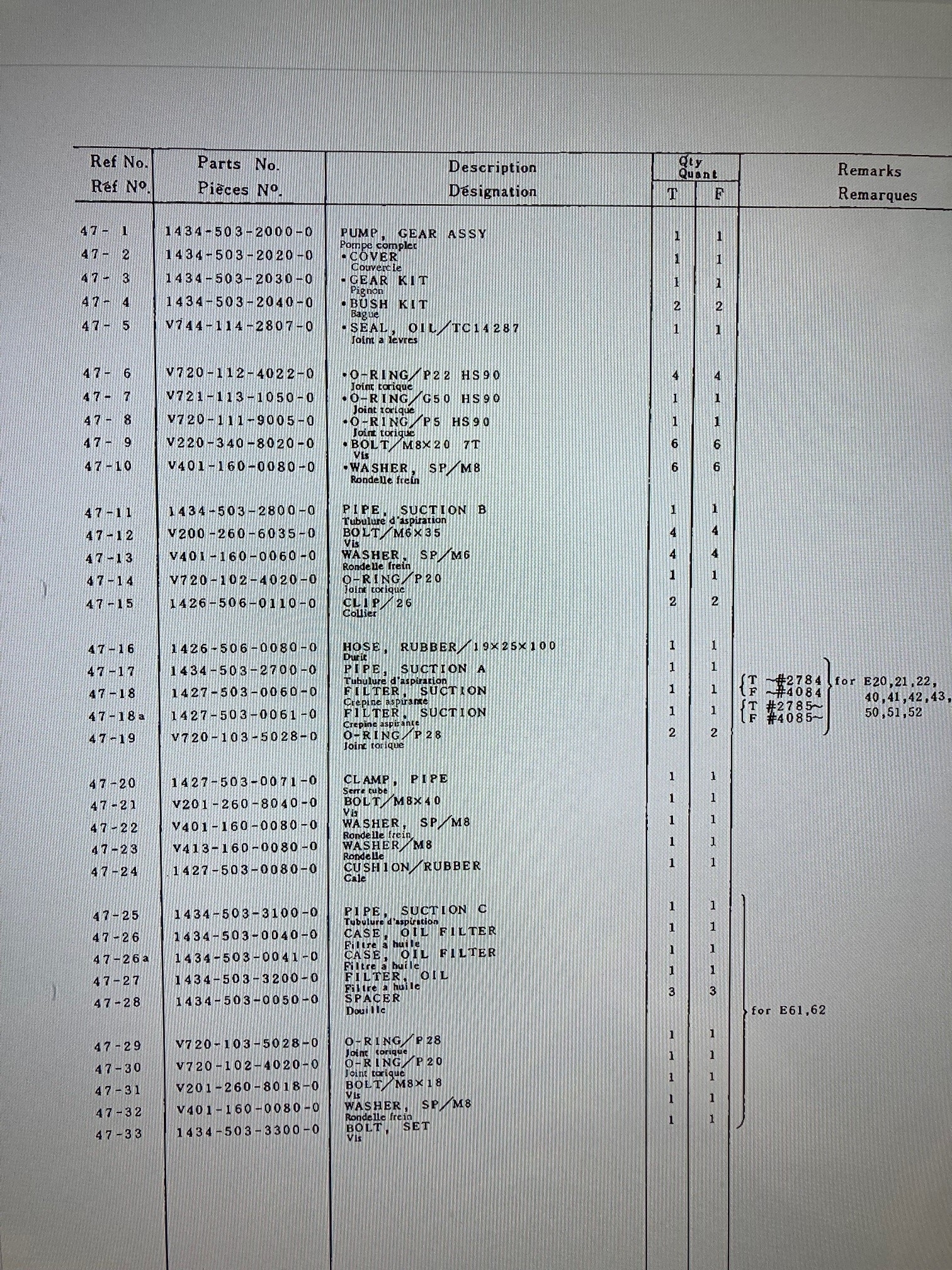

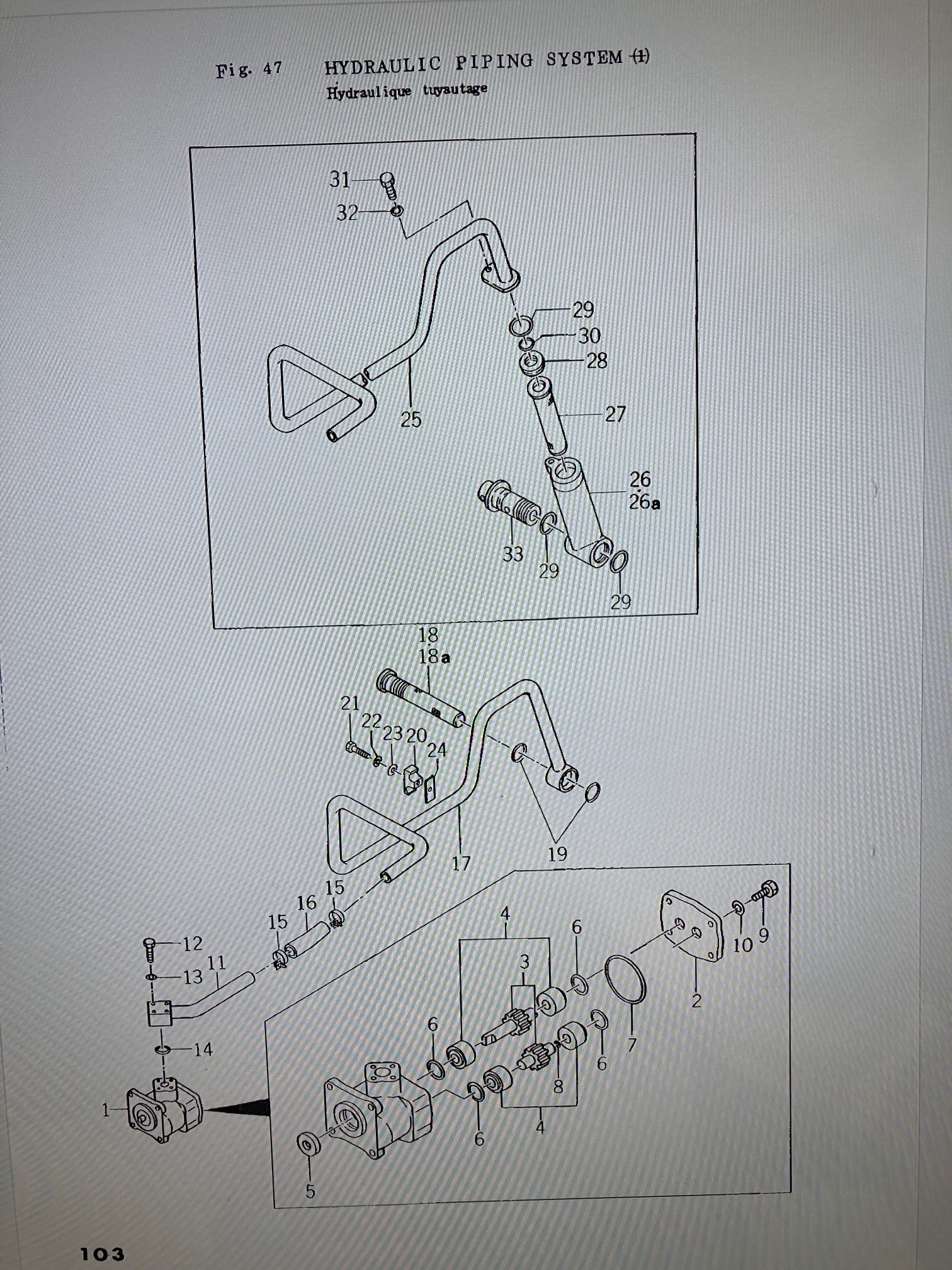

I see my confusion now. The manual shows two filters. Both 18 and 27 as filters. 18 being the upper one and 27 the lower one. Are there both?
View attachment 819927 View attachment 819928
Your one is the lower on that page, filter 18 or 18a, I am going to guess possibly the other is for the hydrostatic tractor, my parts list covers both types of tractor, mine is iseki 2140,2160 plus hydrostatic,

27 is what is on a 3 cylinder model. 18 is what is used on a 2 cylinder model. I haven't seen a parts book that covers both 2 & 3 cylinder models.
