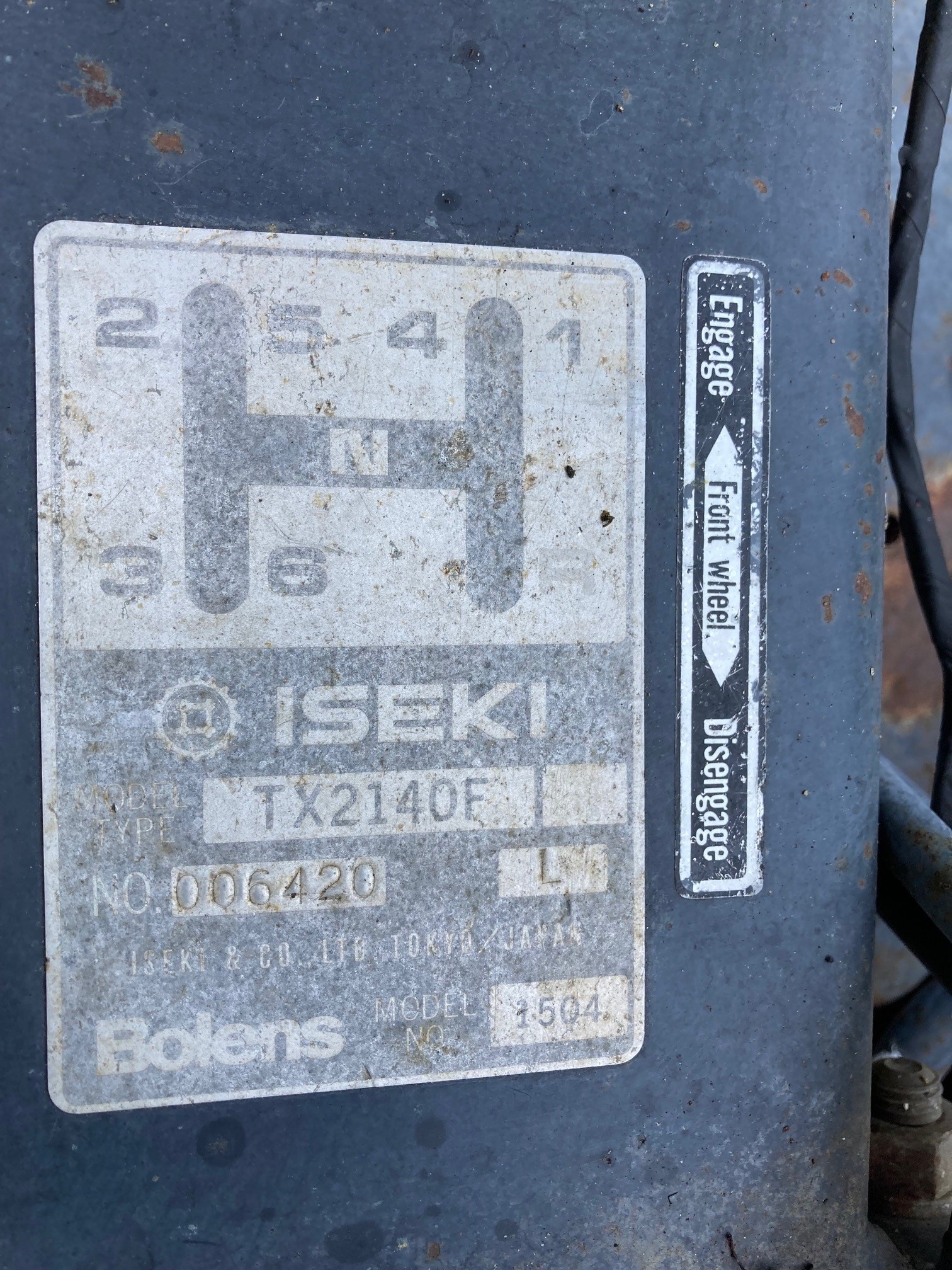

27 is what is on a 3 cylinder model. 18 is what is used on a 2 cylinder model. I haven't seen a parts book that covers both 2 & 3 cylinder models.
Interesting as my 3 cylinder iseki tx2160 has the 18 set up. K3B engine
   / Is my hydraulic pump dead? (Tx1300F) #22
The posted parts book is very small print. It looks like there is a serial # break. The TX2160 was sold in the US as a Bolens G174 3 cylinder model. they all used the 27 setup. The 2 cylinder was also sold as a G174/TX1500f
   / Is my hydraulic pump dead? (Tx1300F) #23
So this means I have a 27 filter? Bolens G154 with a 3 cyl Mitsubishi K3A. Label on tractor says TX2140F and 1504.. I can't seem to source a 27 filter on an initial attempt.
   / Is my hydraulic pump dead? (Tx1300F) #24
i CAN SUPPLY THE #27 FILTER. THE # 18 is discontinued. In place of #18 i supply an external spin on filter.
