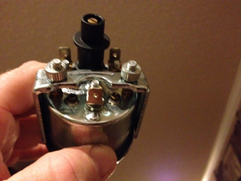

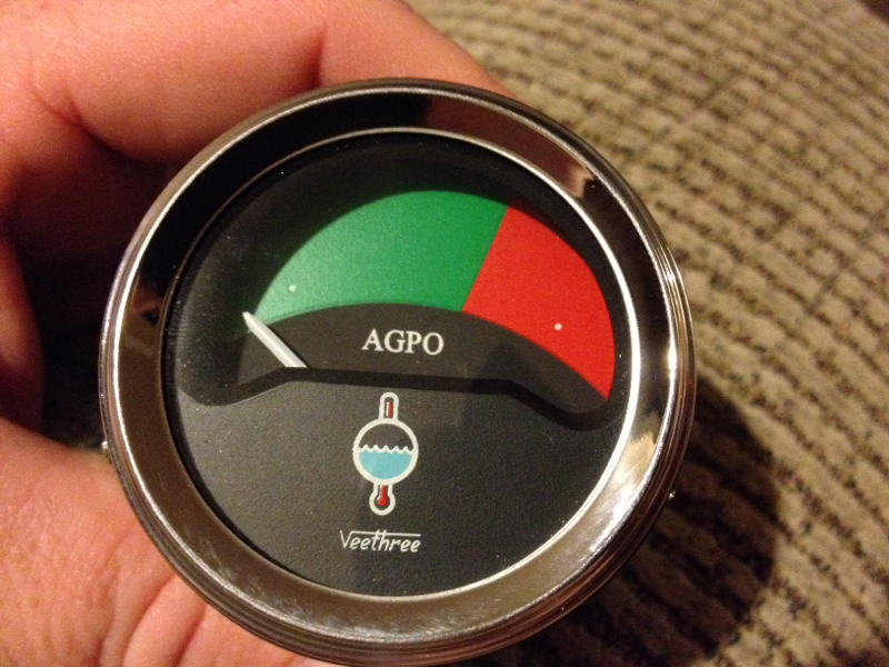

Well I did end up getting the sending unit and temp gauge in today. Didn't know the package was here til after dark. Looks like I'll be putting it back together tomorrow after I pick up the radiator. I'll do the testing with the old hoses til the new ones arrive.
Couple questions...
1) What is the small flathead adjusting screw for, that has plastic around it on the back of the gauge?
2) There's three male terminals on the back of the gauge. The upper left terminal has "B" stamped beside it, the upper right terminal has "T" stamped beside it, and the bottom terminal has what looks to be a "number 1 with 3 lines" stamped under the 1. There's a long line, a shorter one, then the shortest one.
Anybody have any information about this? Thanks

Normally the black looking thing would be the gauge backlight bulb, Adjustable screw??? Some gauges can be calibrated( changes relative position of needle) don't touch it
B. is battery positive
T temp sender
The last is universally recognized symbol indicating battery negative

Thank you!!
I didn't notice the old gauge having the adjustable screw but it does illuminate when the lights are turned on. The old gauge is still installed at the moment.
