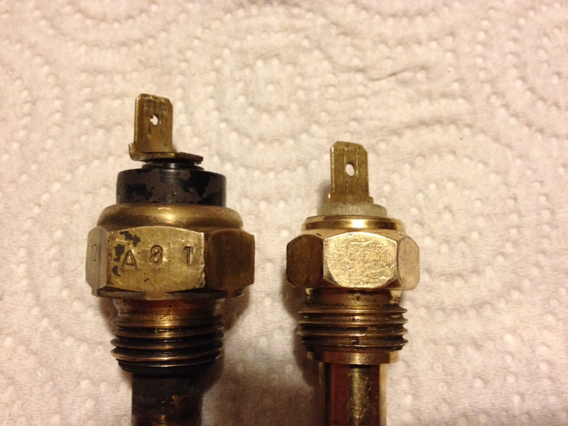

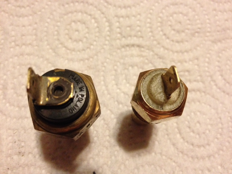

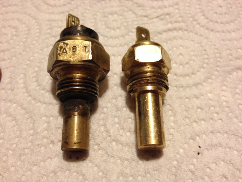

Now there's 2 new issues since I went out and tried to put the new temp sending unit in...
1) Look at the pics at the bottom of this page. The sending units are different!!! And I used the MF part number! The new one is "A &I Products" aftermarket (so is the new gauge). But there is a discrepancy in the part numbers from the invoice saying the new A &I part number is the same as the Massey part number. Well I got proof this isn't so!!
2) When I finally got the new sending unit installed (very hard to tighten up) I turned the key on. The gauge did nothing! It usually would jump up a third of the way in the green.
So as I was moving around, I bumped the metal instrument cluster panel that the gauges and tachometer mount to (panel is below/behind steering wheel). Soon as I bumped it the gauge moved a little!
So I turned the key off and turned it back on. The gauge didn't move. I hit the instrument panel lightly and the gauge moved again!! Kept repeating this turning the key on and off...
Bad ground somewhere??
I removed the new sending unit. No threads were stripped out on anything but I honestly don't wanna reinstall it. The head is completely smaller than the old one.
BEFORE ANYONE ASSUMES, the threads that the sending unit screws into are FINE. The old sending unit screwed back in perfectly.
I'm still not ready to give up and get a mechanic.
So now what??

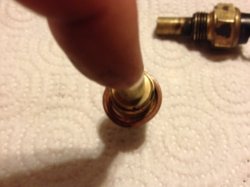

...forgot to mention that the new sending unit didn't even come with a brass washer. I'm guessing that's another screwed up part number that has to be ordered separately.

Been working on tractor all day. Taking a break right now. Installed radiator and new temp gauge (A & I Products part # A-1877719M92)
It has nothing to do with this thread and that's why I never mentioned it, but the absolute most difficult part was getting the new air cleaner intake hose installed! What a nightmare!!!
I know it sounds simple but it wasn't. If I would have put some grease or a light coat of oil it probably would have been much easier. I didn't have any lube though, although butter or cooking oil would have probably helped.
The temp gauge was bad for sure. Long story short, I tested it by grounding out the wire going to the sending unit... The new gauge works exactly like it's supposed to.
Now Im sable to say the title to this thread should be changed to "Massey 231 Temp. Gauge or Temp. Sending Unit?" (LOL!) since we know it isn't running hot, which was proven by the infrared thermometer...

ALSO... I do not recommend buying the A& I Products water temperature sending unit for this tractor!! They sent me their part # A-1877731M1, which was supposed to cross to the Massey number.
I ordered Massey part # 1877731M92 and the A&I temp sender IS NOT THE SAME. The head is smaller and the threads are different! The threads are the same size, but the thread pitch is different or something, I'm not sure. It didn't come with a copper sealing washer because it's tapered between the head and the last thread, which means it isn't supposed to screw all the way into the engine. I'm sending it back.
I ordered the Massey sending unit last night.
