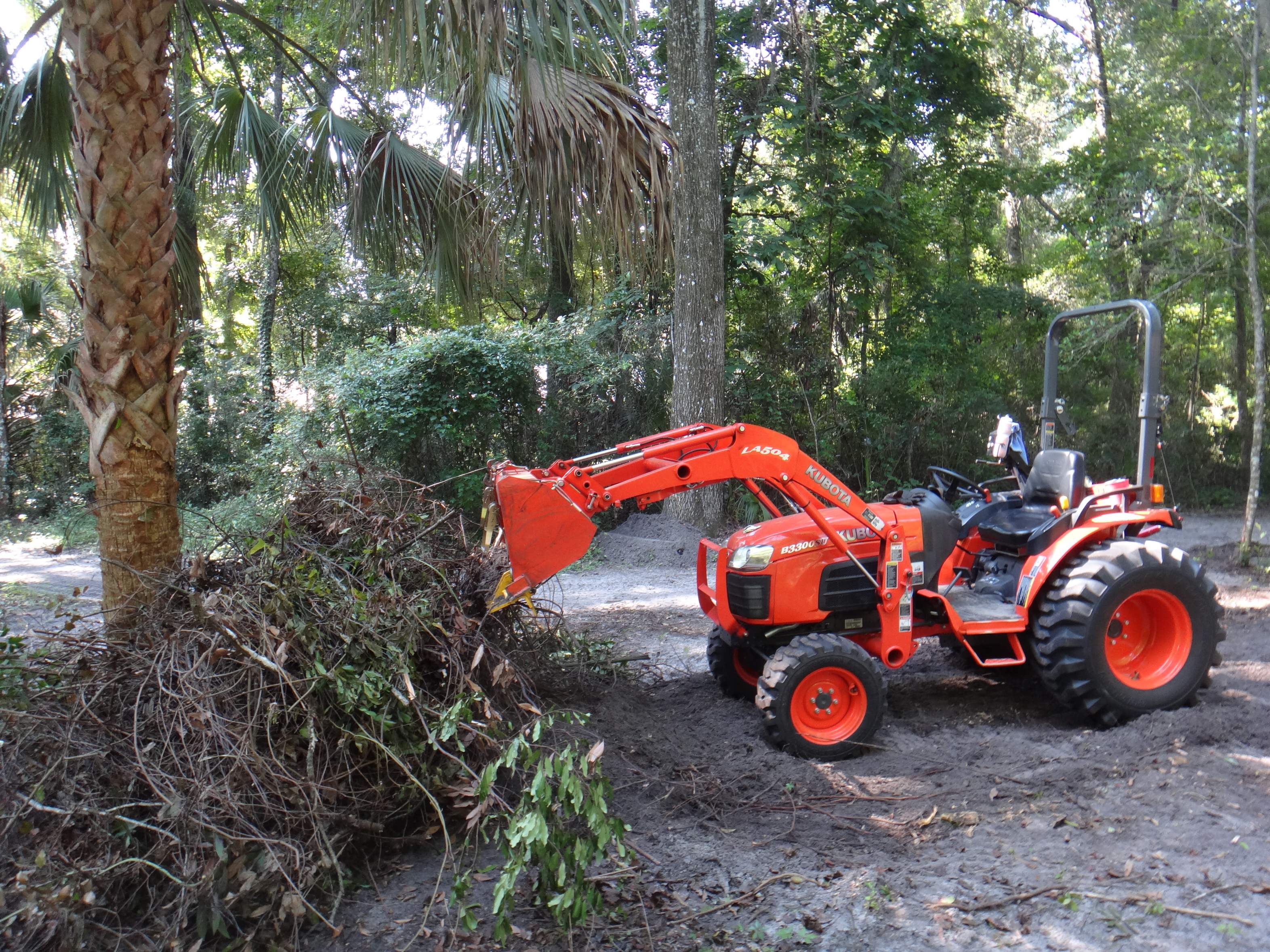

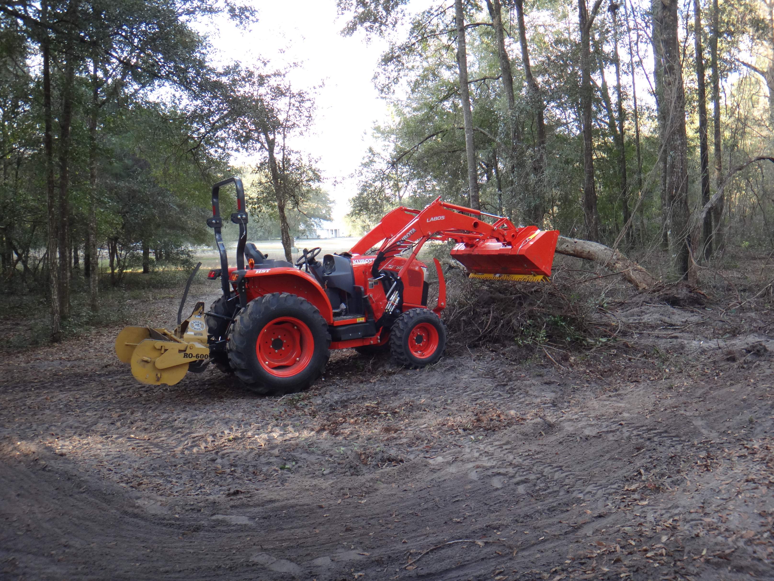

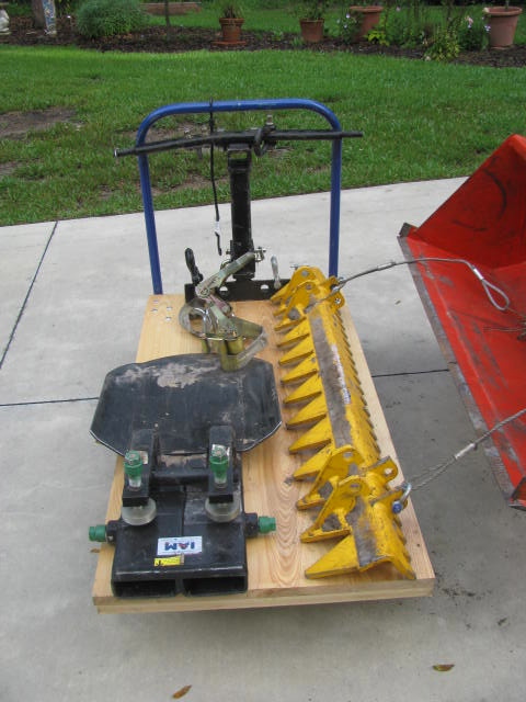

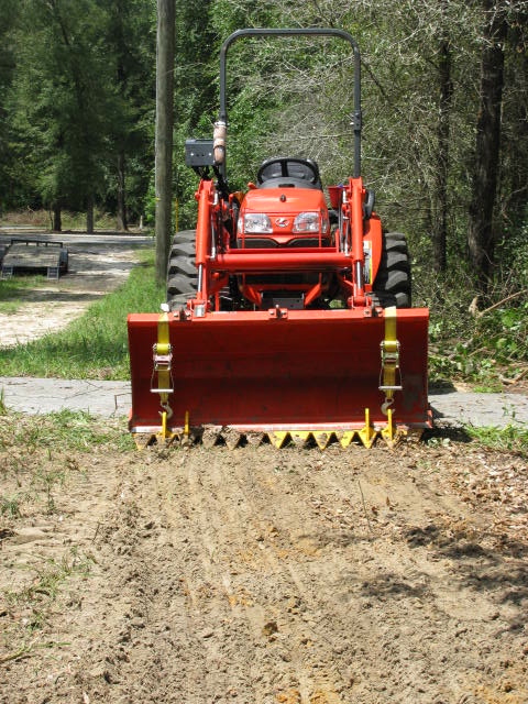

Consider a $330 Ratchet Rake FEL bucket attachment. For three acres of grass leveling and minor gravel driveway grading Ratchet Rake will be ample.
By rotating bucket you can get more "bite" with the lower teeth on the RR than you can with a (too) light Box Blade.
Ratchet Rake serves more purposes than a Box Blade. RR is effective at tearing out brush and vines.
The T-B-N store is an agent for Ratchet Rakes.
VIDEO: ratchet rake - YouTube
TBN Archive: https://www.google.com/search?client=safari&rls=en&q=Ratchet+Rake+grading,+smoothing+site:tractorbynet.com&ie=UTF-8&oe=UTF-8
