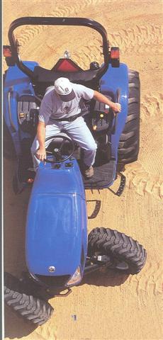

This is what the fun looks like from above. He may be hanging on to that grab rail to stay in the saddle.
