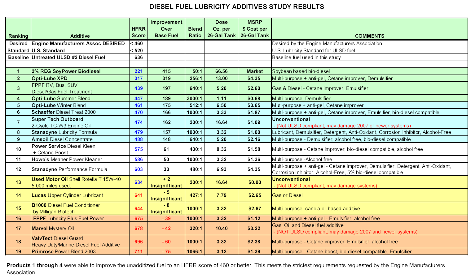

#26
That chart is great, thanks for posting it. I wonder if maybe the injectors in my tractor just needed a little cleaning so that the spray pattern is now what it should be. After sitting for two years without being started I think it's possible for a tiny hole to get kinda plugged. After about a dozen starts and maybe 30 hours of run time the 40 year old engine starts right away with the decompression knob pulled out. It's like the engine just turns over a couple times and it's running. I have to be quick to push the throttle lever back so that the engine is running at 1500 RPM because when the engine starts it's spinning at nearly 2500 RPM right away.
