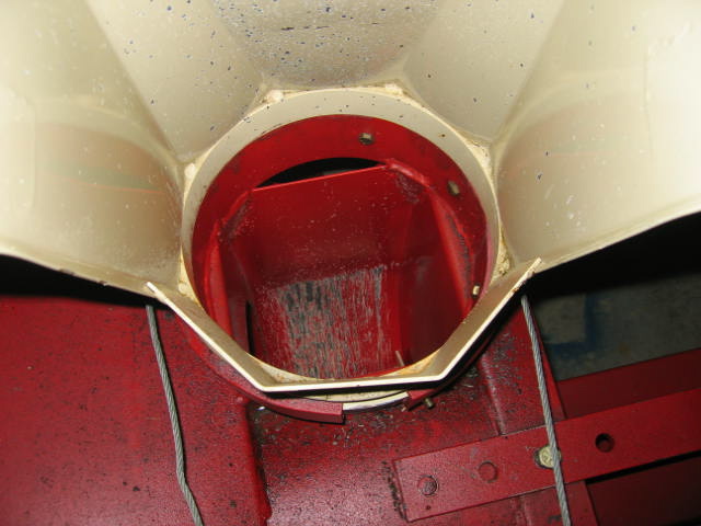

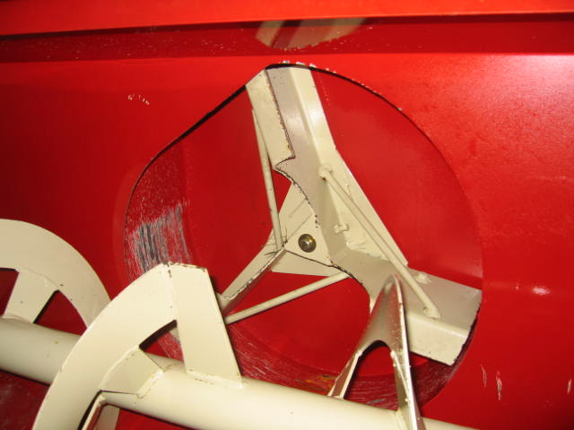

The drawing is labeled 9.75" on the fan diameter?
</font><font color="blue" class="small">( See pics for more measurements. All in inches.
Fan is 21 1/4, hole 21 3/4, depth 7 inches.... )</font>
   / Is something wrong with my snowblower?
#42
pic is now edited to fix error, thanks for pointing that out slowzuki.
   / Is something wrong with my snowblower? #43
I agree with Bob. If you do this commerically, I think you need to look at another blower based on your recount and the overall design of the blower.

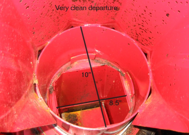

   / Is something wrong with my snowblower? #44
Snow...
Attached is a picture of my fan housing exit dimensions for comparison. There is a very clean departure from the fan blades to the chute.

   / Is something wrong with my snowblower? #45
I just took some pictures of my blower. My fan is a 3 blade design, it is just over 23" in diameter and about 8" deep. The chute is about 9" in diameter and the transition tube seems to have a good design in how it is integrated into the chute. The transition tube is wider than the fan so the snow doesn't meet resistance when it enters the transistion tube. The transition tube is also very short compared to SnowSebs. And then the chute itself looks very similar to JimMorrisey's & MadReferees chutes in that it doesn't rise at a straight verticle, it starts out at an angle right from the base, is shorter, and it follows the shape of the transition tube.
