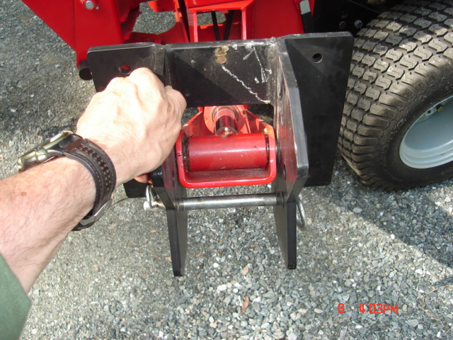

Hey, guys-- Think there's a possibility that maybe jaybrad's 2310 was delivered with the pin not in the "correct" hole to begin with?
Have a look at my pic #3 back a page, and compare to jaybrad's on page one-- in order to work properly, the pin needs to be in the far hole on the side opposite the metal cross-brace piece.
If jaybrad's pin was on the same side as the cross-brace when he got the tractor (as it shows in the photo) and he "put it back in the same hole" after flipping the foot....

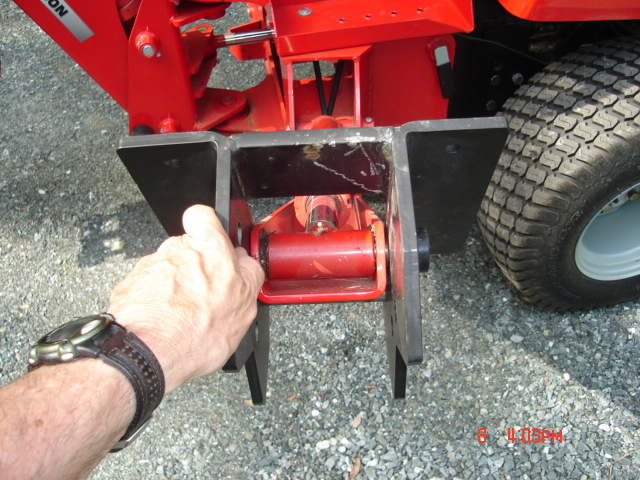

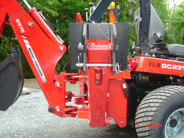

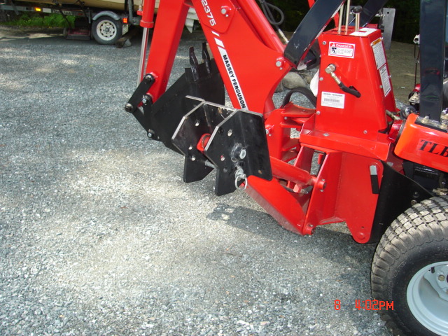

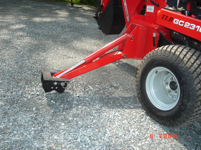

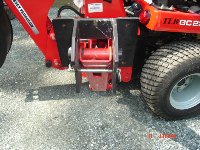

jaybrad, does your foot look like this as you try to flip it? I can't for the life of me figure why it doesn't work-- mine will hold fast until the arm drops, claws dig in to the ground, and the arm lifts the back of the tractor up in the air. :confused:

Sorry, those pictures are almost precisely in the reverse order!:eek:
   / Is the backhoe stabilzer foot reversible? #30
Mine works just like yours do in the pictures. No problem at all.
