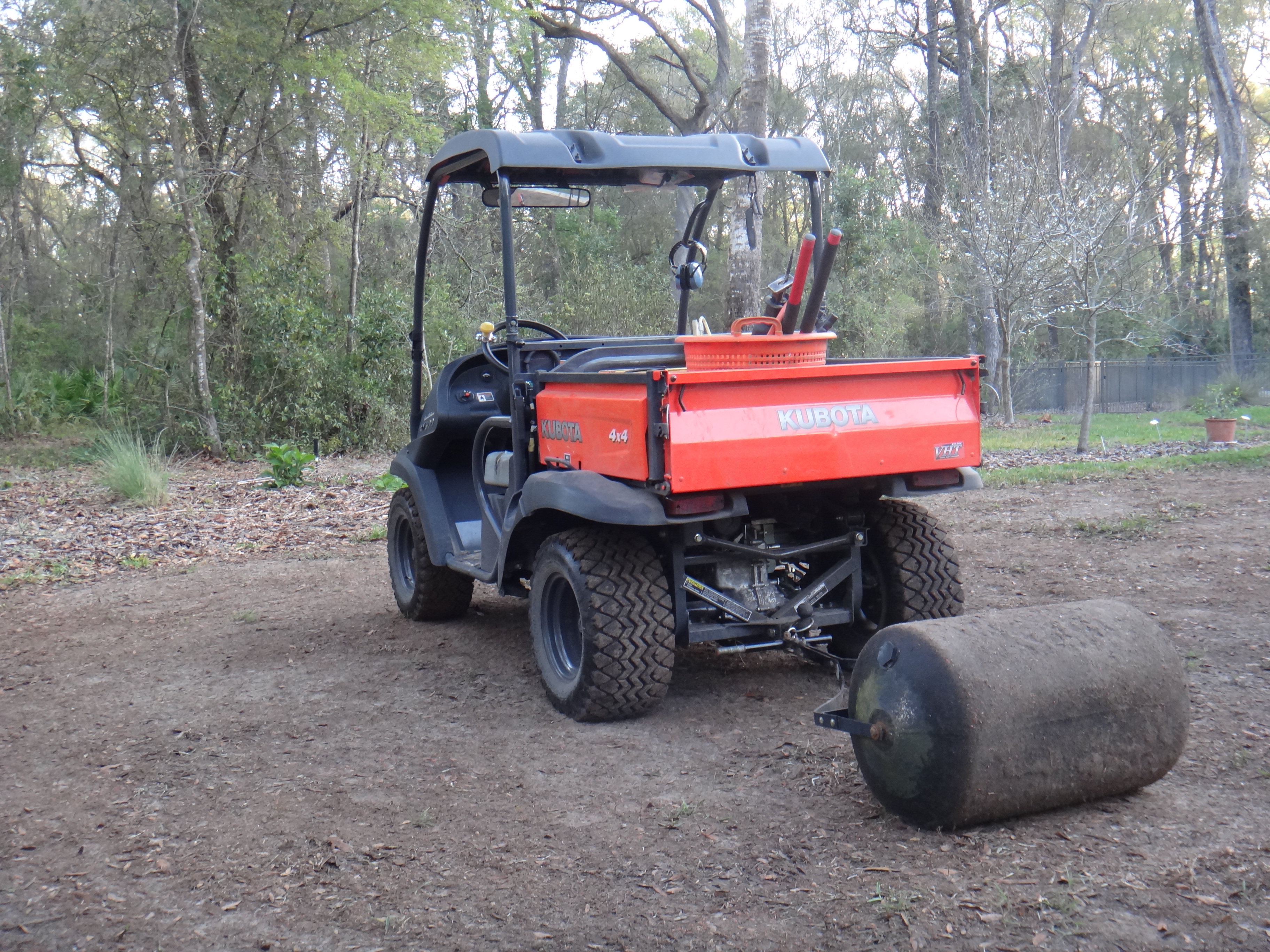

My experience in Florida:
I twice had my yard professionally sodded with primo quality St. Augustine grass @ $3,500 each time. It mostly died within thirty months. Against some advice I overseeded with Argentina Bahia pasture grass, which is gradually displacing the St. Augustine. St. Augustine has 2-1/2" roots, Argentine Bahia has 8" roots. They do not look very different. The big difference is that Argentine Bahia requires 50% more frequent mowing because it is so vigorous. I am happy. (My lawn is irrigated.)
After the careful soil prep you are planning I would seed rather than sod. Most landscapers will tell you seed takes longer to establish than sod but is more durable. You can hire a service to hydro-seed if you wish. I cast seed by hand then roll in the seed. Poly rollers are cheap at Lowes, Home Depot and Tractor Supply. Easy to run a piece of 7/8" all thread through the poly roller pipe handle, then through bull's eyes on Lower Links of tractor Three Point Hitch, then nut.
