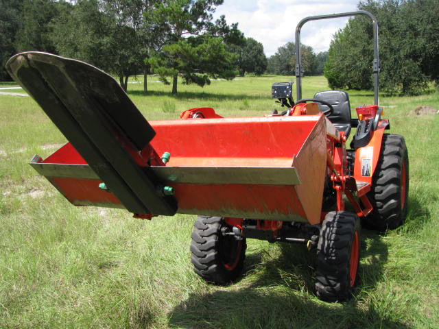

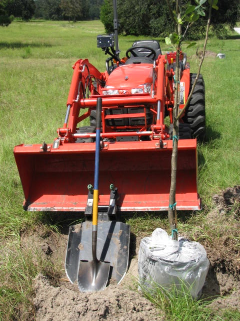

Tree spade weights 380 pounds. With a tree or dirt in the bucket a BX will not be able to lift the load, much less prize a rooted sapling out of the ground.
Many use a Three Point Hitch mounted, PTO powered Auger to create tree holes. I use a bucket spade but the bucket on a BX is not heavy enough to withstand bucket spade torque. The photos show bucket spade on a Kubota B3300SU tractor-loader package. Bucket Spade weighs 110 pounds.
A soil test is money well spent. As you can add N-P-K through fertilizer pay most attention to soil pH and micro-nutrients. Rather than attempting to change soil pH, try to find lawn seed mix optimal for the soil pH you have. What you need in NY will be completely different from what works in Florida.
If you do not think BX is enough tractor, look at the Kubota L2501/HST. More weight, minimal emissions controls, good price.

It's funny you mention the spade directly to the FEL, as I was just looking for such a product. I also have ~ 100 trees to plant when I saw a "tree scoop" attachment.
FFC 42" Tree Scoop Attachment | Skid Steer Solutions
Since I'm new to all this, would that attachment work on a bx2380 FEL? But now I'm also questioning if the BX2380 is enough tractor since the lifting capacity is only around 600lbs.
Pretty sure the Bobcat skidsteer shown in that picture weighs at least 6000 lbs.
The ad does say they (build to order), just a guess but a BX probably needs a smaller scoop that is about a 1/3 the weight of the pictured one. and no need for .375 thick construction for a BX.
Kind of surprised no one offers a light tree spade for ssqa subcompact tractors. If that unit was mounted to a BX it would leave an anemic 220lbs. of lifting force?
