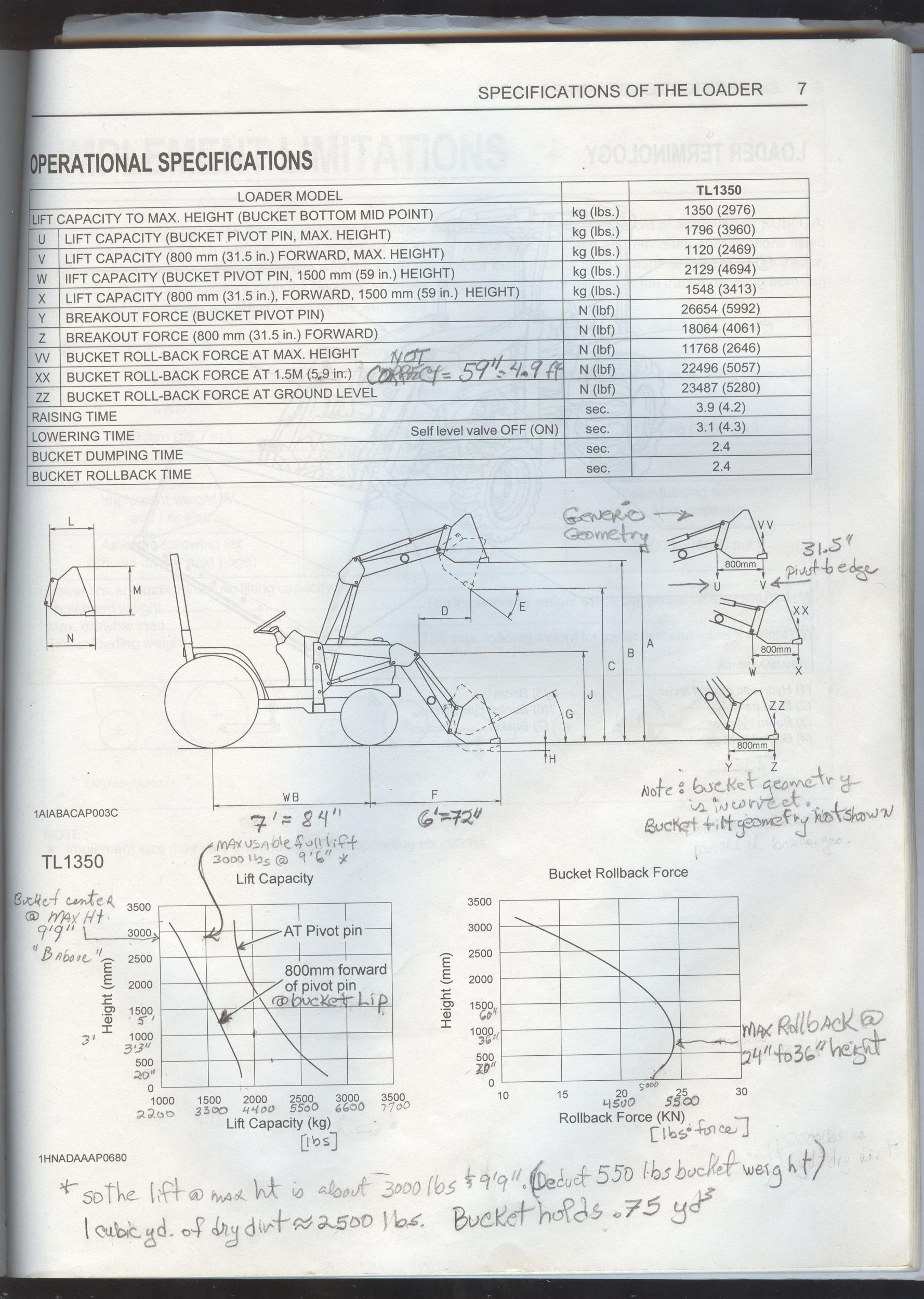

Technically, you are correct. It is possible. But for the brands that are being discussed, that is not true. Show me one loader that outperforms another at one height, while underperforming at another.
More simply, put, show me a loader that has a lower lift capacity at max height, but a higher breakout force for the tractors we are discussing.
They all use the same kinematic linkage, with slight variations in the pivot points. That will yield slight variations in the shape of the loader curve. But that won't account for a 10-20% variation in lift capacity.
Correct or not, that is just the way that geometry and physics works. Small differences make for a wide variation in lift capacity and in where the lift occurs. That is true for every loader and every design. Check it yourself.
Every loader I have ever looked at has a lower lift capacity at max height. And breakout force is often double lifting force.
No, loaders do not use the same kinematic linkage. That is a misconception. You can simply look at them to see the differences. Look at bucket tilting connections for an example. Complex parallologram linkages and special castings there are common. Complex linkages probably add cost to making a loader
But I've also learned something from this thread. I've learned that science and math don't matter as much as they used to. Technology used to be King, but today's influencers and advertisers approach their trade differently. They shape opinion by presenting what the consumer wants to believe - whether accurate or not.
And what today's consumer wants to believe is that an item can be made inexpensively and be just as good as something that costs more to make and sell. Whether that is true or not doesn't matter. What matters is belief.
I find this all fascinating, so thanks. I hope we've added some value.
This is a page out of a standard Kubota operator manual.
rScotty
Either I didn't explain myself clearly, or you're avoiding the question.
1) The kinematic linkages for lift (not roll back - we aren't discussing that) are the same. They are a simple 3-bar linkage. Yes, you can move locations around, but the mechanism operates via the same principle.
2) That principle is, generally speaking within the range of parameters seen on tractors, the highest lift force will be at the ground, with the lowest at the maximum height (exactly as shown in the diagram you included).
3) My original contention was that if loader A has higher lift force than loader B at the same lift height, then it was going to be able to lift more at all heights. You disputed this. I agreed that this could happen in theory, but within the current models of loaders being discussed, did not occur.
4) I then asked you to show me any two loaders (let's call them A and B), where loader A has a higher lift capacity than B at maximum height, but loader B has higher maximum lift than A at the ground (i.e., breakout). You instead included an attachment of you Kubota loader with handwritten notes that answered nothing.
