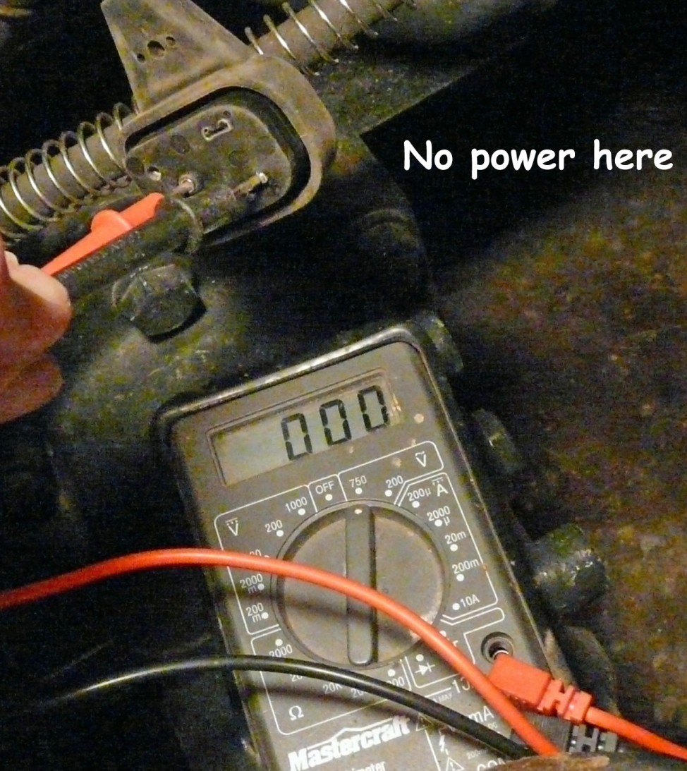

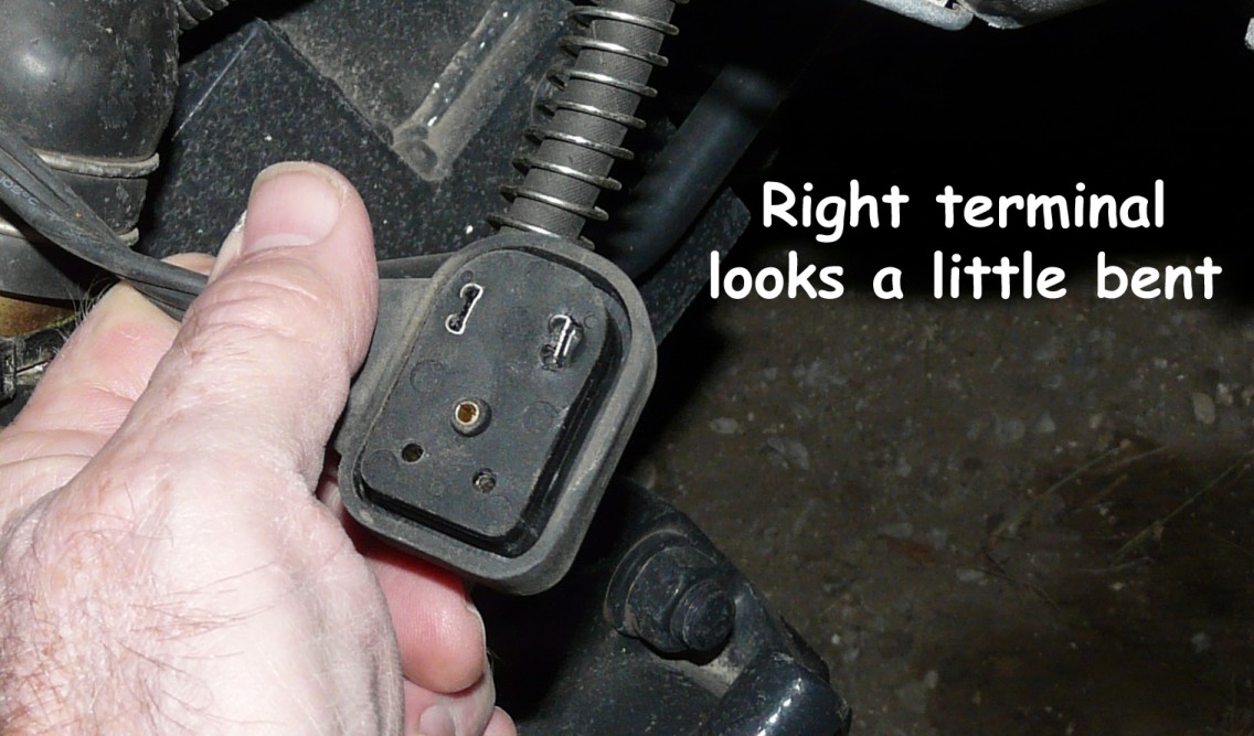

Had some rad problems and discovered a leak at the lower rad hose heater.
Fixed the leak - a couple of loosened clamps - but now the heater is not working.
I took some pictures (worth many words I think) and am wondering if anyone knows whether it might be the cord that is faulty. The other end of the cord is plugged into a 120 circuit.
If not, how can I check the heater element?
Ideas welcomed.
Two more pics on next entry
Thanks Bob

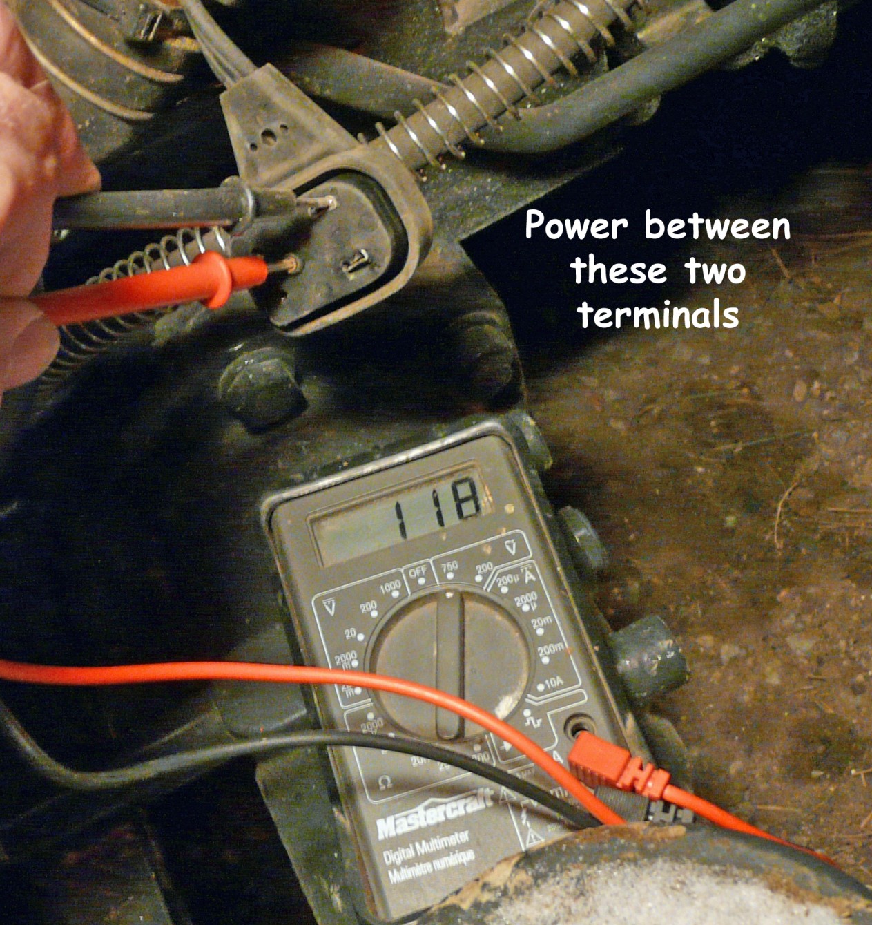

Two more photos
Just a reminder - the other end of the cord is plugged into a 120 circuit.
Thanks again

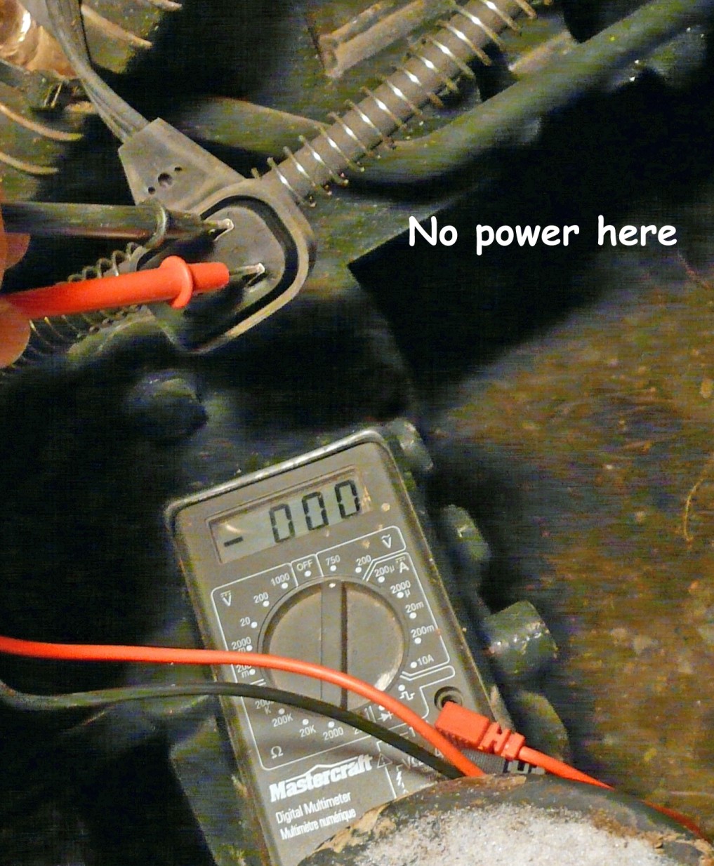

Here's my guess Bob.
Using your pic #2, top 2 spade terms are your klixon/temp controller, center peg your ground term and bottom 2 pegs your heater terms.
Power comes in off your cord to one of the top spades. If your temp control is closed, it continues out the other spade thru plug and into one of the bottom heater terms, thru your heater element, out the other bottom term and out the cord.
Is your 'temp control' closed ?
Edit add on; Take an ohm reading between the top 2 spades, this will tell use if your control is closed. It'd be useful to know what temp it activates at. Maybe it's too warm to 'click' on ?
Take another ohm reading between bottom 2 pegs. Not sure what it's supposed to be, but should get 'something'.
And while your there, a reading from heater base to each of the bottom pegs one at a time. That reading should be zilch (or no reaction from meter).
   / Is the lower radiator heater cord shot?? #4
Unplug your cord and using your ohm meter you can verify who's who between plug ends.

Yep the round gizmo in the first picture is your thermostat. That should read a very low resistance when the temperature is cold enough. That will conduct the electricity through the heating element and warm your tank. My first guess would be the heating element has opened up.

Well, I got a couple of minutes this morning and here is what I found.
I don't have a lot of experience using the meter for ohm readings - I set it at the lowest range which is 200 and took the recommended readings three times just to try and be sure
It read 1.1
This read between 44.1 and 44.7
The meter did not change so I assume that is "zilch"
Now that I have these numbers, what do they mean?
Defective cord?
Defective heater element?
or ???
Thanks for your patience and knowledge.
Bob
   / Is the lower radiator heater cord shot?? #9
Sounds like your control. With it being that cold, that control should be closed.
Recheck it with your ohm meter just to double check.
You should be getting the same exact reading as you would touching your meter probes together. 0.0 ohms.
Tried it again and got the same readings with the same meter.
Also tried it with a different meter (again just to be sure) - this one has its lowest scale at 2000 ohm (not 200 ohm like the other one) but it also has what it refers to as a "continuity beep".
While the meter went from showing "1" to showing "0000" between the two spade connectors on pic 2 and between the two posts at the bottom of pic 2, there was a audible beep.
I believe that means there is continuity where there should not be.
If I understand your analysis Will - the heater element is toast and needs to be replaced.
Am I correct?
Thanks
Bob
