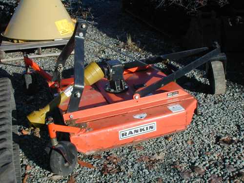

This design is bad, see photo. My model has the pins spun outwards so I have to spread the 3ph arms to get them off. The important thing to avoid is the lowest pivot and the 3ph pins with a big nut and a lynch pin.
See how the lower pins are attached so that you have to remove the 3ph stabilizers and sideways slide them on and off of the pins? The other bad thing is that when you mount your 3ph arms to a pin with support on only one side and then use your tractor to push on the attachment you induce a twist that will twist the heck out of the black part. I'll try and find what I want it to look like. The heavier duty RCs are all equipped with a mounting like a box blade which has a removable hitch pin deal and is more desirable.
If I was just mowing lawns the pictured style would last a long time. Trying to knock over small trees and such, which the RC is fully capable of digesting, makes the pictured attachment style insufficient.

Highbeam,
I don't believe the finish mower you have shown as the "bad design" was designed to be used as a "brush cutter".
Any implement that is pushed into service that it wasn't designed for might well be a "bad" choice for that task.
   / Is there a "bad" brush cutter #20
Re: Is there a \"bad\" brush cutter
That bad design finish mower, as you call it, is a brush hog with gauge wheels welded on by the owner. I'll agree that there are light duty hogs and there are heavy duty ones. The single design element of the lousy upper arms is a weak point in the light ones that you should avoid if you are going to be using a lighter duty hog for occasional heavier duty work.
Hey, I can break anything if I try to. I could also baby something and never break it. The poster wants to cut 3" stems and that requires backing into brush which is more than some designs can handle.
