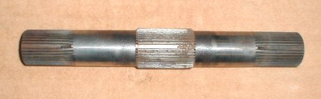

   / Is there a glossary of terms? #54
Here you go.. from the parts manual:
Hydraulic lift rock shaft part number 9N544
Fits all 9N-2N-8N-NAA tractors
here's a pic, and again.. as I said.. dates to 1939.. etc..
Soundguy

   / Is there a glossary of terms? #58
No it was a generic mechanical term that has been around for quite a while...:D
rock shaft
(Science: machinery) A shaft that oscillates on its journals, instead of revolving, usually carrying levers by means of which it receives and communicates reciprocating motion, as in the valve gear of some steam engines.
If you do some surfing you will find Rockshafts in Bessemer engines...pre 1900s...:D
   / Is there a glossary of terms? #59
If you think about your basic pushrod actuated overhead valve engine, the parts which rock back and forth pushing the valves down and letting them open are called rocker arms or rockers. The action of the 3 point lift arms is similar to valve rocker arms, hence the shaft to which the lift arms are mounted and which transmits the motion to the arms by way of the splined fittings is a rock shaft because it rocks back and forth as it performs it's designed function.
