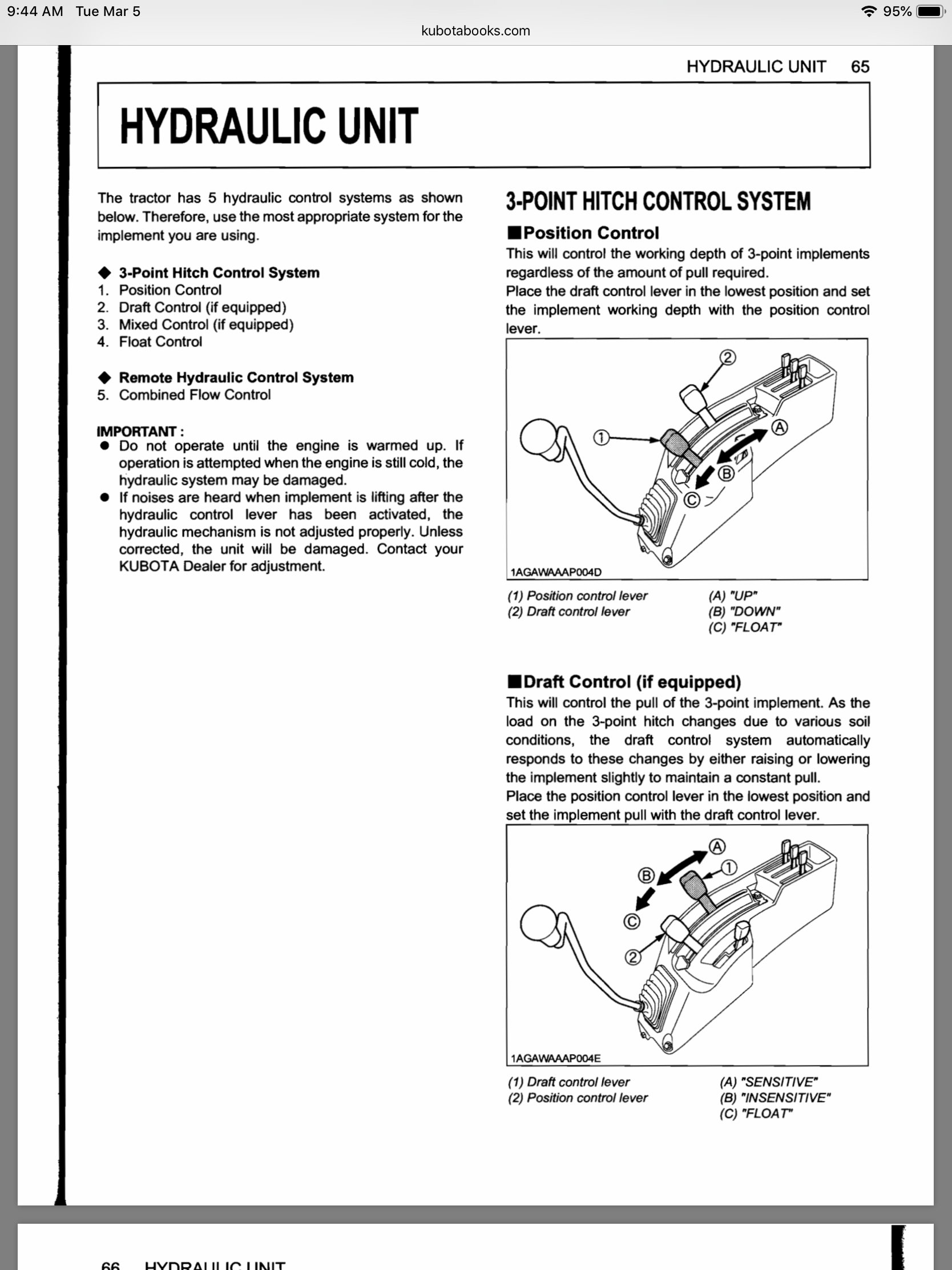

I've searched and read a ton of threads on "Position Control", "Draft Control", and they all seem to imply that the hydraulics can apply up pressure lifting the implement, but gravity is all you got going for you going down. I believe my tractor (Kubota L5240) has Position Control but not Draft Control.
I'm trying to solve a "hopping" problem with the add on grader blade to a LandPride LR 3784 rake, using it to scrape small snowfalls (1-3"), that are too little to dink with the blower.
Short of just adding more weight, is there any way to apply additional down pressure on an implement?
If you have draft control, it should be right next to the position control, similar to this...
