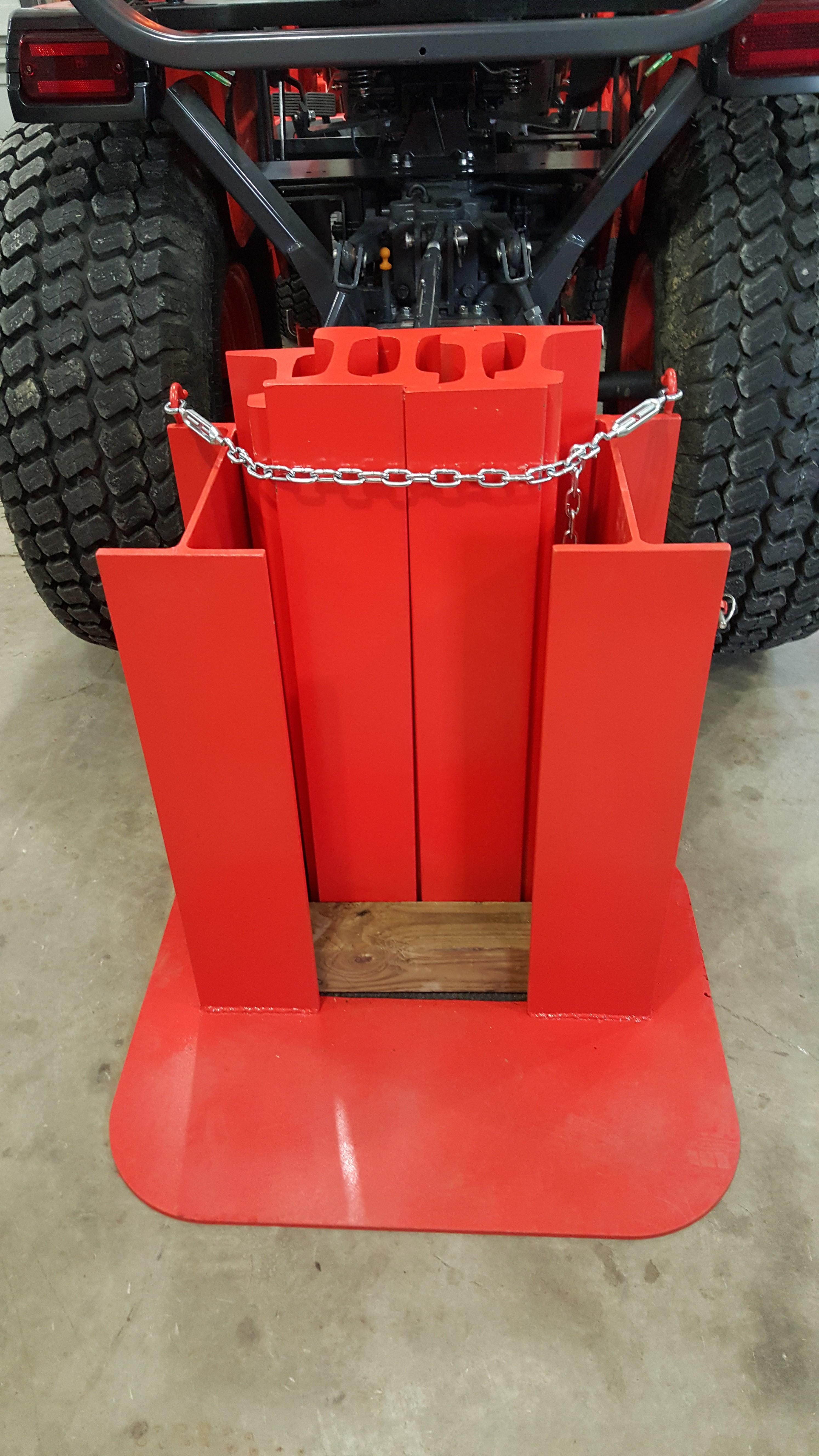

When I got my Kubota B2650, I also wanted to fab up a nice compact ballast box for doing my snow plowing and other work. Looking thru forums found around 70% of loader lifting capacity as a good starting point. With mine I fabbed up the frame and could add lengths of railroad track I had got that weighed 100lbs apiece. I started with 500lbs and would test with a full bucket of heavy clay driving around on uneven ground to see how well the tractor stayed planted. I ended up with 700lbs, but if I was going to do alot of real heavy loader work I would add another 100.bs My loader is rated about 1100lbs, so around that percentage. As Jeff9366 and LD1 said for you, 1000 to 1500lbs, with 1200lbs being around 75%. As they also said there can be other factors for different tractors, but should get you in the ballpark.

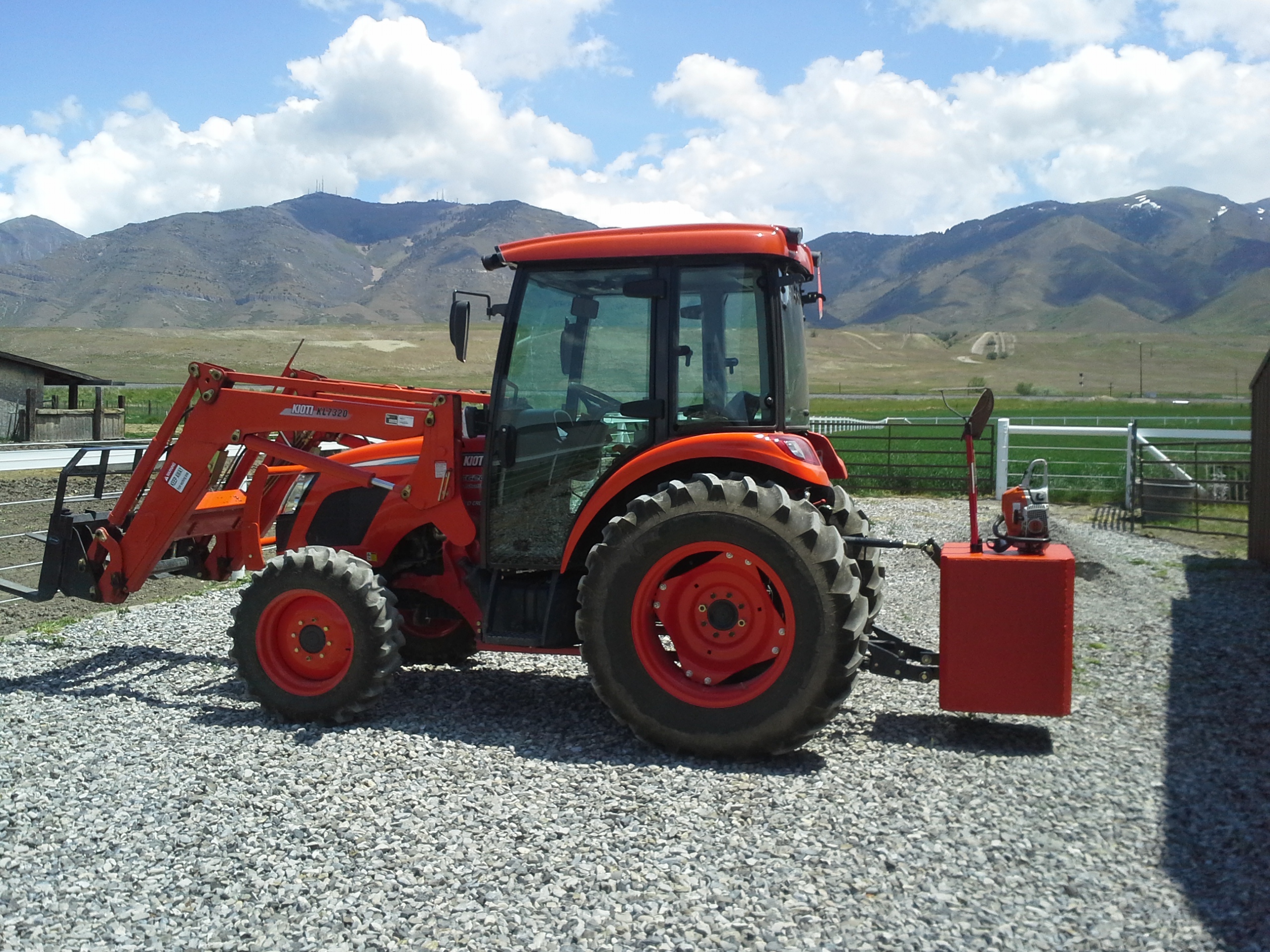

The advantage to building your own box is you can design it however you want.
Here is the one I built. Close to 1600 lbs.
