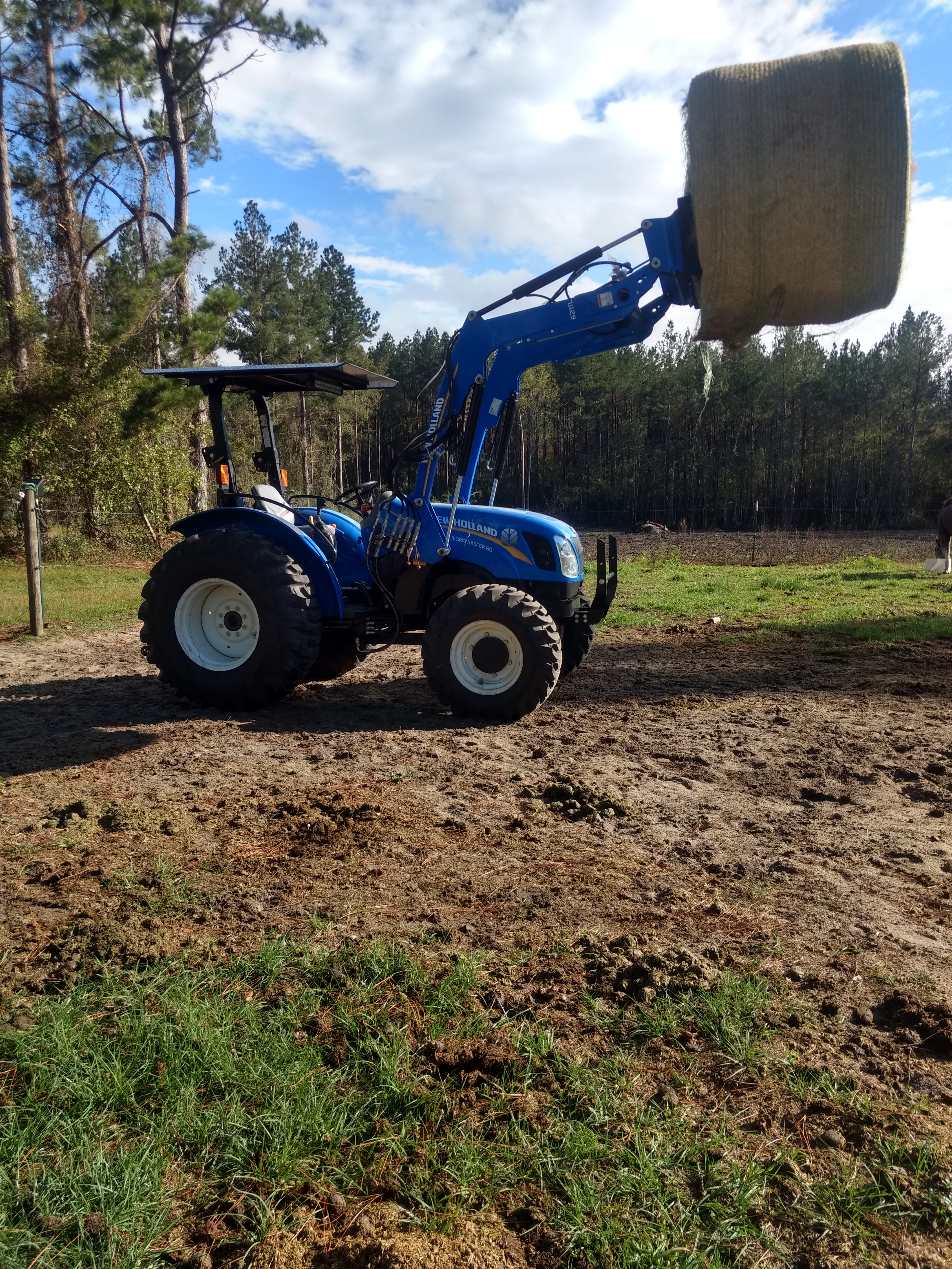

OP, looking at your loader specs and wanting to keep your rear tires unloaded (air only) I would say a rear ballast of 1000lbs should about cover you for max front loads and not going fast.
I added a picture of my tractor with 1200 lbs of fluid added to my rear tires loaded & a 1100 lbs round bale of hay on my hay spear. I can travel like this safely (not lifted in the air of course) at slow speeds and flat ground. So say you shift that weight (my loaded rears) back another 4' on your 3pt hitch it will shift the weight back farther adding for stability. I did build a ballast box for my tractor also that weighs around 1000lbs for most all of my task and be fairly compact. Granted different tractors and weigh differently, but before the loaded rear the rear was light with just the loader bucket.
