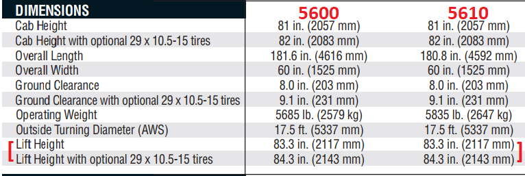

I know the OP doesn't want to consider a Power Trac, but jeez, a PT1460 is $26,000 new. A new 5610 toolcat is pushing $50 grand!
That's a heck of a lot of money left over for attachments and beer.
The PT1460 lifts 2400# while the toolcat is rated at 1500#(if equipped with optional counterweight option). They have similar GPM and pressure on the standard hydraulics. The PT has 33% more ground clearance at 12" VS 9". The 3pt hitch is optional. The PTO is optional. The high flow hydraulics are optional. It brings the price to $50K.
I can't find the lift height for the 5610. The PT1460 is 8'.
The 1500 pound rating may be related to the way Bobcat rates skid steers. It is half the tipping load.
I checked our 5610 F series with the crane scale, it went over 3000 pounds and the rear with nothing on the 3 point stayed on the ground:
They handle the 1800 pound 7' brush hog easily:
Lift height is 7':
