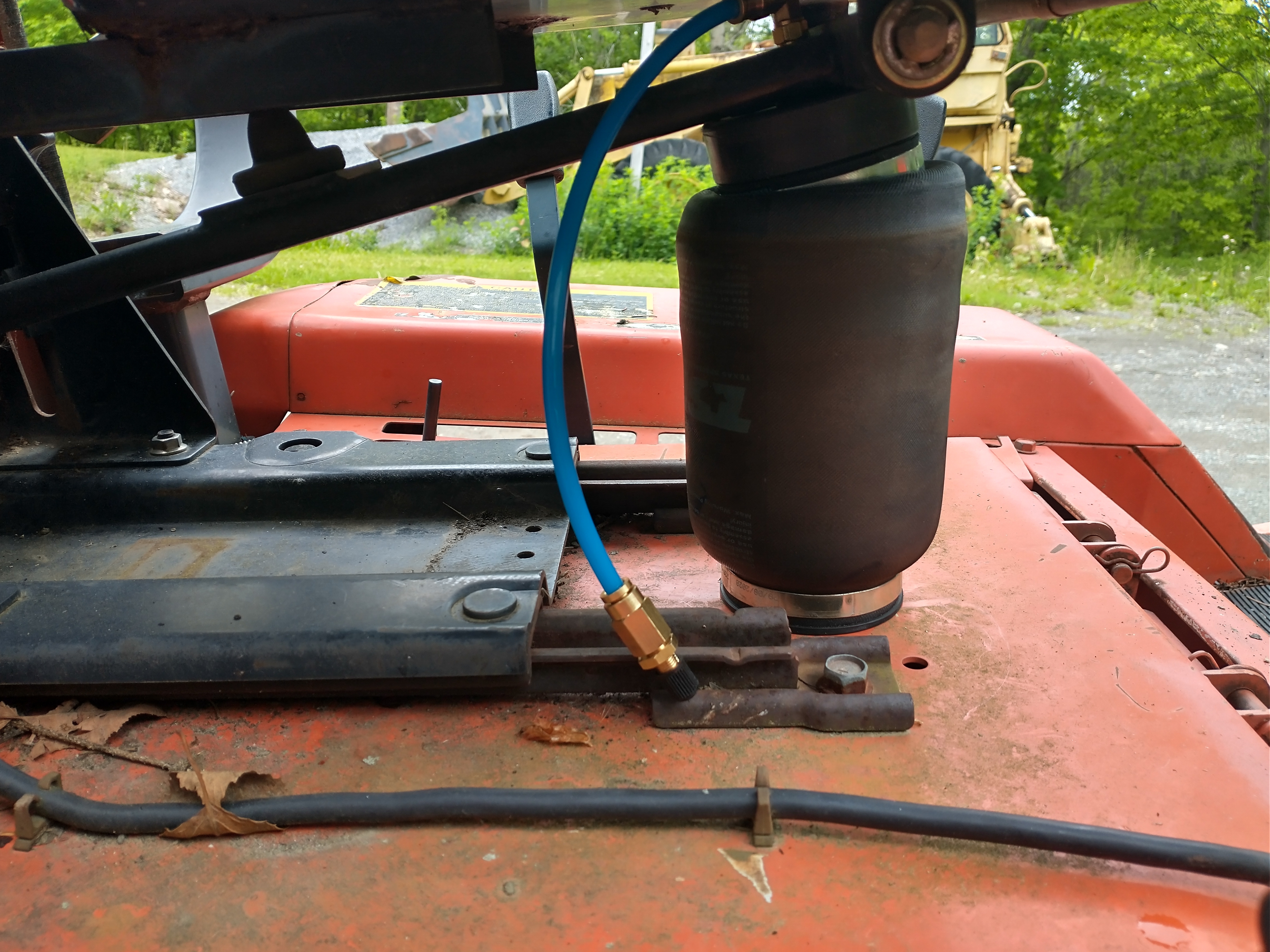

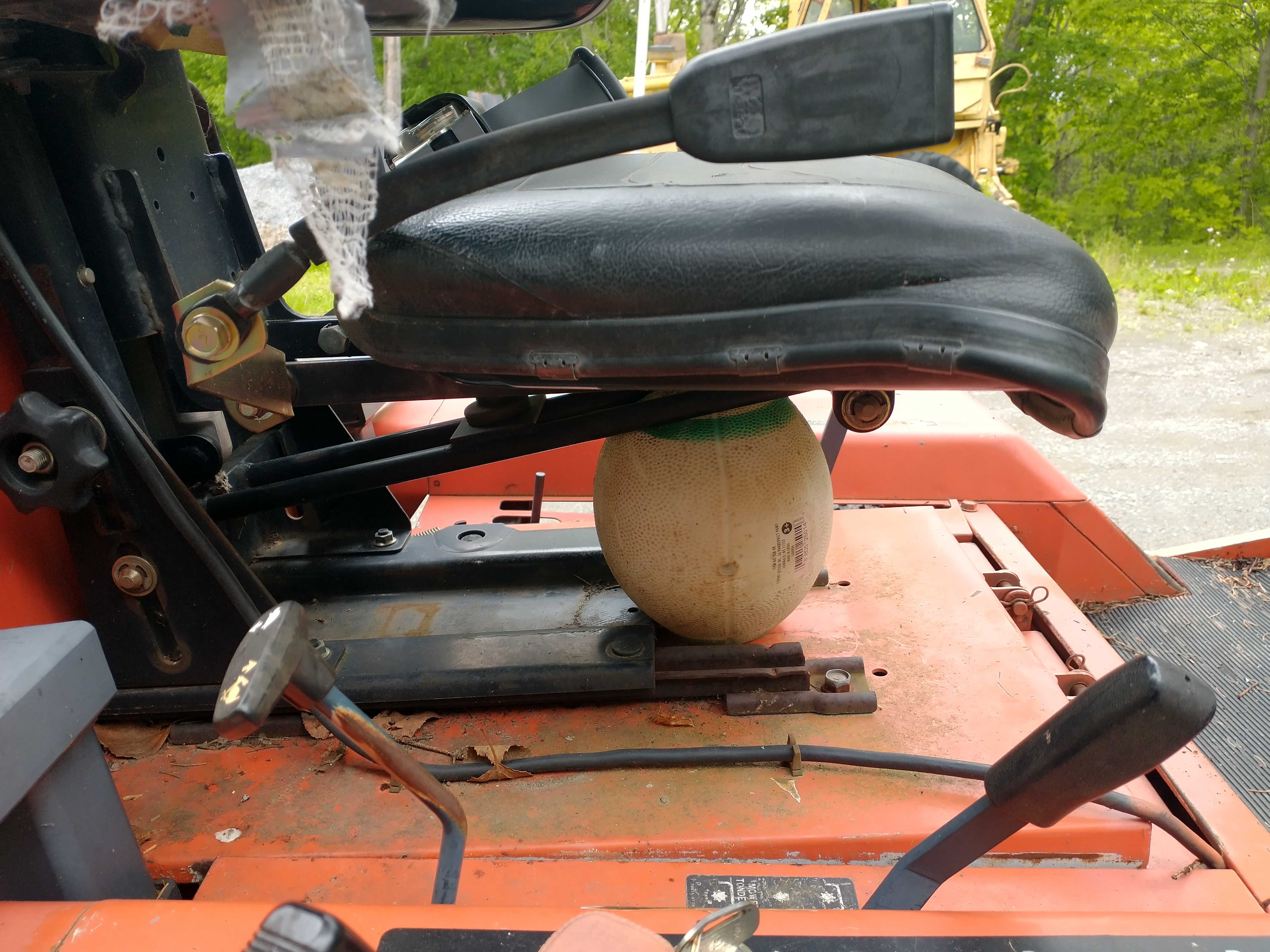

Well heck, I just did an upgrade to my old mower,
Well I actually accomplished a little bit of hopefully an improvement to my mowers seat.
The mechanical suspension on the Kubota F2000 was pretty well whipped for some odd reason, couldn't have been because it was 39 years old or that I tip the scales at close to 320 pounds.
I had squeezed a toy football in under the suspension for a couple of years and that actually helped, quite a bit when the air pressure was right.
I picked up a seat air spring a year ago and put it on the shelf and promptly forgot about it until I was wanting to mow.
Well today I dug up the fittings and a bit of plastic tube and installed it.
Inflated to 10 psi and backed the old suspension spring down to mid scale, wasn't bad took the pressure up to a bit over 11 psi, dang that is nice.
old .............................................................................new
