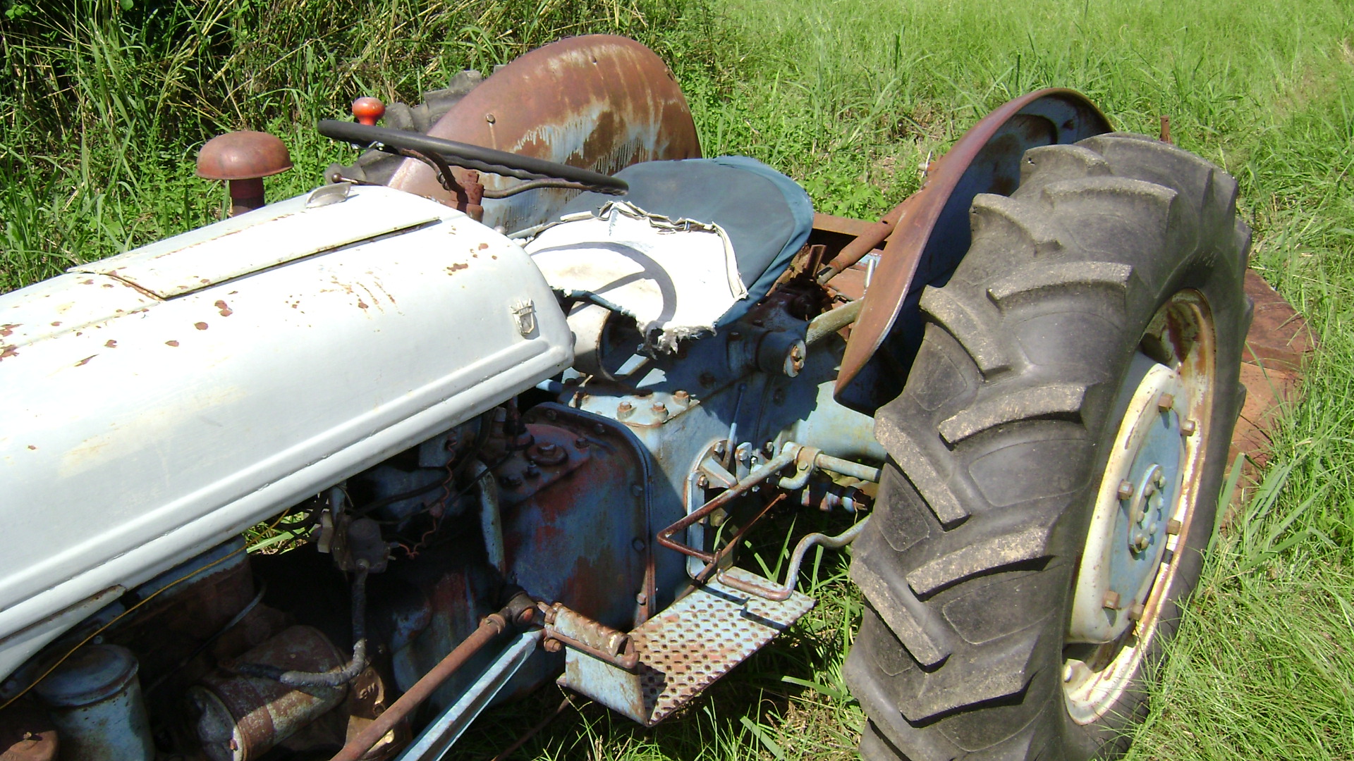

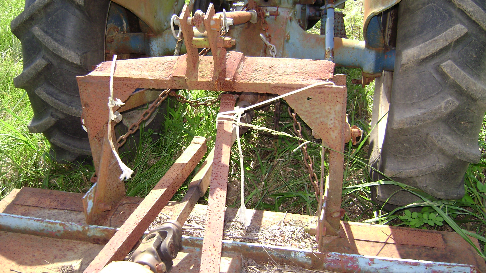

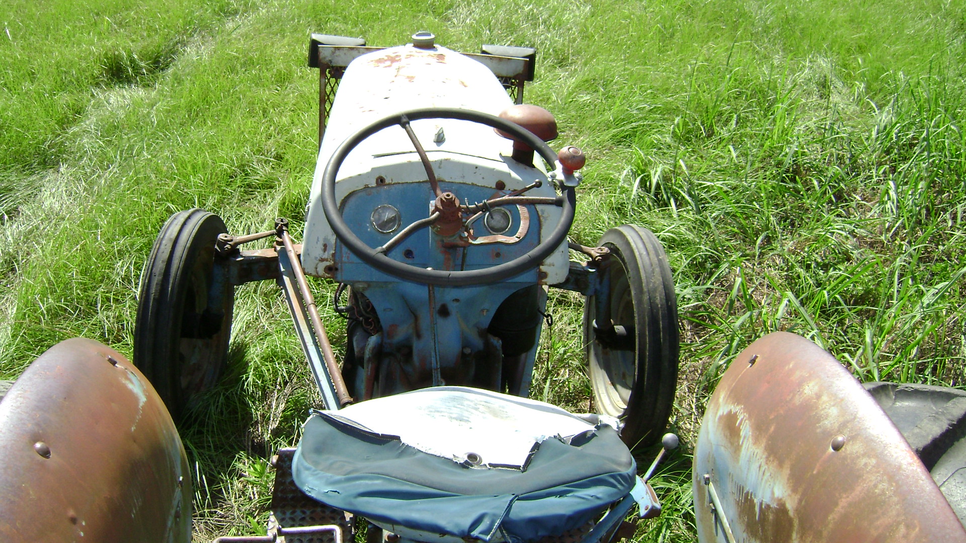

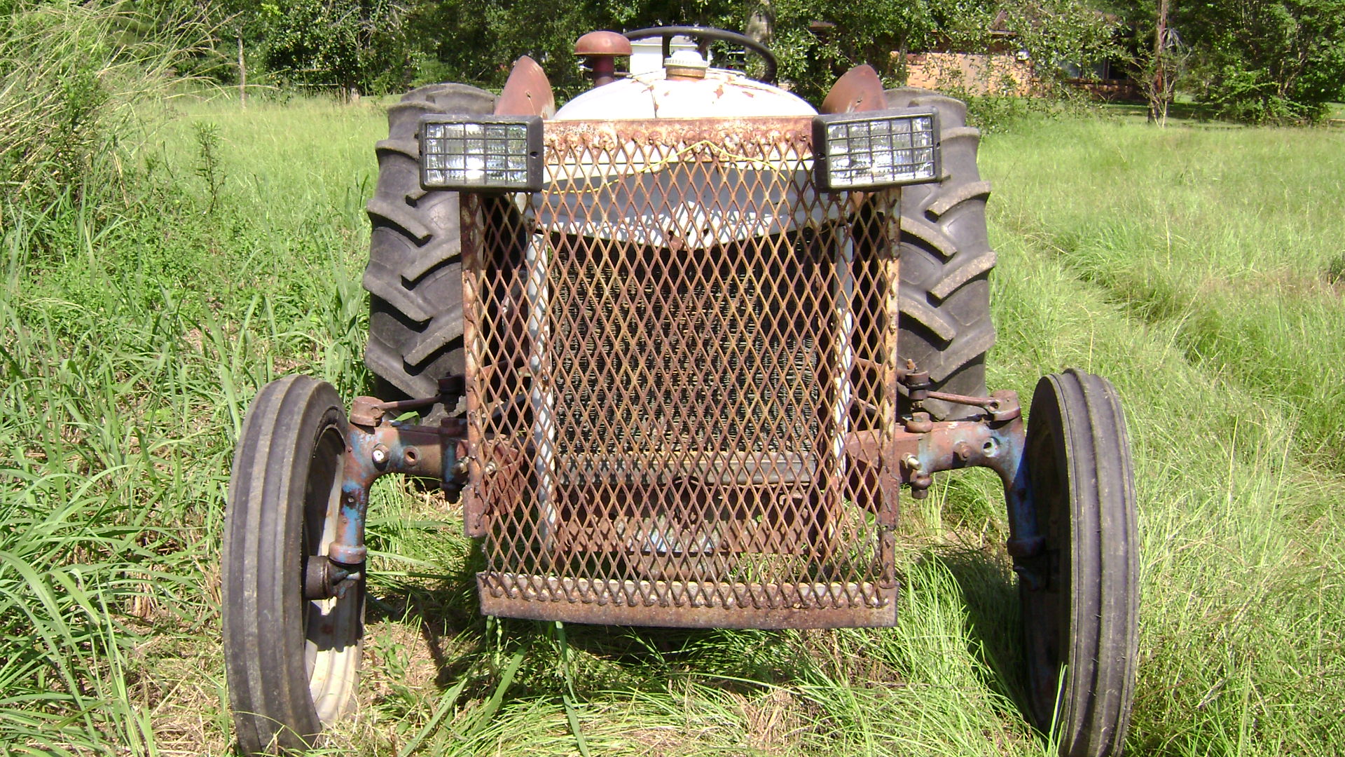

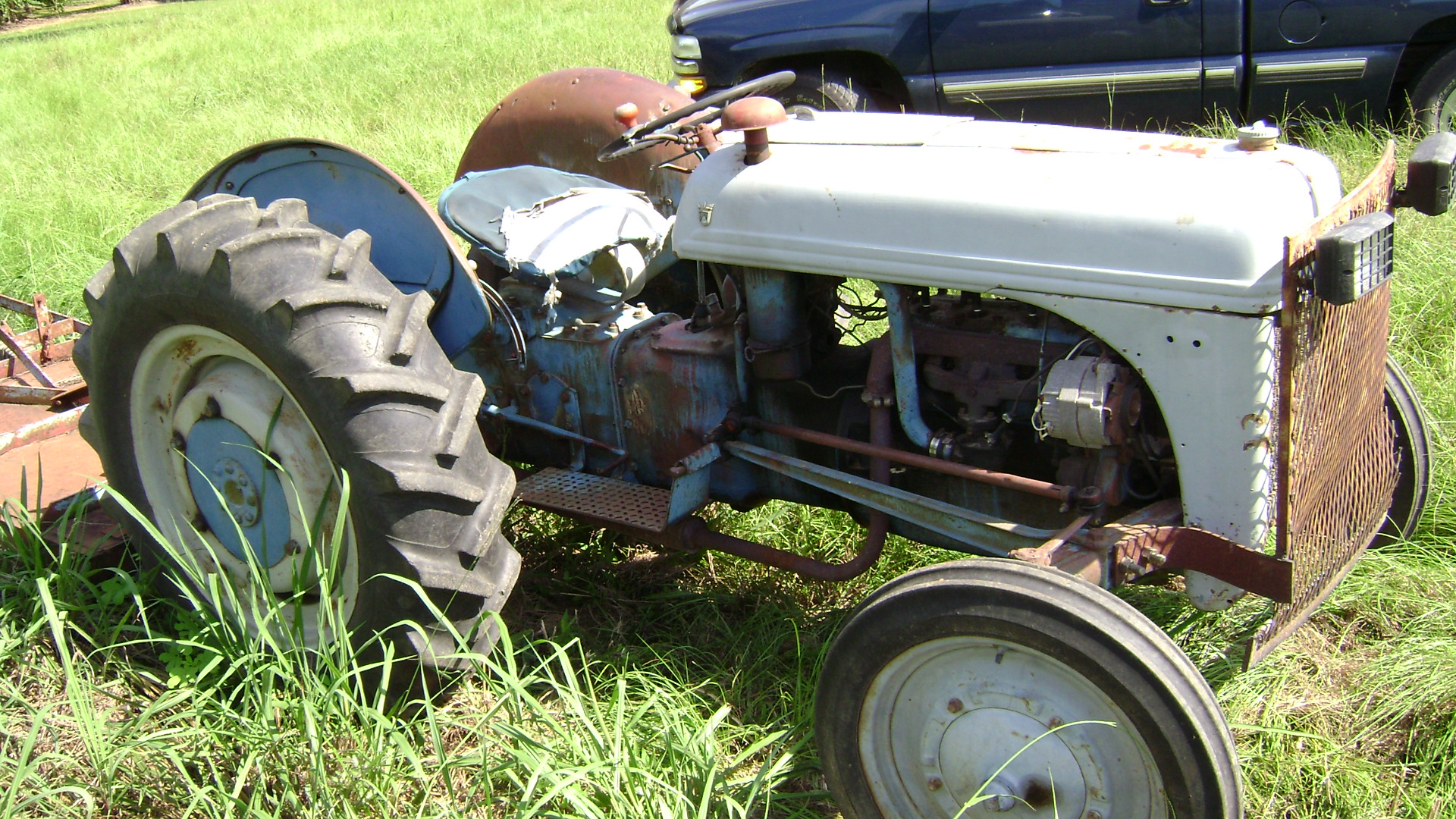

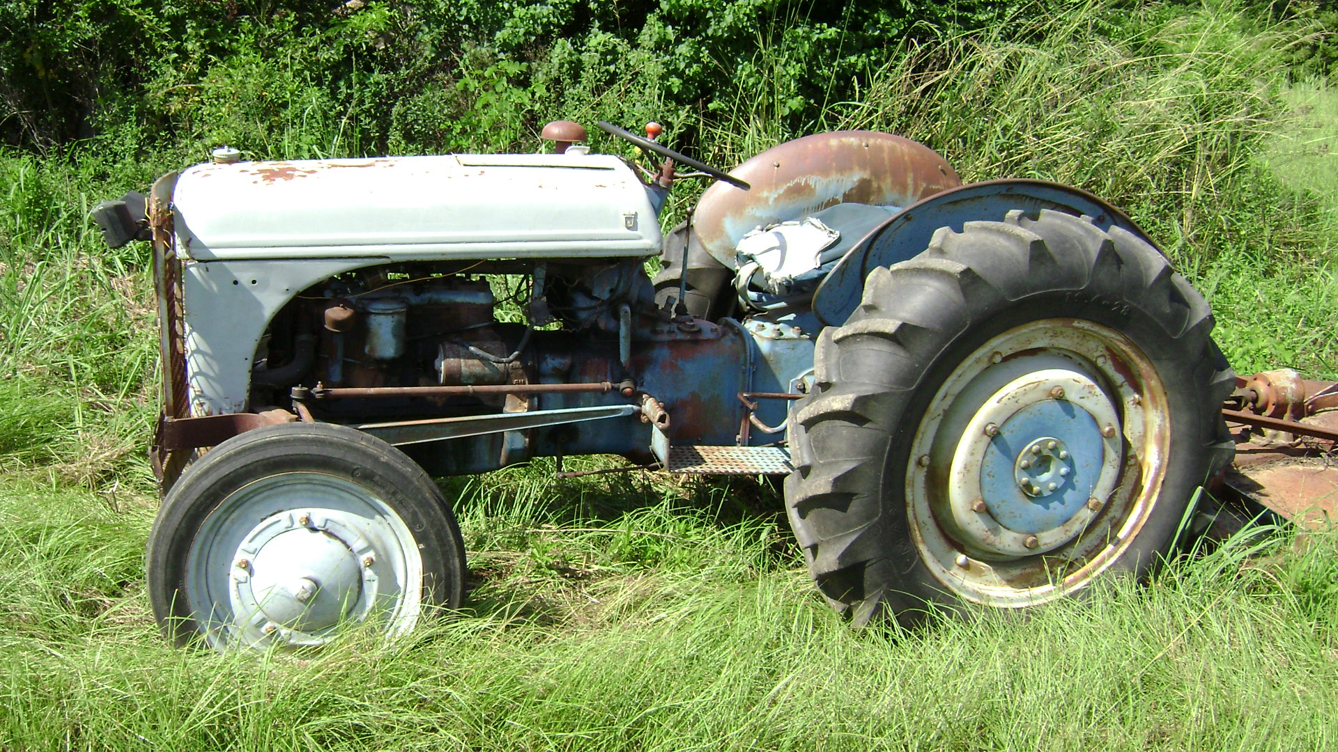

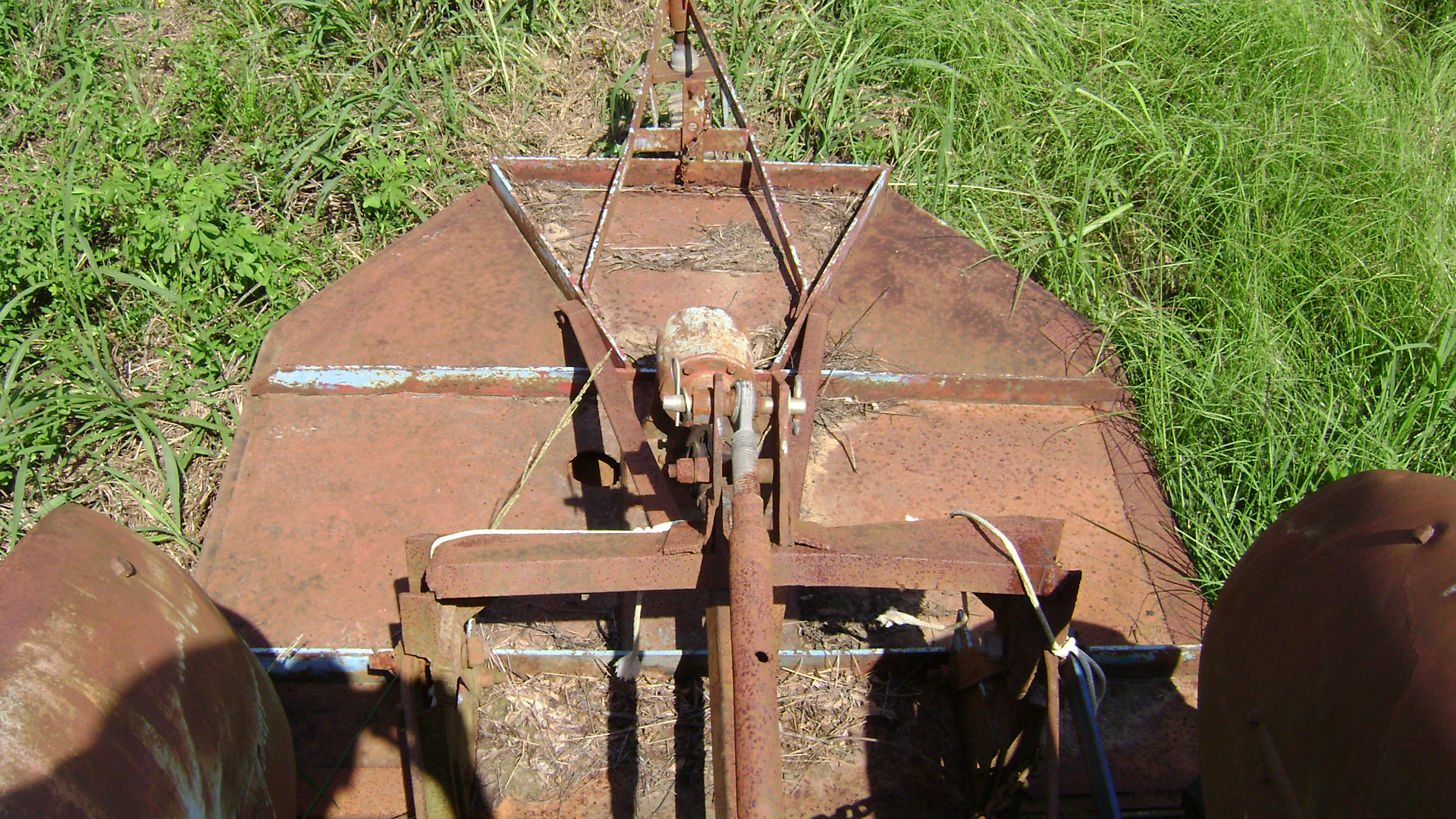

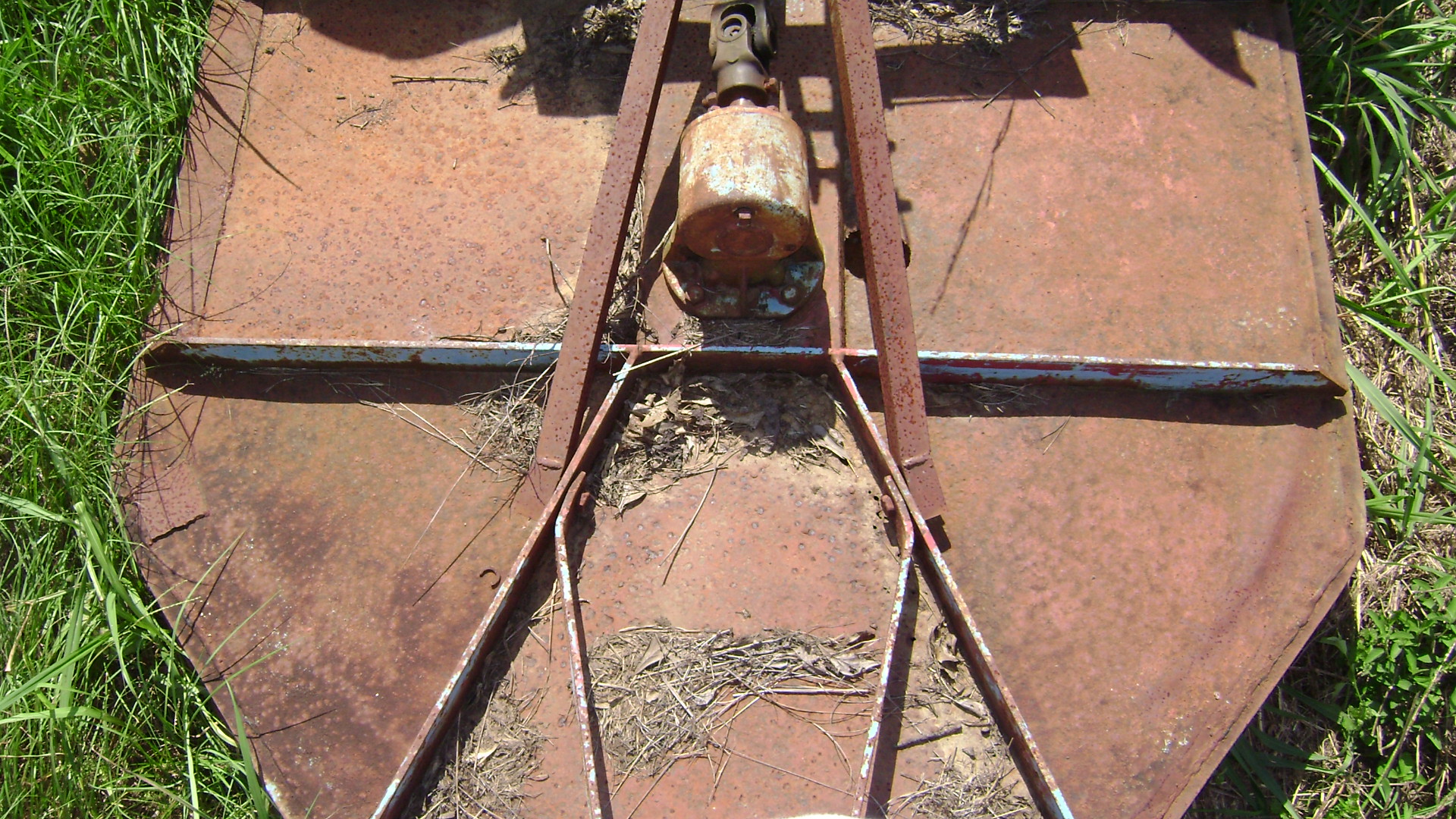

One of my coworkers brought some pics of his Dad's tractor that he'll be selling soon. They think it's a 9n. Can anyone verify that by looking at these pics? Also, any idea what brand the bush hog is? I realize that may be kind of difficult, with all the mods/repairs done to it.

Did you get a serial number off the tractor? Engine casting number? That would help ID it. Also, YTmag.com has ID info for 9n/2n/8n.
/ Is this a 9n? #3
Either a 2n, or a 9n. I don't think you can tell the difference without the SN.
Maybe soundguy will chime in here as he has one ,later, nat
/ Is this a 9n? #4
.....unless someone has swapped the steering wheel..... 9N had a 4-spoke wheel OR 3-spoke wheel with rubber-coated spokes. 2N had 3-spoke wheel with exposed metal spokes. (to reduce the volume of rubber used to coat the steering wheel during wartime production of the 2N [WW II])
It's a pre-1944 version at that. 1944 saw the radius rods change from "I-beam" to oval tube.
It's DEFINATELY NOT an 8N. Many differences.
So, from those "clues", 1942 to 1944 2N.
Serial # would positively confirm the year of production.

That PTO shaft looks pretty scary to me :eek:
