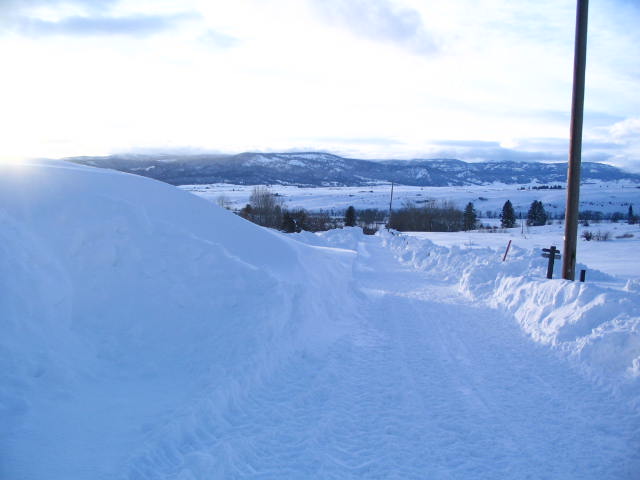

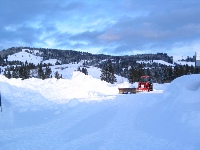

   / Is this going to work? #86
1 weeks worth.

   / Is this going to work? #88

   / Is this going to work? #89
Now that's what I might be inclined to call a dusting, albeit a little thick!:laughing::laughing:
That was last year and I know it wasn't much by many standards. I think that snow was a 10 incher. About three weeks after this we had another 14", 18" in the lower areas which is pretty big for around here.
