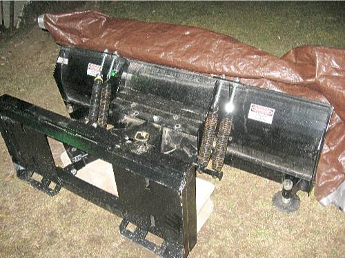

Nice tractor! Where did you get your plow/blade?
As to H I look at it as H is for home- as in going home on level ground with some or no load other then the tractor and any implements on at the time. M is for moving in most cases and is a safe gear to be in for most operations. L is for low and is good for things that M is too high for. Going up hill as I often do with my DK -35se/hst is somewhat of a pain. It would be nice to be able to shift on the fly when trying to gain momentum uphill but don't try it- the hst's are not made to syncromesh on hills or anywhere else. Pick a gear range and stick with it or come to a stop and shift to a different gear.
Through reading of the manual is worthwhile for some items and not so much for others.
I thought about the possibility of, as you say, shifting on the fly. Glad you brought that up because the curiosity sooner or later would have got the best of me :eek: Finding out that the M has been sufficient for the few things I have done so far. It'll be interesting to see if L will get me up to the power line when the trail drys out. Probably keep it in 4 WD as I did the CK 25 Manual/Gear. Will be adding chains to front shortly.
The plow/blade front or back? :confused: Back blade/plow was a TSC special I got 30 years ago. It still works some and serves as ballast. I enclosed a back photo of front blade (manual). Maybe somebody is familiar with Pinch Point D149 - NMC. Also yellow tag has 6 Ft snowplow Horning?? The dealer sells them. If this helps, he said it is the manual blade is the same prototype as hydraulic version but with the hydraulic piston/cylinders removed. Looks to be pretty sturdy. Hope this helps and thank you very much! KKioti
