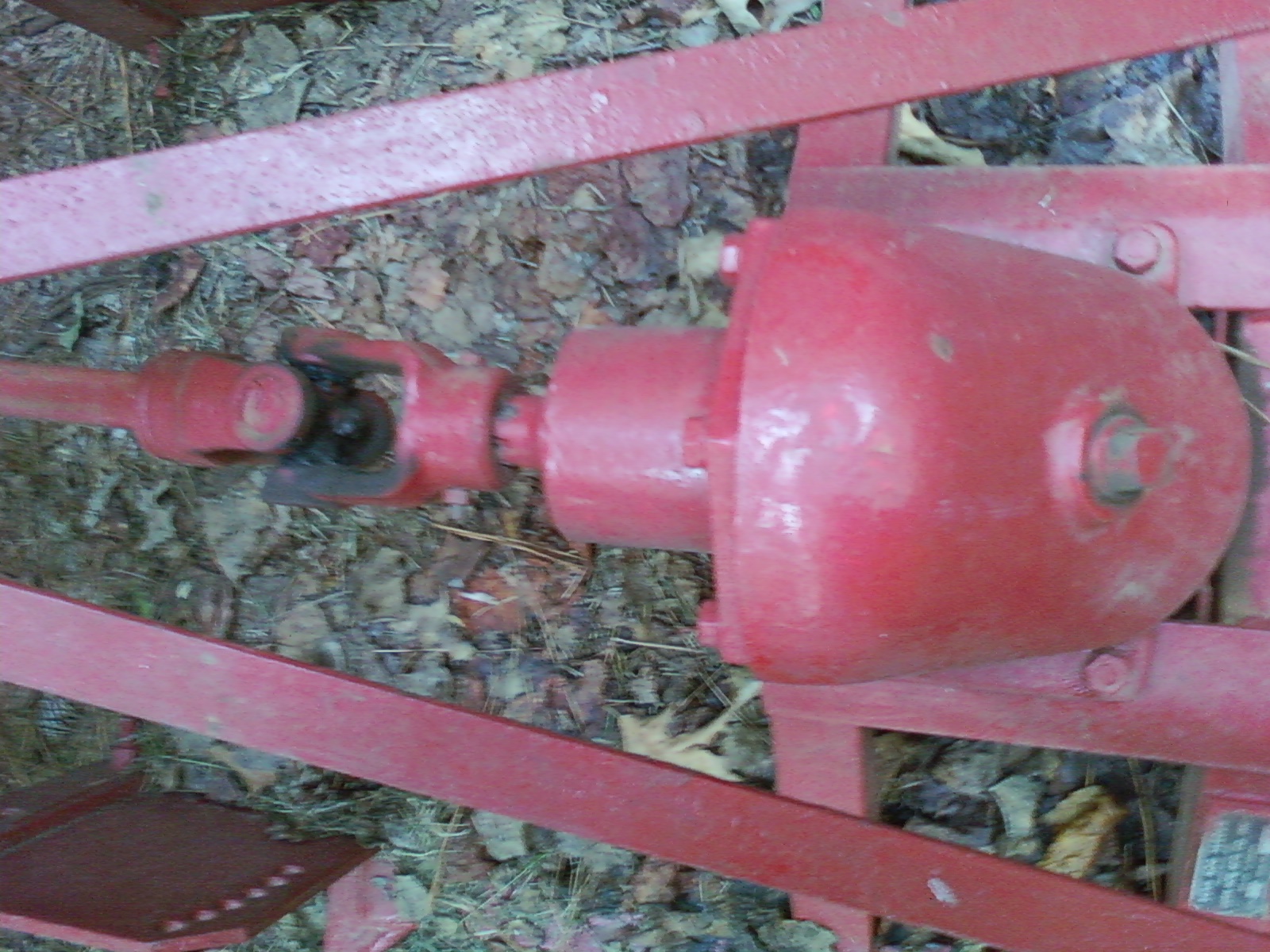

Not having a PTO shaft clutch is not be the best setup, however it's certainly not an automatic death sentence to tractor driveline components. This is the OEM driveline on my 47 yr old Bush Hog Stumpjumper, joints and all. My Dad had no respect for machinery and would grind anything a MF35 would push over. It may break something tomorrow, however it's got a pretty good record going so far.
