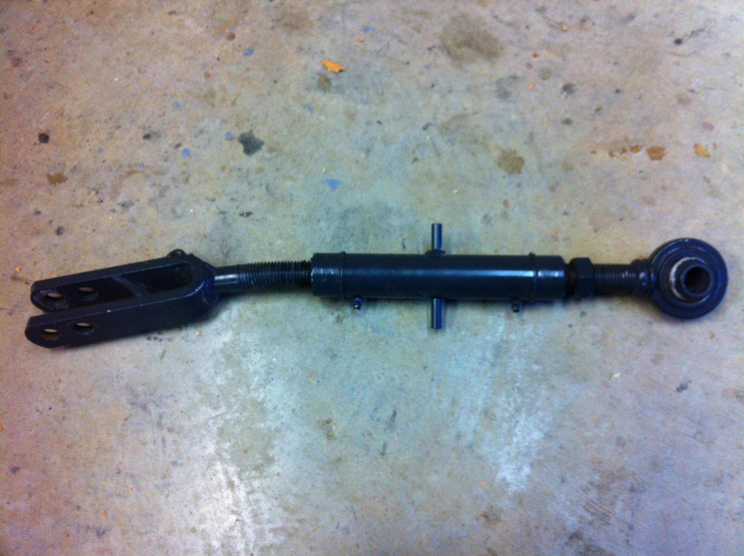

Kubota L3301. I was getting ready to till the garden spot this afternoon, noticed this when hooking up the tiller:
Thought I screwed something up royally, then came inside to check the interweb for a replacement to see how much cash I'd be out of and found this:
Adjustable Side Link
which looks pretty darn similar Is mine supposed to be bent or did I skrew it up?

its made that way

I think the thread should be straight, with the yoke welded on at an angle. Might be the photo, but the threaded portion looks bent. Will it screw in all the way?
Bruce
/ Is this side link bent on purpose? #4
Do you need to screw it in all the way? If not, no problem.
But why thread it and bend it?

X2
Threads should be straight. They look bent. Try to thread it in.

Yes I managed to bend it somehow...I'll see if I can get someone to straighten or ante up for a new one. Thanks
/ Is this side link bent on purpose? #7
No need to straighten unless you have that much adjustment. And it is very hard to straighten threads and get it to thread freely again.
And if you need adjustment, while more of a PITA, you can always pop the top off the pin and thread in/out just the top.

Thanks - on my 8N someone tack welded the thing so there is no adjustment. What did I likely do that caused it to bend like this? Did I have it too tight? I don't even recall adjusting it after getting the tractor.
/ Is this side link bent on purpose? #9
Hard to tell which direction it is bent. But usually the cause is from pushing something in reverse, or side load that exceeded the swing allowed by the upper ball (and cause anti sway chains or turnbuckles were not tight to prevent that).
Have you used a rear blade or box blade and did some heavy pushing in reverse?

Don't have a box blade but I did have a heavy disc set on there recently. I'll pay more attention now!
/ Is this side link bent on purpose? #11
did you try to turn without raising? or not have the stabilizers tight? that could have caused it. IF the stabilizers were tight, I dont know then.

Must have not had the stabilizers tight. I remember now when I first got the tractor and I did not have anything attached one was flopping against the tires. I thought I tightened it up enough after putting the disc on but must not have. Just didn't realize they had so much play...the old 8N's wouldn't reach that far.
/ Is this side link bent on purpose? #13
If it works use it. Don't bother trying to straighten it. If it breaks it could be welded depending on the break.
Might get lucky and find it straight after using it??
Don't tighten the stabilizers too much. Leave a little slop. That bend probably comes fron compression which your disk would do??

If you find it's binding, or results in your hitch running wonky, I'd try staightening the rod section. Block up the yoke with a piece of steel that just fit between the "ears" & clamp it up good in a heavy vise, squeezing the block between the ears so the ears don't deform and giving you a nice, square shape to grip. Heat the rod section, where you want the rod straightened, with oxy-acetylene to dull red color in a shaded work area. Apply force to the free end and play the heat where you want the rod to straighten, then let it air cool. Should be nearly as good as new.
