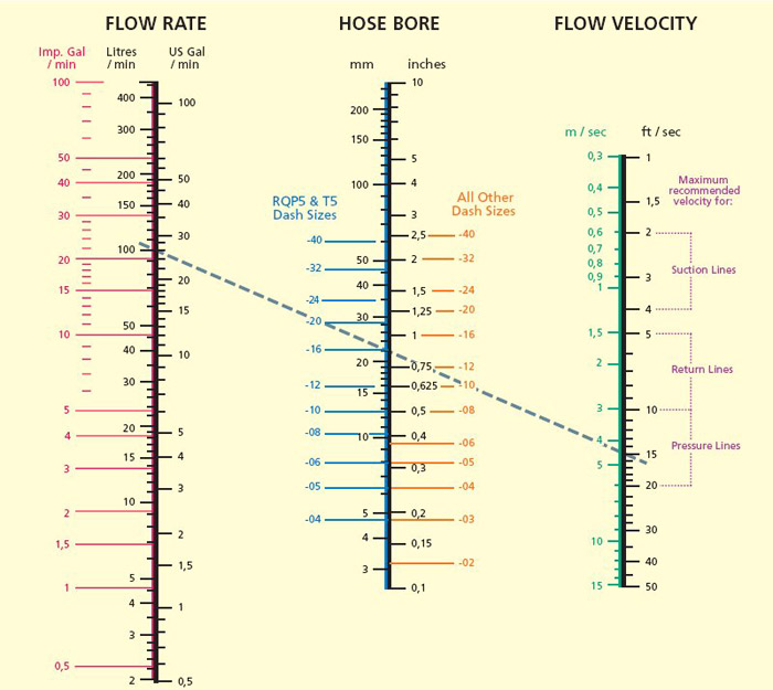

This, IMO, your hoses are too small.
Per: Hydraulic Hose Size Selection Chart - Hydraulic Pipe Sizing
For 14GPM with 1/2" ID hoses, that is a flow of ~25 feet per second of flow (recommended FPS for pressure lines is 10-20FPS, 5-10FPS for return lines). That will be worse with the fittings to connect the crossover relief.
I might see about replacing the crossover relief with a 3/4" one.
The backpressure sounds a little high, IIRC, our L3830 has about 150PSI of back pressure at full throttle in the summer (closer to 300 or 500PSI in the winter IIRC) until it warms up.

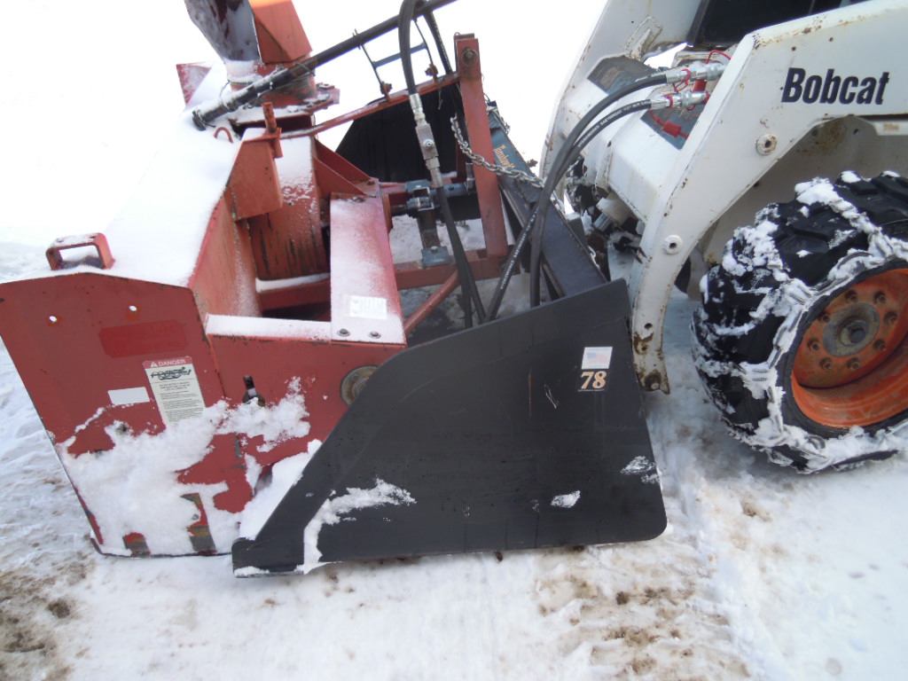

1. Why do you have 18' of hose on a skid steer mounted snowblower?
2. Can you post a picture of the motor/crossover plumbing?

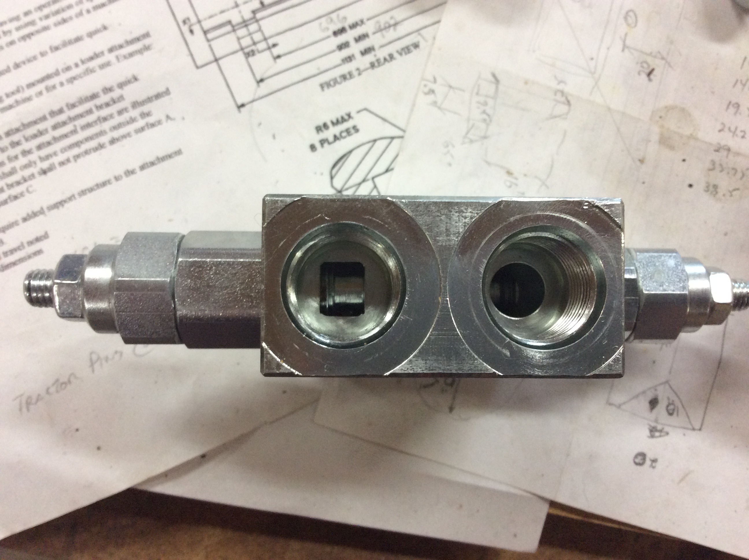

The reason the lines are so long is that I just guessed at the lengths I would need to try out the SS conversion on a temporary basis and I didn't want to be too short. As you can see from the pic the lines are definitely not short. The lines from the SS to the cross over are 6' long and the ones from the cross over to the motor are 3' long. At some point I will get shorter lines. Here is a couple of pics of the setup. I have other pics and if you want to see something specific, let me know.

   / Is this some kind of pressure relief valve? #17
Did you have the lines made up, or buy them premade? If you had them made up, I might take them back and have them change the ends to the sae 8 oring ends that your valve needs.
If you take the hoses off of the valve, do you see any restrictions in the valve itself?
Aaron Z

They were premade but the place I got them from will alter them if they were purchased there. That is a GREAT idea and thanks for that. The valve is very restricted as you can see from the pic. I want to find a less restrictive one.
Based on that picture, I would definitely see if I could find a three-quarter inch valve. Have you by chance talked to Surplus Center to see what they would charge to ship it to Canada via USPS?
