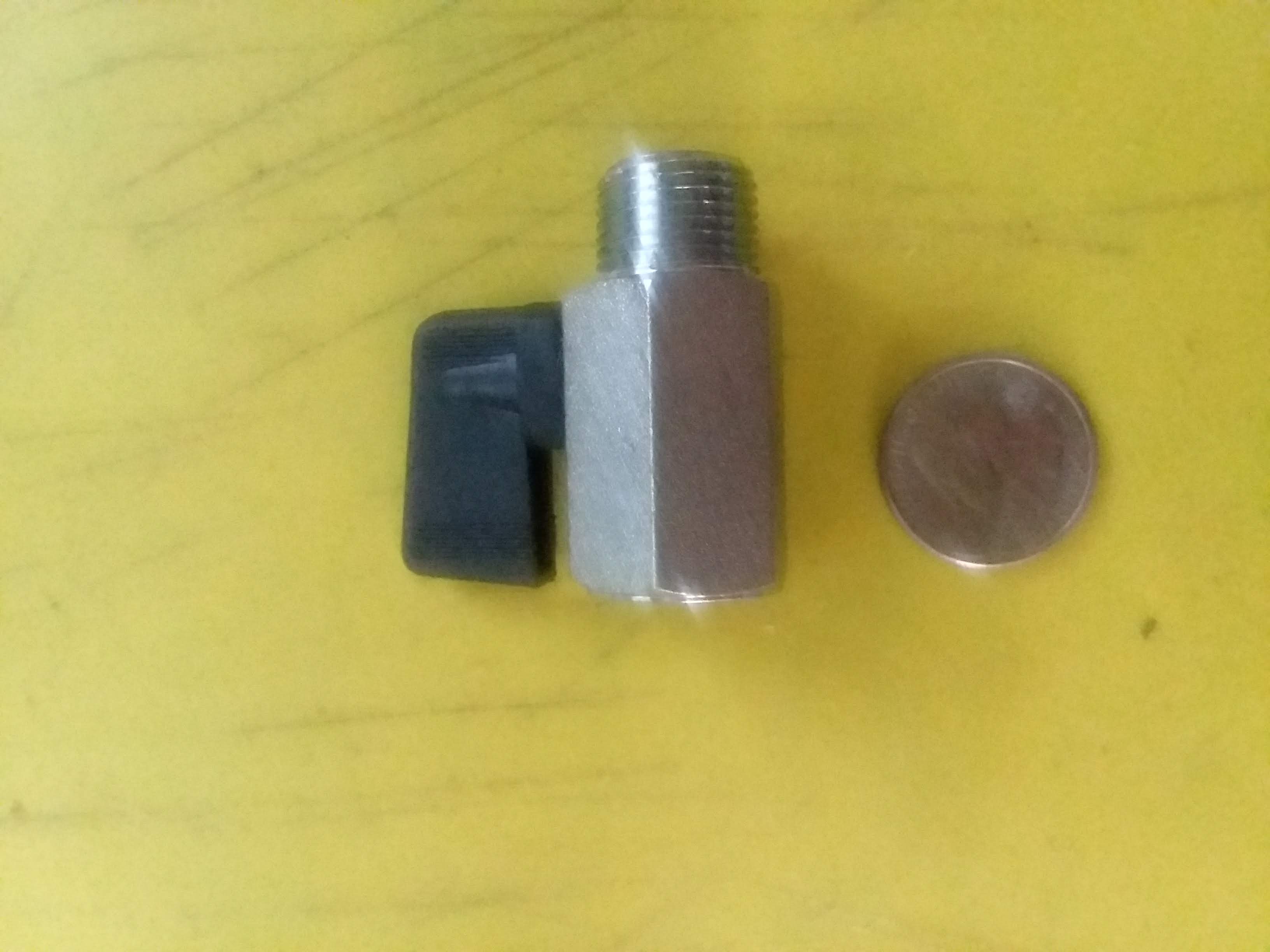

The attached circuit shows a possibly load holding option that would also allow the use of the "float" feature. It does require electrical signal to operate. Companies like Bucher, Hydro-Force, Delta Power, Rexroth - Oil Controls, etc. all make these Normally Closed solenoid operated valves. Just throwing out another possible option to help keep you confused :D
I think this is a nice solution. Found one on hydraulicstore.com for $61, plus some hoses and fittings.

Yes, good catch. I need the S2B, or something equivalent.

Was it one of the S2B valves? If yes that would be the correct valve. Would suggest the PB-S2B model for your flow rate.
Why wouldn't a toggle operated 2 way valve work for this? I don't need to move the cylinder up or down once I get it set, so I shut the toggle valve off. If I want to move the cylinder, or allow the float to work, I open the toggle valve. The only thing I really need from the toggle valve is positive shutoff with no leakage.

I don't like adding anything with wires, they just end up getting torn off by low branches.

So I went to the local hydraulics place and they suggested a miniature ball valve, which worked great. It's good for 2500psi, which is fine for my system. Only cost $4.50, cheapest hydraulic part I've ever bought.
