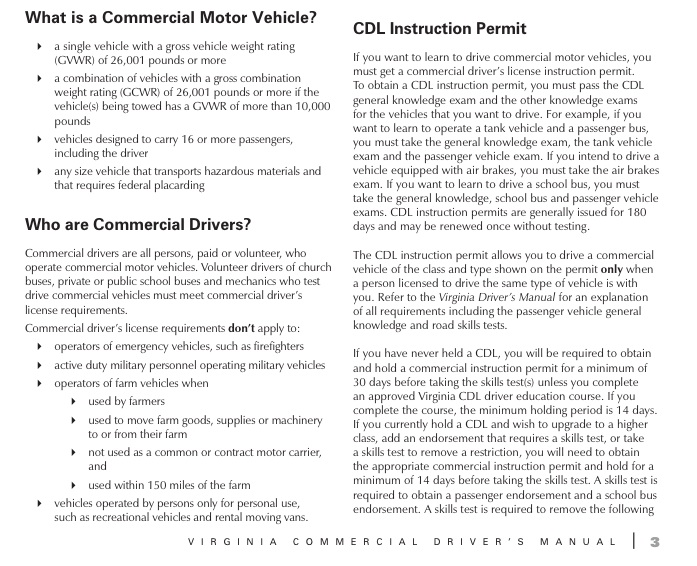

I hold a CDL, I think I would have to disagree initially.
Here is Ohio's handybook, page 19 has a flow-chart, which based on that chart a CDL would not be required, assuming the GCWR is under 26001. Despite the fact that the towed vehicle is 10k+.
http://statepatrol.ohio.gov/doc/truckbook.pdf
Sorry but i'm well aware of the cdl rules the ticket was written for not having a medical card, no cdl is required in this case.Iam going to do some research on it Friday when I have time.

Well a friend call me and said you not gonna believe what happen to me today.I was pulled over by the state police and he gave me a ticket that carries a fine up to 10,000 dollars. He was pulling a trailer with equipment on a trailer dull wheel pick up and they wrote him a ticket for not having a medical card because his total weight was over 10,001 lb. I never heard of this have you?

Virginia is the same as most states total gvw has to be over 26,000 lb and the trailer over 10,000lb but all is exempt for personal use.
