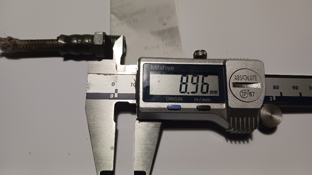

Not sure if it's possible to know just from a pic. It's from a front axle grease hose. Made in UK tractor but they did use NPT for some things.
Thanks.

Without any dimensions given, it's a bit hard but since it's a grease line, I would say it's 1/8" BSPT.
/ Is this thread NPT or BSP? #3
Count the threads per inch on the fitting. BSPP and BSPT Fittings have one additional thread per inch than NPT Fittings. Finer threads mean BSPP or BSPT.
Hope this helps.

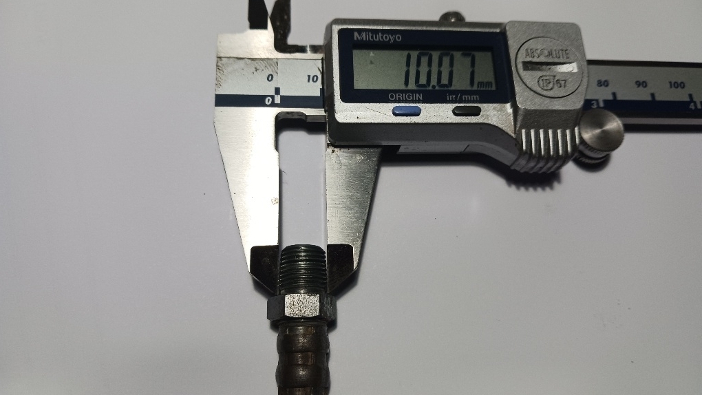

There is a definite taper..... diameter goes from just under 10mm to just over.
That matches the 1/8" BSPT. It's about 10.1 mm at the largest diameter.
Sorry, just realized the caliper wasn't zeroed so was out by .2mm. Actual thickest diameter should have been 10.33mm....if that makes a difference?
/ Is this thread NPT or BSP? #7
No, won't affect much. A 1/8" BPST thread machined to the correct specs will measure about 10.1 mm at the 4th thread, but there is always some variation.

You were right.
Don't know why I didn't think of it before..... just remembered I have a grease cartridge hose which I know to be BSP (that supplier has no NPT hoses on their website) and it fits perfectly. Many thanks.

Sounds like you got it figured out, if you're sure the grease gun is BSP.
A thread guage would confirm, as BSP and BSPT are both 28 TPI, whereas NPT is 27 TPI, in the 1/8" sizes. Both have similar ~10mm diameter, depending on tolerance and where you measure on the taper.
