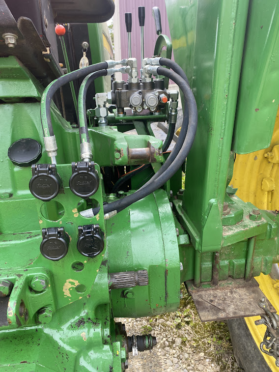

I get all mine made at a custom shop. They recently took over the local Omni store and are striving hard to make sure that ANYBODY that comes in leaves with a new hose. Here is a recent build I did and you won't find these hoses on any store shelf and quite possibly could not have had them made at NAPA or even JD due to the fittings required. Other possibility is they could have made them but would require special order because they don't use enough of them. Combination of JIC, Metric, Adapters, several different size of hoses and lengths. I walked in with an idea and walked out with hoses and no it wasn't "cheap" but I got what I needed. Talking with the owner they have over $100,000 invested and going to invest more to make sure they can take care of everybody. Takes a long time to recoup the investment at $150 hose.
