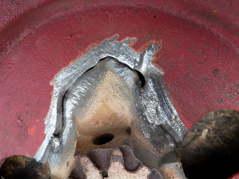

If welding doesn't work, clean up the break on the pulley, leaving a flange inside as large as possible. Bolt a circular steel plate inside the old pulley, with a new hub to fit the shaft.

Oops. In my previous post to this thread (#7) I forgot to include peening. So the procedure should read:
Pre heat to 300-400F.
Use a skip weld. Start at one end of the crack and make a short weld (1" or so).
Allow the piece to cool to 100F or so. I use an inexpensive IR thermometer from Harbor Freight to check the temperature during cool down.
Peen the weld during cool down. I use an air chisel with a rounded point for this.
Repeat at the other end of the crack.
Continue alternating and connecting the short welds until the crack is filled.
Good luck
   / Is this worth trying to weld ? #25
Little late to the tread as it seems the Op took the route of buying a new pulley, which is what I would have done. Anyways, I have had pretty good results welding casted pieces using mig and regular wire and gas mix. Preheat and Post heat is key. I use a propane weed burner on large parts and the top of my wood stove on smaller pieces. I peen using my needle scaler. I like the part brushed really clean and line up the pieces on a metal table where I can run the weed burner over it. On something like that pully, I would preheat to around 600*F using a infared thermometer to check temps with. Then I would use my mig to spot weld several areas around the break just to keep it lined up. Each spot weld would be post heated as soon as weld is complete and then peened with the needle scaler before going to the next spot weld. Once everything is spot welded and no crackes. i would start making small welds, no more than about a 1/2in on such a small piece, post heat and peen, continueing around the piece until the entire part has been welded. Even after the weld is complete, I would apply post heat and keep checking the temp making sure the entire part was the same temp and then cover with something to let the piece cool down very slowly. I like doing these type of repairs in the winter time because I can just lay the part on top of the stove and let cool as the stove fire dies out overnite. If you get in a hurry and try to weld everything up in on pass, it most likely is going to crack. Go slow and skip around a bunch and you can get it to work without cracking. Also, I think brazing a pulley like this one would be easier and much faster than trying to weld, and might possibly be even stronger.

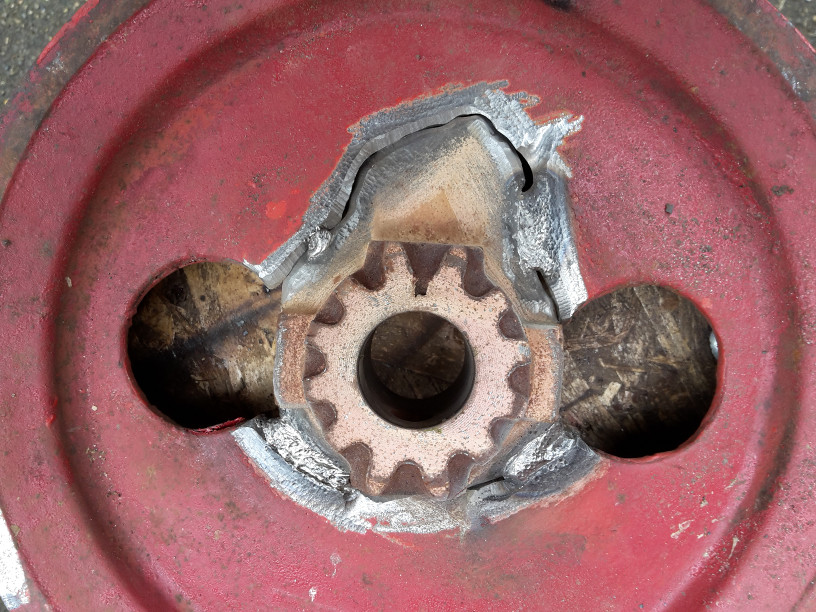

Update:
It's been a while but here is an update, I called the local supplier for a quote on a new pully, it came down to about $500 ! ****.

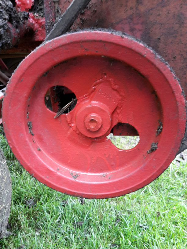

So after that I drove to the local welding supplier and got me some welding rods for cast. Now the rest of the storey, due too not enough time it was laying around untill 2 weeks ago. I started cleaning the old pully and gave it a go. This was the first time I ever welded some cast and I was a little bit nervous, knowing that if I messed up, I would have to order a new one. First attemp let met down with a new small crack, grinded out again, welded with a little more pitch, then tried to hammer it as good as I could, next run, hammer, next run, hammer, etc. .. after I had finished I quickly ran in the house and put it on the stove so the pully could heat up nicely on top of the stove (Misses not too happy). after 2 hours I took it off and put next too the stove to cool down again. It worked !! Then I also needed another bushing for the bigger gear wheel and a bolt form the feeder chain roller broke down so I had to tap new thread in there but that also worked out fine.
I took it too the test this week and it did a very good job !, So far it did not break. Maybe it will again in the future but we will see when that happens how bad it is.
So thank you guys for all the tips.
