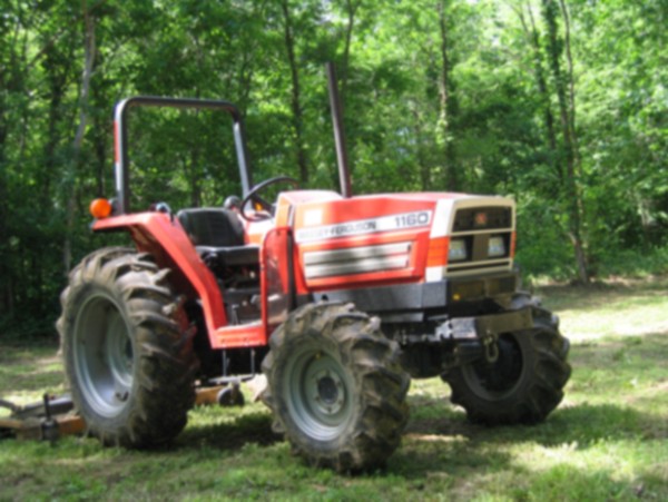

I used to own a Massey 1160 that had a 41 horsepower 4 cylinder direct injection Isuzu diesel. The tractor was made by Iseki, as I recall the shop manual was for an 1160 and an 1165, according to the maunal the 1165 had an iseki motor.
That was one fine tractor, I thought the gear transmission would be more work. Now I have a Kubota BX1500 with HST. I do like the HST, although the Kubota is considerably smaller.
I think the gear transmission suits the larger tractors better.
In my opinion Isuzu make one fine diesel motor, I would not hesitate to own another Isuzu. I believe the 1190 is turbo charged, I think somewhere I read where it's a good idea to let turbo charged diesels idle for 5 to 10 minutes before shutting down, especially on hot days where the engine temperature could be high.
I attached a picture of my old steed.
Hope this helps.
Tom
